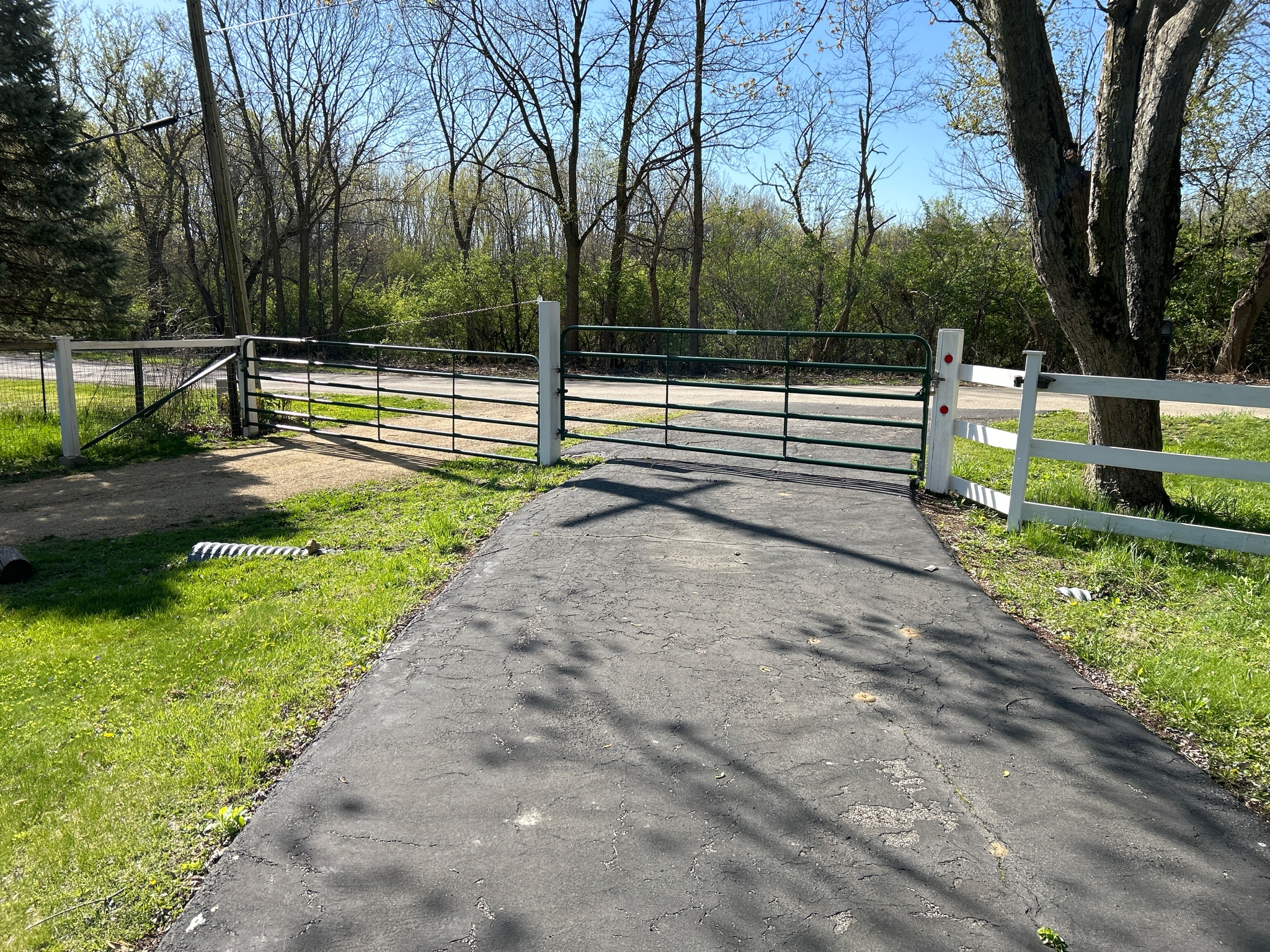

I set a hollow steel rectangular tube with 1/4” thick steel into the earth and filled it in with concrete to support a 18’ gate on one side and a 10’ gate on the other 22 years ago. It hasn’t rotted.
