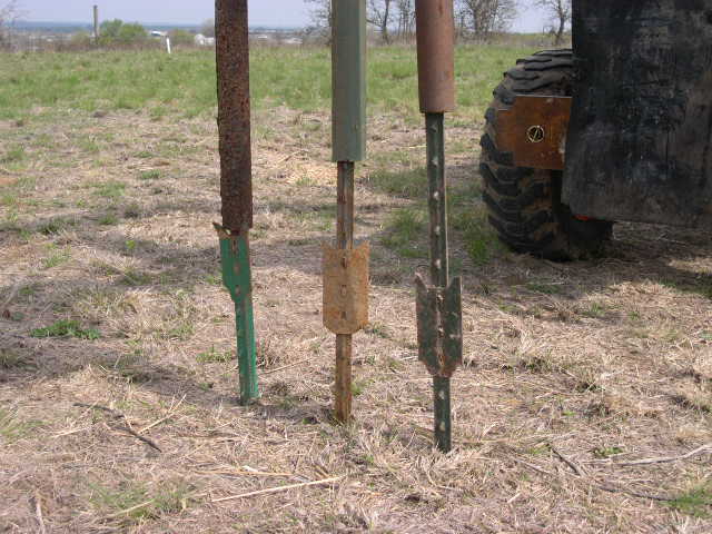

MikePA's description of using FEL to drive T posts is perfect. That's the way I do it, and precautions I take. All I can add is that I made a T post cover/sheath of proper length such that when post is driven sufficiently the cover is at ground level. Different length t posts require different sheaths.
