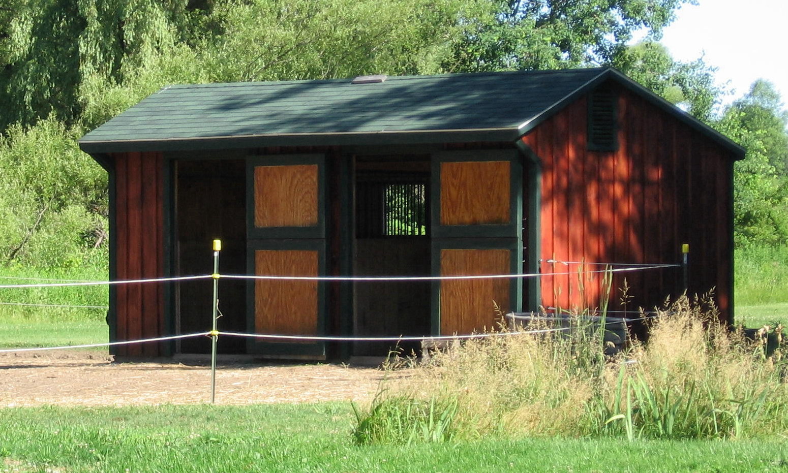

After gittin' zapped a couple of times, my horses won't touch the poly rope, but my mouthy appaloosa sure likes to pop the yellow caps off when she's bored. My wife is very fussy about her horses and is always checking the posts to be sure they are covered.
In addition to using the bucket to drive posts, I have become fairly adept at using the bucket lip to pop/pry/pull post out by exerting just enough forward pressure on one of the post lugs closest to the ground while simultaneously curling the bucket lip slowly upward.
A picture taken today of horses in snow attached along with another taken this summer showing simple braided wire fencing used in our dry lot.

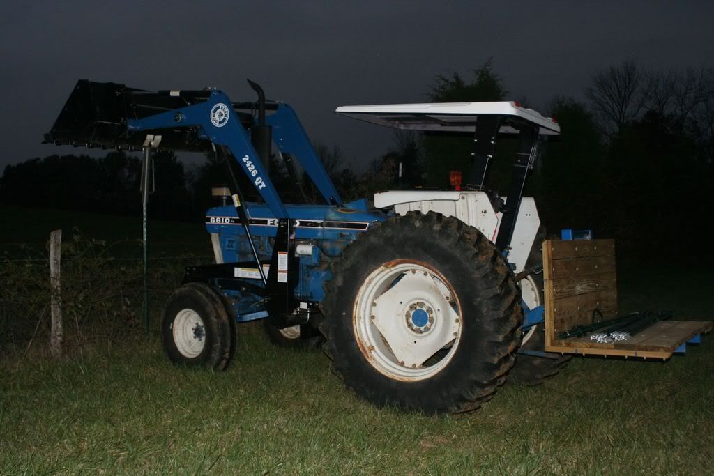

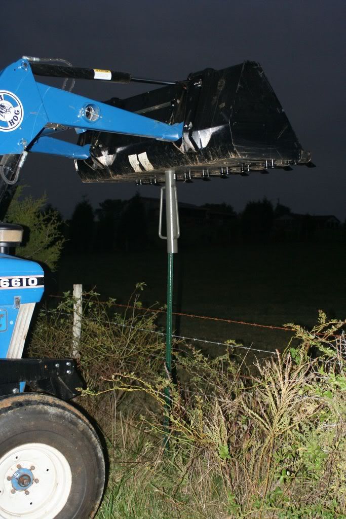

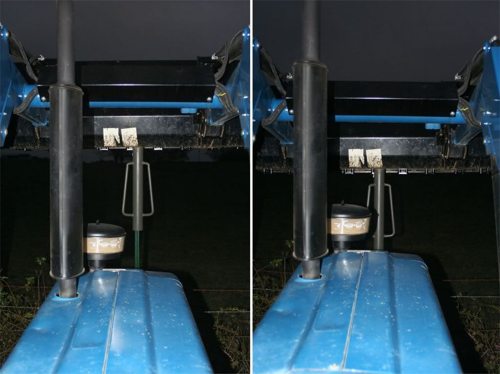

Texasjohn gave me this idea a while back. I don't usually have help when I'm working on the farm, so this was a one man job. Probably not as perfect as you'd like, but I'm keeping Texas Longhorns in, not horses in this part. I just had to get it done.
I sighted the depth by the driver and the hood as shown in that last shot. I would start them by hand, and I used 8' T-posts, so that was a bit of a stretch for a regular height feller. Once I got them started I used a real light push by the FEL letting off the pressure every few inches or so to keep the post true, and they drove pretty good, well, pretty good like I said for a one man show doing this in the dark to keep the horns where they were supposed to be. :eek: There was already a fence, but it wasn't tall enough and no electricity.
