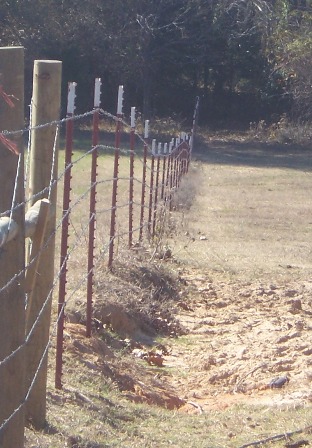

6' may be an overkill but what the heck its your fence do it your way!
Most everybody has said it set the corners, pull the line and mark the post. T-Post in my part of the country come with the plate at the bottom, I use the FEL to push them to the top of that plate and thats done. I also have the ground person set the top of the post in the pin area of the FEL where the bucket or the quick atach is to keep the post from slipping or sliding out, always have them get out of the way! Worst case somtimes they bend if you hit a rock or the ground is extremly hard!
Somtimes a few get a little out of Plumb ... this fence is going on 5 yrs.
