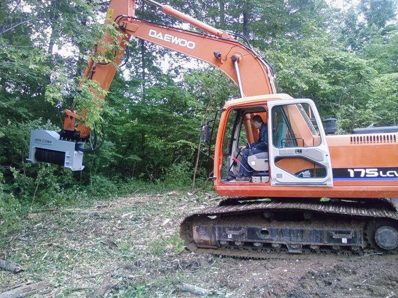

CRANK IT UP
Finally....
Gilles checking the pressure and flow.
Loaded up and heading to the woods.
I ran the machine for a while and then we tightened a few leaking fittings. Gilles jumped in and gave her a try to see how it was running. The only problem, I'm John Deere stick and he's CAT...
Gilles was full of useful information and explained everything, we tried the settings a few different ways and settled on an RPM of 2500+/-. We rerouted a few hoses and I took a bath in hydraulic oil when changing two hoses that were put in wrong.

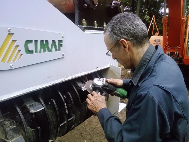

Sharpening demo..I forot to bring the gas powered sharpener so we were using my old set up.
I only ran the machine for about 2 hours and am eager to see what I can do in a full day. It rips through 8 inch trees like nothing...I cut at least one 12 inch tree and it performed good, better than expected. I really think this is the right combination for the terrain I work in. Fast and efficient.
End of the day. One happy customer and the all knowing Mr Gilles.
