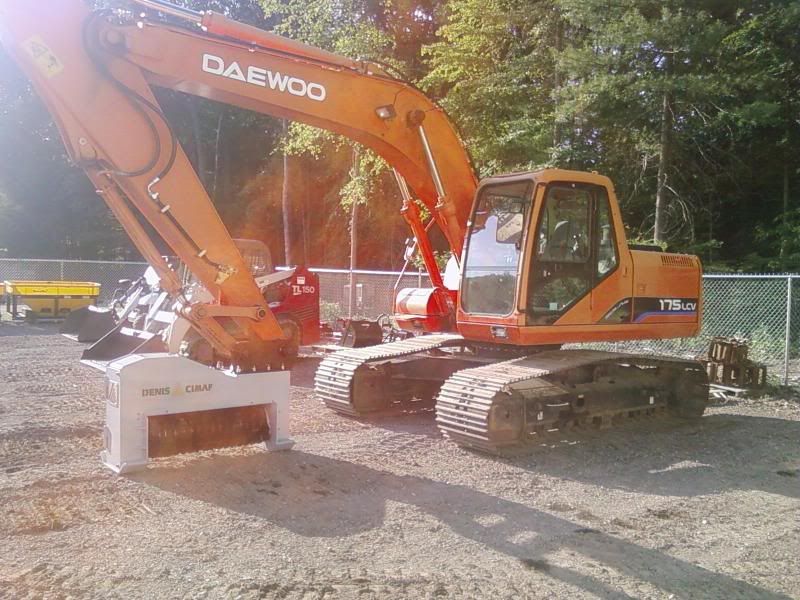

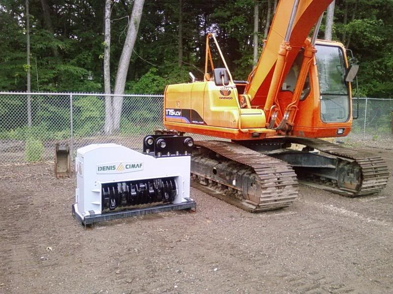

Got some of the piping done today, still need to mount the priority valve and rework some of the hoses. I also mounted the mower.
A few more photos.
Cool, I'll be working in Ware about that time so I doesn't look too far.
Matt

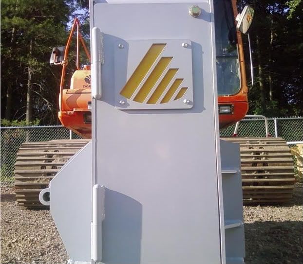

Here's a few shot of the head.
First impressions...quality and attention to detail; excellent welds, heavy gauge steel, nice finish (especially the logo), even the parts manual is in a binder with covered pages. More later.
48 inches of whoop (butt)
