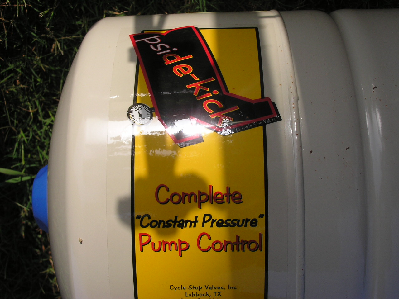

Use one of these kits: Constant Pressure Kits – Cycle Stop Valves, Inc
I installed this one in June of 2015, love it. :thumbsup:
Screenshot from the Website:
Picture of my tank:

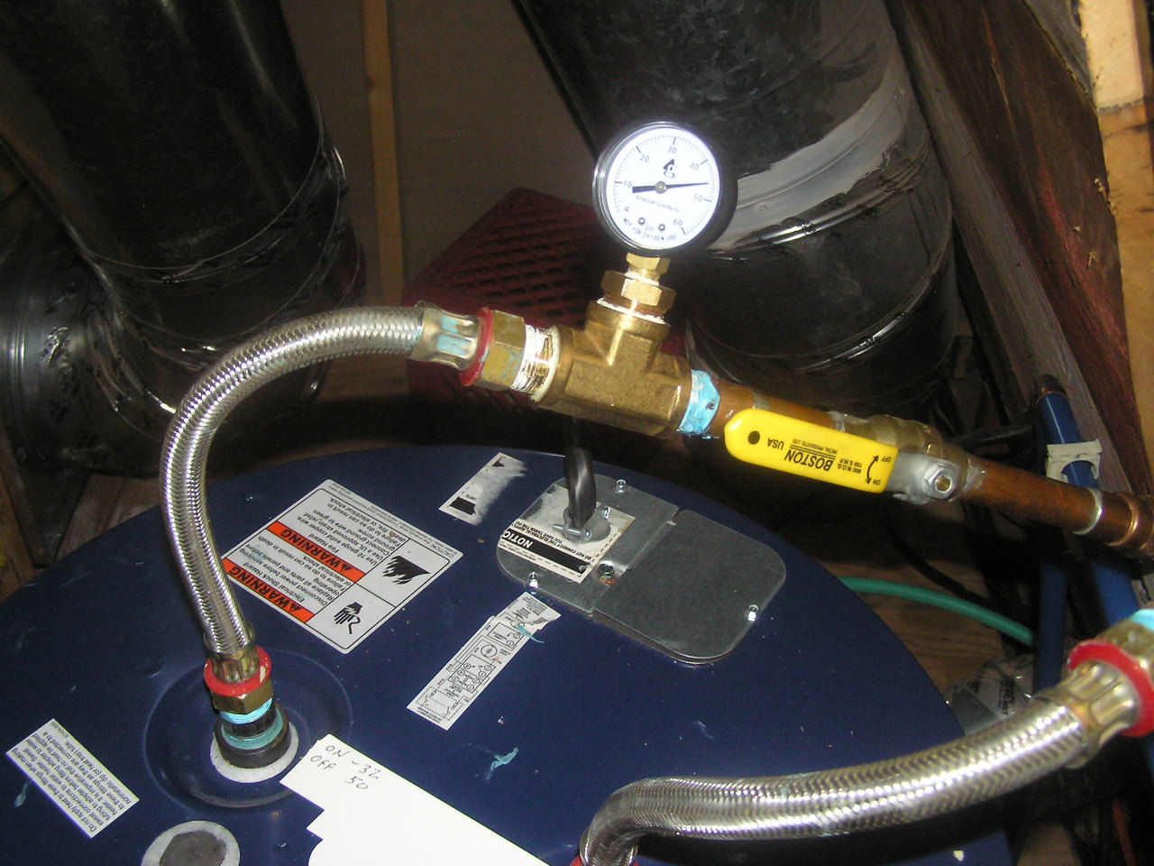

I added a pressure gauge to the input of the hot water heater so I could see that everything was copacetic from inside the house:
Why do you want to know the inlet water pressure for your hot water tank?
Would you suspect it to be different than your cold water pressure throughout the building, or are you just trying to confirm what your overall house pressure is?
If you turn on any faucet, and the flow is weak, you will know that you have a pressure problem.
I can't see that reading the house inlet pressure is going to give you much useful pump/tank information.
The gauge is on the other end of the line from the tank at the well, that is outside a long way away. It shows me the pressure in the pressure tank and that everything is working right. If the pressure slowly drops when we aren't using water, there is a problem, like a leaking toilet flapper, fill valve or outside hydrant.
I also have a light at the well, that can be seen from the house, it comes on when the pump runs.
Yesterday I checked the pressure gauge a few minutes after the pump had shut off. It was 4 pounds lower than normal. I watched the gauge and could see the pointer moving down very slowly.
I went out to the well, turned off the valves to the house and to the barn. The gauge on the pressure switch held steady, meaning the anti-drain back valve in the well was good. Turned on the valve to the house, still good, meaning no leaks in the house. Turned on the valve to the barn and the pointer started moving down very slowly. It was 18 degrees out there and the horse water tank was full, so I turned off the valve and went back into the warm house.
