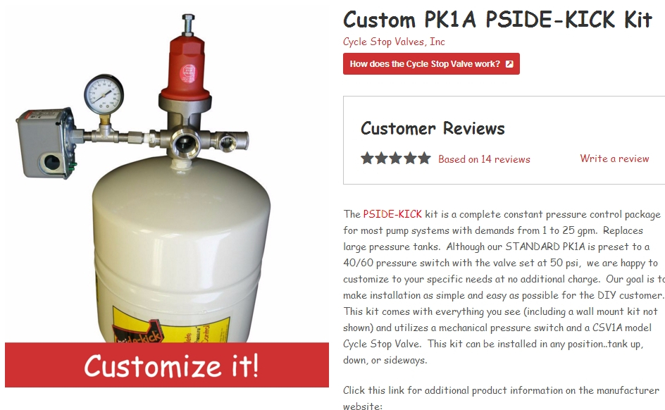

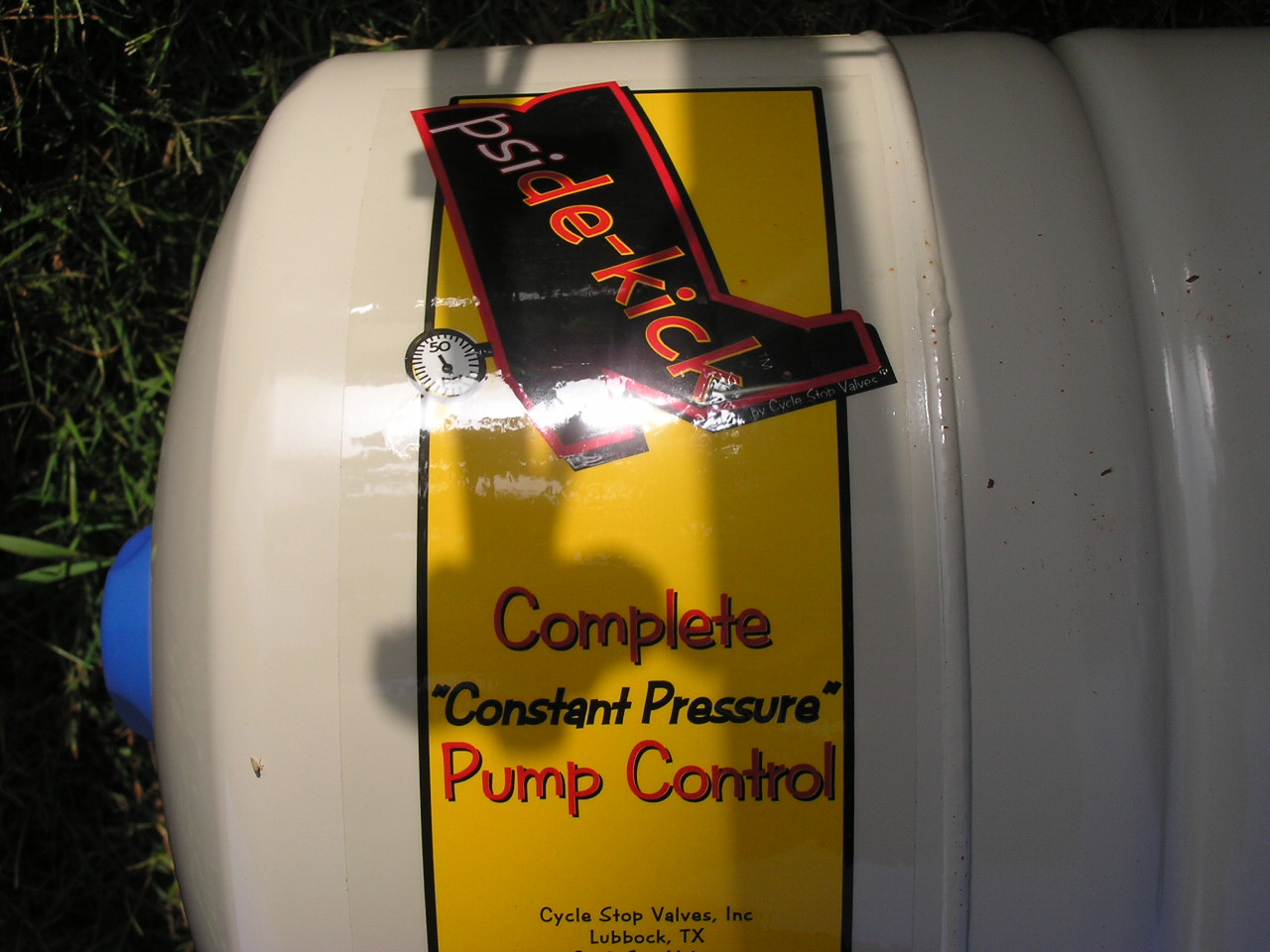

Well they don't make pumps like they did in 76 anymore. Pumps up in the NE where the water is colder and not so much irrigation tend to last much longer. The average life expectancy of pumps gets shot to **** when you add in all those pumps in the south where the water is warmer and they irrigate for 6-8 months of the year. "Varying pressure makes the spray pattern have better coverage" is pretty funny. If your pump was doing that 6-8 months of the year, it wouldn't have lasted very long. Also that little screw in the end of the sprinkler nozzle is made to give even coverage, because the main stream of the sprinkler should hit the same spot on the corners every time around.
It is not really the best thing to have a non-bladder tank working beside a bladder tank. The non-bladder tank needs air charging regularly, and the bladder tank will shoot air out the faucets if it gets any air in it. Plus I bet those two tanks take up a lot of space.
Then if you replace the water heater with a tankless model, the varying pressure will keep it from working properly. And the wider the pressure bandwidth the worse the problem. it takes a certain amount of flow to keep and instant water heater on. When the pressure varies from 60 down to 40, or even to 20 as some have described, the shower head doesn't put out enough flow to keep the water heater on. Then when the pump comes on and the pressure increases, there is enough flow through the shower head that the hot water comes back on again. There are a lot of CSV's being used just to keep the pressure at a constant 50 PSI so the water heater will work, as it quits working when the pressure gets low.
Now if you really want to save space, use a CSV and a 10 gallon size tank. Switching to a tankless water heater and removing both of those big tanks would give you room to make another bed room out of the utility room. Plus the constant pressure from the CSV will make the showers stronger, the instant water heater stay working, give perfect spray pattern for the sprinklers, and make the pump last longer at the same time.
If you think you have good water flow in the shower at varying pressure down to 20 PSI, just imagine the shower at a constant 50 PSI. Some people tell me they no longer need soap, as the pressure will just blast the dirt off. :)
