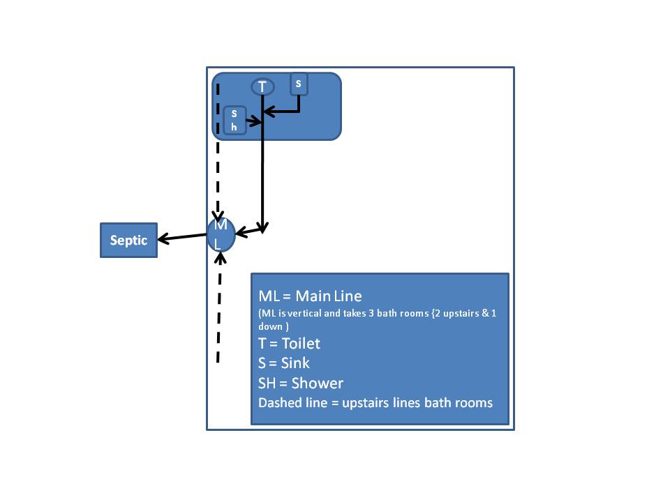

I have a septic tank and a basement with a bathroom and PVC drain pipes.
If the main line to the septic tank gets plugged the waste water will start to come up through thre concrete floor. I cut through the floor and can see the pipe.
I'm not sure what/where the leak is could the joint between the basement shower, sink or the toilet be the cause?
How can I test my sewer lines for a leak?

if you can draw and post a diagram of the lines/layout it may help others offer advice...
if it is possible to cut and plug the basement line from the main line it may be easier to isolate the break...
/ Sewer Line Leak Testing???
Here is basic drawing, but I'm guessing on some of it since I bought the house used.
I do know the line from the basement toilet comes straight out cause I found it when I cut the floor, but if it does a 90° or a pair of 45° to get to the main line who knows. I'm guessing on the basement sink / shower too.
Like I said it doesn't leak when the main line to the septic isn't plugged.

nice graphic...you seem quite capable..
My first observation suggests it should not be difficult to isolate the basement and find the problem...

I noticed this morning that the water level in the toilet was low.
The water in the toilet bubbles when the upstairs shower is being used. I ran a hose down all the vents from the roof back in June.
The water that came up yesterday came up through the concrete (I can see the point it comes up at.) This is the 2nd time it's happened in the year we've owned the house.
The house was built in 1989.
#11
I added some measurements to the drawing.
The drainis 3" PVC all the way (in and outside the house).
The basement toilet only bubbles when the shower above it is being used the other showe does cause it to bubble.
