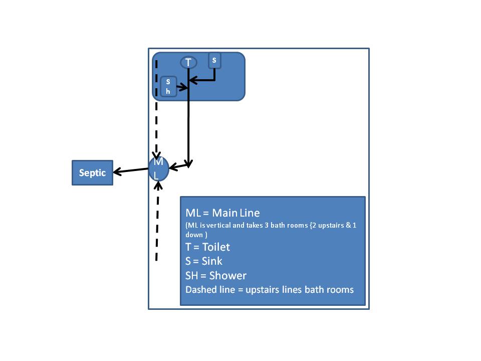

I added some measurements to the drawing.
The drainis 3" PVC all the way (in and outside the house).
The basement toilet only bubbles when the shower above it is being used the other showe does cause it to bubble.

I noticed this morning that the water level in the toilet was low.
The water in the toilet bubbles when the upstairs shower is being used. I ran a hose down all the vents from the roof back in June.
The water that came up yesterday came up through the concrete (I can see the point it comes up at.) This is the 2nd time it's happened in the year we've owned the house.

First off, are you sure the septic tank isn't full?
The first thing I check when I go to a house on a septic system is the tank to make sure it isn't full before I start to snake lines.
Possible causes of the low water level and bubbling are usually:confused2: one of two things: A) Partial blockage of the main line. B) Improper venting.

Based on what you're telling me, I'm thinking A) Partial blockage in the main line between the house and the tank. Hopefully you've got a cleanout to access the line, (I believe you said you did right?) Get a reputable plumber/drain cleaner to come out and snake and clean the line proper. I say reputable because just like any other service trade there's good ones, and there's bad ones out there who will try to rake you over the coals:mad: I would wait 'till reg. business hours to call as most charge extra (time and a half) to come out on weekends/after hours.
If you've got dirty water (sewage) bubbling up out of the concrete, then I'd say there's definitely a problem with the main drain pipe under the slab. (Either a cracked or damaged pipe)
Per plumbing code, sewer drain lines are sealed (PVC is glued) together to prevent raw sewage from contaminating soil and groundwater so you should not have dirty water coming up through concrete unless something is leaking heavily or broken.
It is possible that the water could be leaking around the toilet flange and wicking into the trench line and then bubbling up through the concrete, but I've never seen it.:confused2:
