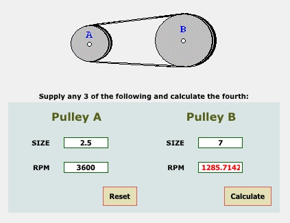

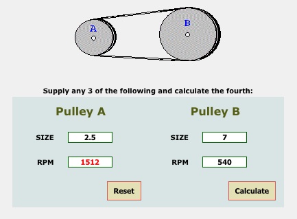

This is what the calculator says you have now:
To get 3600 RPM on the 2.5 pulley with a 540 PTO, you need a large diameter of 16.6...
I would prefer a gearbox instead.
The pulleys measure as follows:
Large = 7" (roughly 175mm)
Small = 2.5" (roughly 60mm)
That's the issue right? If the PTO generator calls for 3600rpm's and the tractor is a rear 540, I need a larger ratio between the two pulleys. It seems to make sense why the volts are only reading 100 or so.
Any brilliant ideas? Like, sell it and buy a different one? I only have $150 into it and it's a Winco. Old but apparently working.
Thanks for all the quick responses

Theres your problem alright. No single stage upgearing of ~ 7:1 is even possible with a 7" major pulley using a V belt. Even if possible it would slip bigtime. You could do it with a small HTD gearbelt and appropriate pulleys. That would be the cleanest mod to the existing setup - not cheap in proportion to your orig cost. You could buy a stepup gearbox for it - even more not cheap.

If you sell it, tell the buyer that as it is, it needs about 1285 RPM input to turn 3600 RPM.
