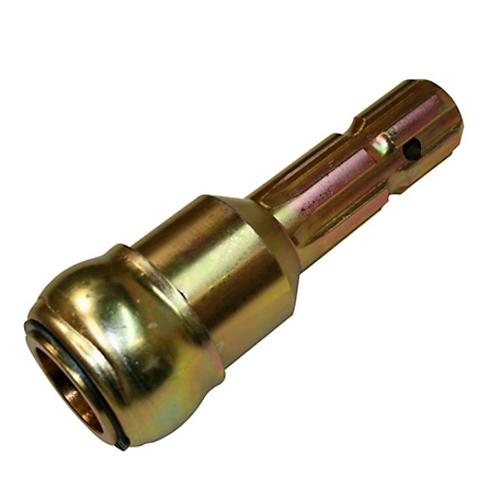

So... I had a shorter PTO shaft with my rotary mower, so I purchased a PTO extension from the local TSC. Did my back field a few times with no concern at all, worked great.

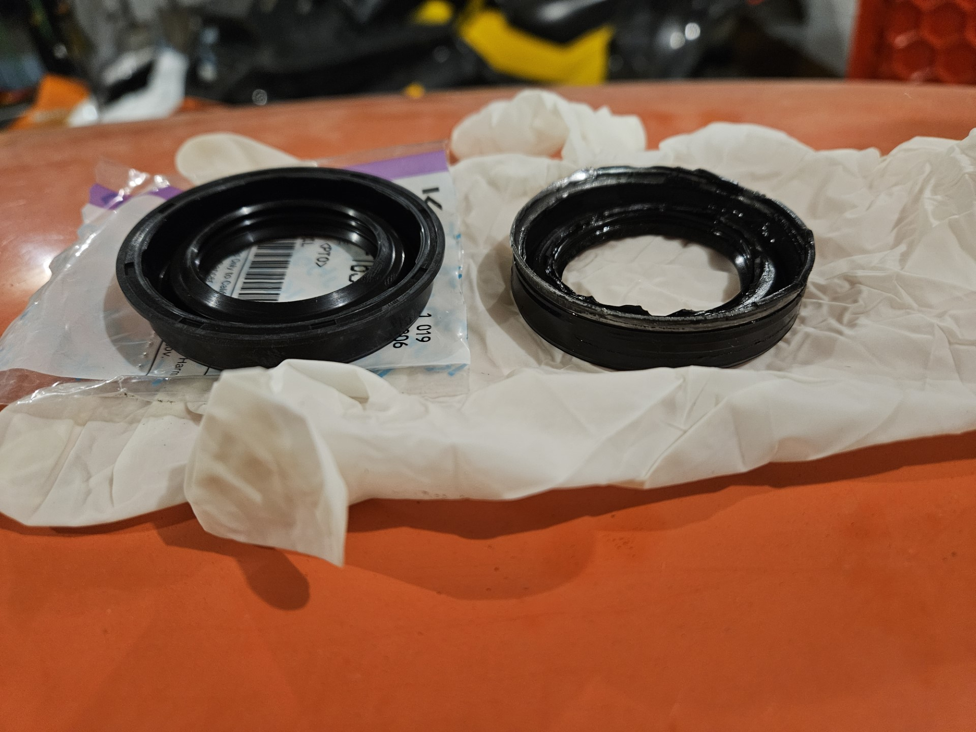

Come snowfall, I hooked up the blower, keeping the PTO extension on. Bad idea. With the longer shaft, raising the blower up, ended up pushing the extension into the seal and destroying it. Got it back into the garage, took the blower off, and put a new seal in. I must say it went in fairly easy. Filled it up with fluid and tried again. Worked great for about 10 minutes, at which point I noticed fluid on the driveway. Immediately yanked the PTO shaft off, pushed the seal back on, as it seemed to almost walk itself off, kept the PTO shaft off, and just used the loader for snow removal. Ten minutes later, noticed more fluid, again, pushed the seal back in, it held for ten minutes or so, and then leaked again.
Attempted to put some RTV silicone on the seal to get it to hold in place better, but same results.
Attempted to put some red Loctite on it, but wasn't thinking and put it on both, the outer edge and inner edge, completely forgetting that the inner edge has the shaft spinning through it, so bent that seal taking it off before I even tried to see if it would have held.
Tractor is a B2650, confirmed it's the same part number from the destroyed seal and the replacement seals I have purchased, and we keep getting more snow here.
Please help. New seal versus destroyed seal.

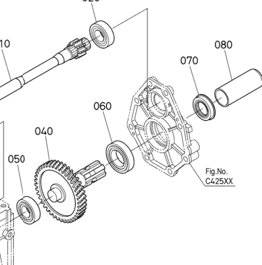

That makes complete sense. I believe the bearing support would be the outer cover based on the parts diagram from Messicks.
SO, going to try to "knurling" with a punch on the outside lip, some appropriate Loctite on the seal, let it cure, and then fill with fluid. Cross my fingers, say a prayer, and attempt the blower. Band-aid repair, I can admit it.
Going ahead, I believe the proper course of action will be new cover (Fig. No. C425XX), new seal (#070) and new bearing (#060).

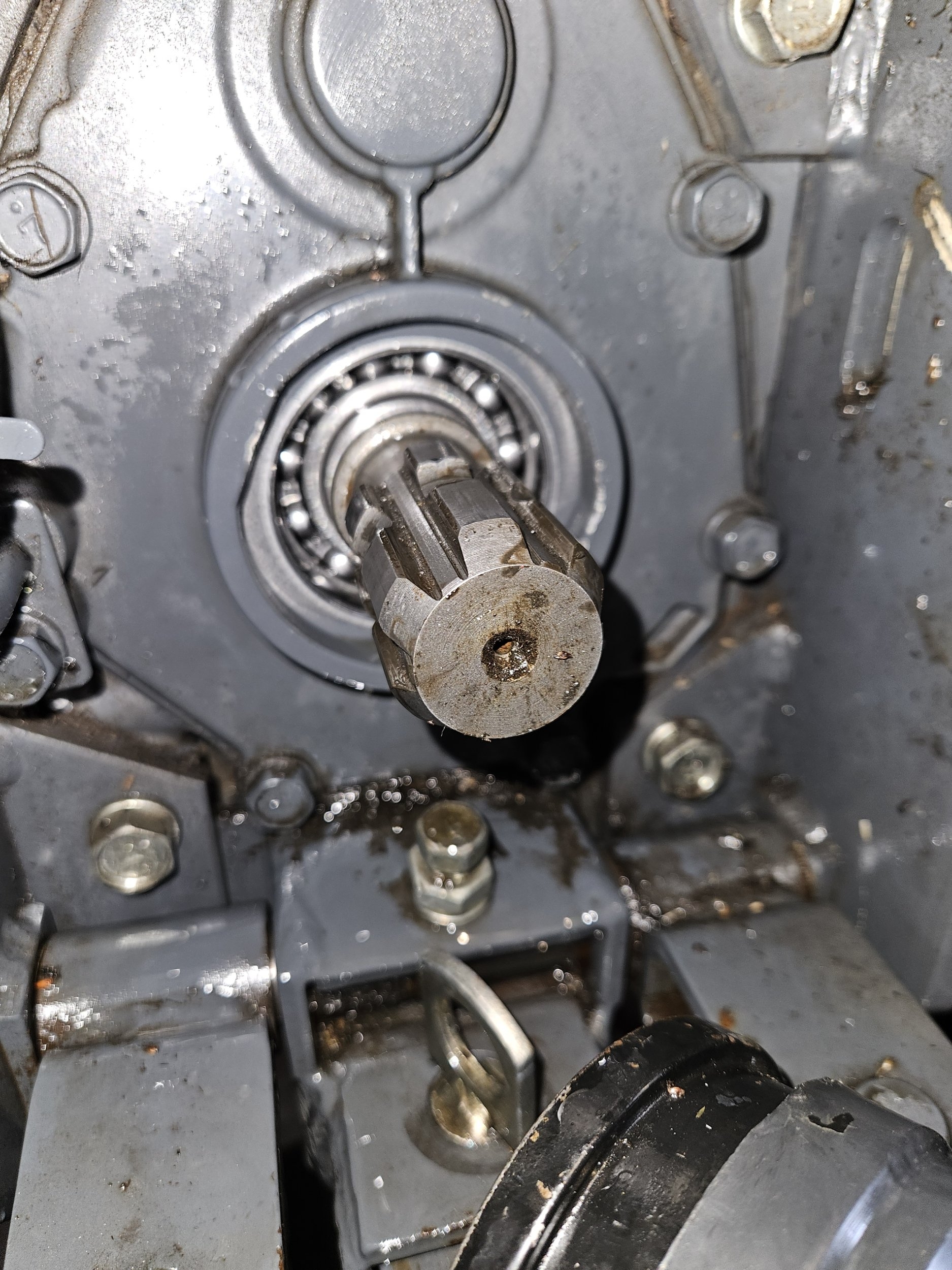

Is the housing actually bent in the area circled in yellow?
Although a sleeve might work to compensate for uniform wear, I doubt it would compensate for the housing being bent if that is what has happened.
/ PTO Seal leaking
#17
I am very happy to see that the cover can be replaced as well. Otherwise it would have been much more costly than it is.
And no, the cover is not bent there, but the outter ring isn't perfectly round, with two sections straight and not round.
