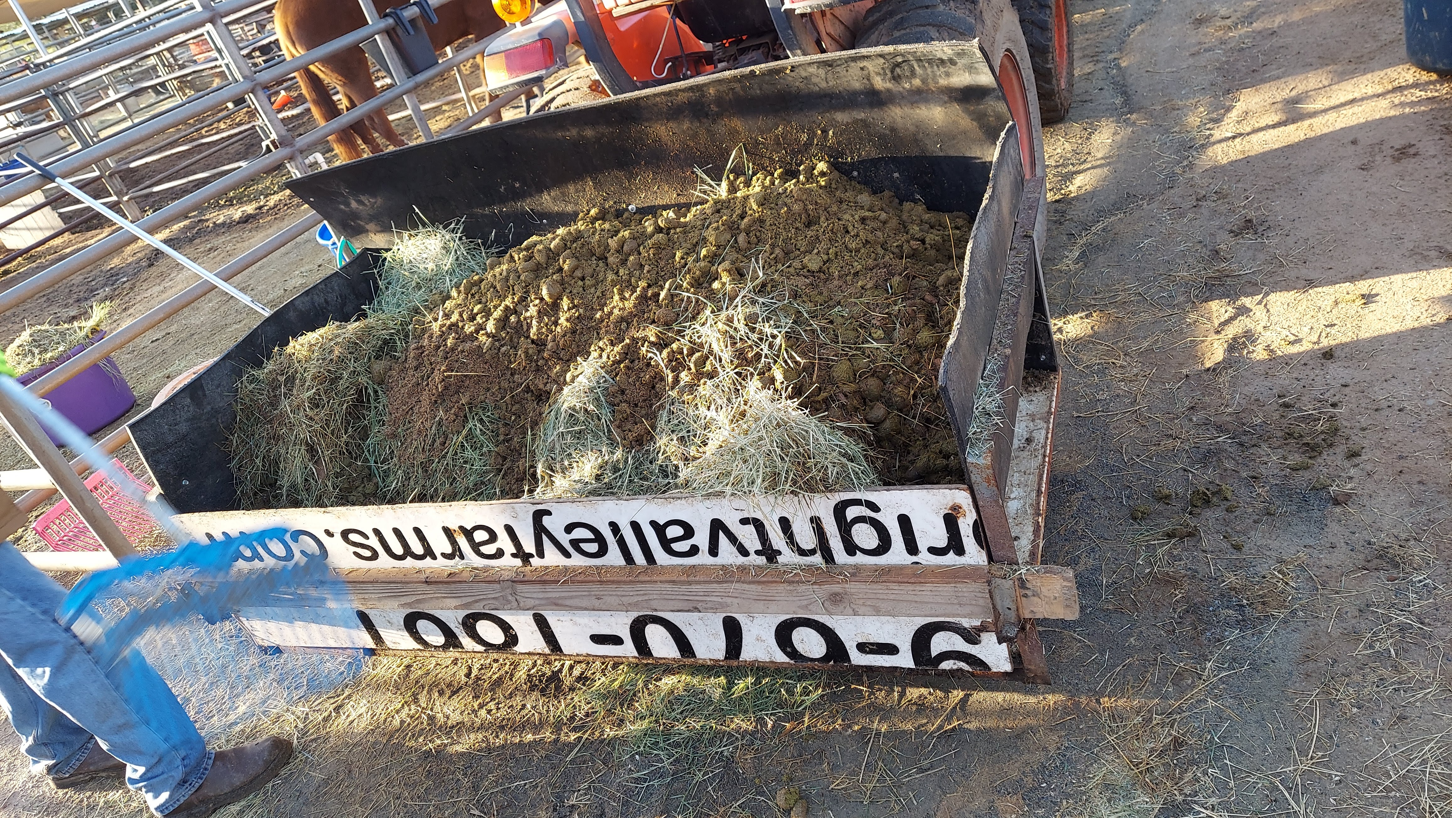

Background: We muck our horse stalls into our Kubota L2501. It has the front "bucket" pictured made as a prototype out of a pallet as well as a dumping carry-all I made. The carry-all is about 6'x3'.
Cons:
Needs a higher back/sides for more capacity and to stop muck getting all up in the SSQA plate.
I have to take the wood bucket off my forks every time I need them.
The fork FEL attachment weights 350 lbs alone not to mention the wood, hoping a dedicated design can be lighter allowing for more carrying capacity.
The wood one is falling apart after a year of use as a "prototype".
We generally dump wheelbarrows or muck buckets into the carry-all/front bucket by hand then drive the tractor 1/2 mile down to the manure piles 3x a day. We used to have a trailer we dumped into but it required use of a ramp or lifting muck buckets high and would prefer not to go the route of a dump trailer for safety reasons.
Edit: added a picture of the 3pt dumping carry-all I built. Metal frame with rubber conveyer belt sides/floor/back. First picture is as it is today, last picture is older with a prototype wood box frame but shows how it hinges.

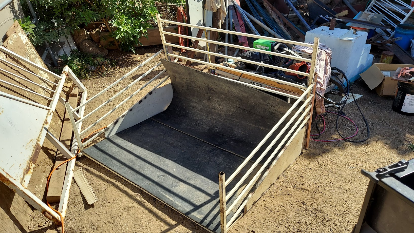

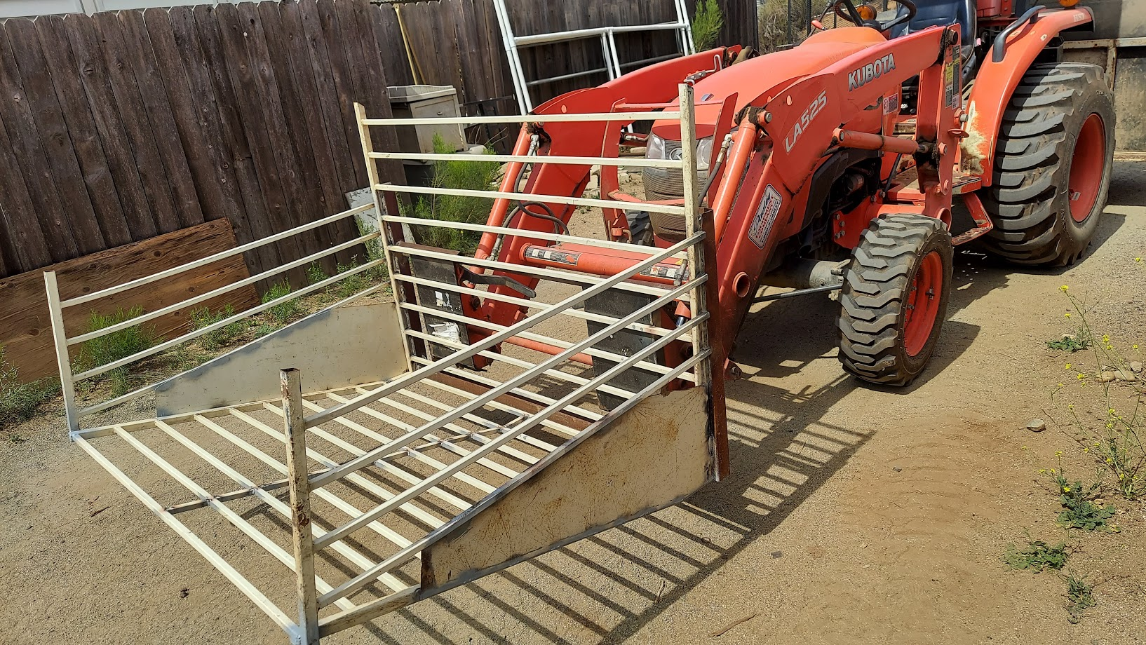

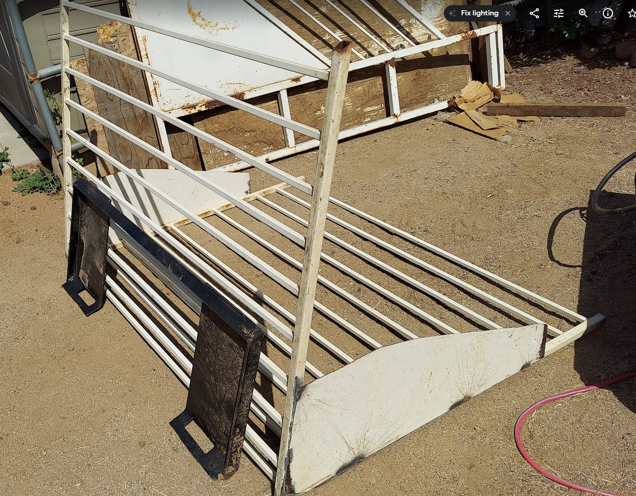

Here's a picture I took a few days ago, I'm further along now. Found a bunch of metal fencing that was a good size so I started with that. I've got the SSQA plate and it's frame tacked to the "bucket' but still need to finish the final welds. Then I'm going to clad it with rubber belting from a quarry. That's worked very well so far with the rear. It's a bit of a PITA to cut but super durable and I don't have to worry about corrosion.

Thin steel will corrode quite quickly with manure - our wheelbarrows rarely last more than a year. I have an abundance of rubber belting from a nearby quarry that we use for stall mats and barn flooring. It's a bit over 3/8" thick and quite heavy but won't ever wear out for our purpose.
I still have a few open tubes to weld shut but after that I can start bolting the rubber belt I've cut out so far then work on fitting the sides - probably going to use a cardboard template to get the curve right. Second pic shows a couple of the rubber pieces flopped in the basket.
