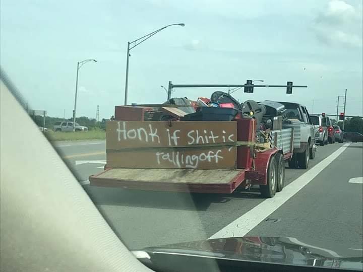

Just saw this on Facebook... I guess it's his backup system to actually being sure the load is contained?
I really can't stand seeing people doing things like that..................but that is hilarious. Maybe he was hoping the cops had a sense of humor.

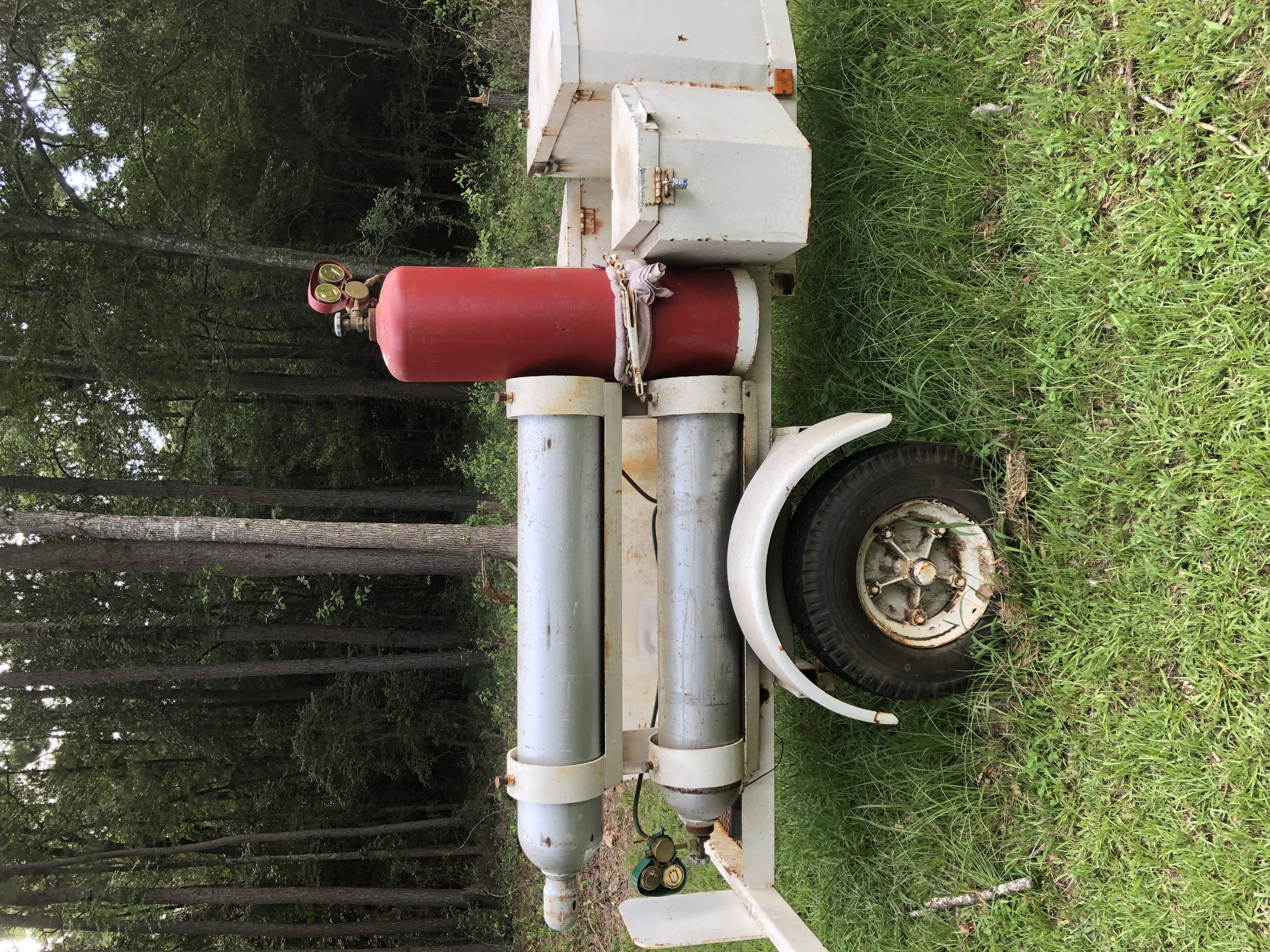

Here is our torch trailer.
Been using it that way for over 20 years.
