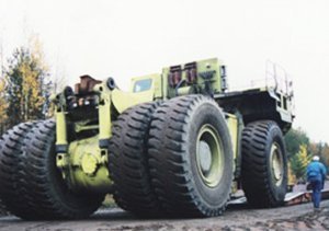

Did you follow BCP's link? They have a video showing them moving a piece of equipment.
   / Share Pics of People Hauling or Towing Something Wrong #11,542
Why wouldn稚 they just drive it? With those big off road tires I wouldn稚 think the ground pressure would be that bad.
Until they get to the first overhead object. A signal light or overpass a sign and that would be as far as they would get.

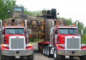

   / Share Pics of People Hauling or Towing Something Wrong #11,543
They are going to find the same or more when hauling it on a trailer- er trailers. More likely it has to do with speed as well as wear and tear. Off road equipment generally doesn't like being on road.
   / Share Pics of People Hauling or Towing Something Wrong #11,544
So it’s shorter on the trailer with the tires still on?? I’m guessing those sticks on the side of the semi trucks are 13.6’ so it’s way more than that.

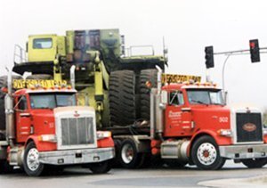

   / Share Pics of People Hauling or Towing Something Wrong #11,546
Would expect a maneuver like that to be staged.....carefully staged. But it doesn't appear to be fake.

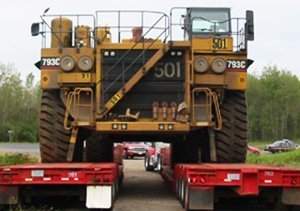

They have a couple other similar pictures on their website, one of them shows a Caterpillar 793C (just the body, no dump box) on the dual trailer setup (which they claim to have invented).
Per the caterpillar spec sheet I found ( here: https://s7d2.scene7.com/is/content/Caterpillar/C198808 ), the 793C (without the box on it) weighs 266,800#

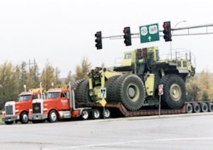

   / Share Pics of People Hauling or Towing Something Wrong #11,550
From the same spec sheet, the truck is 18.5 feet tall (from the ground to the top of the cab).

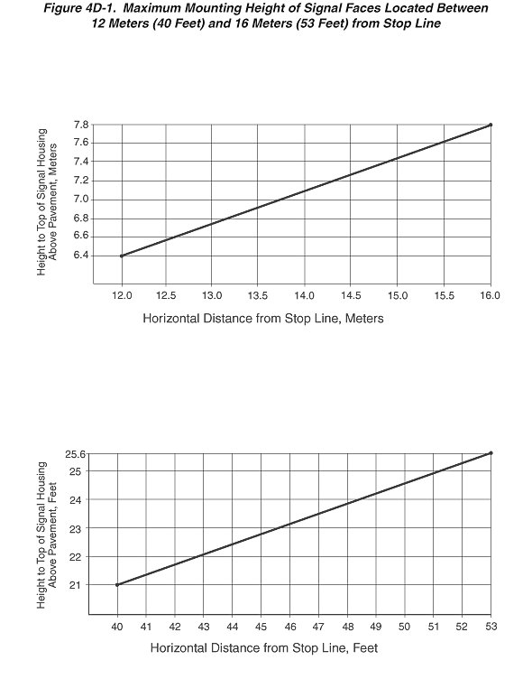

If the intersection is a large intersection and they follow specs similar to Florida's, the top of the traffic signal could be up to 25 feet off the ground: FHWA - MUTCD - 2003 Edition Figure 4d-01 Long Description
So it is possible that they could squeak underneath a traffic signal depending on how it is set up.
