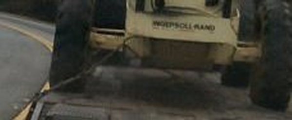

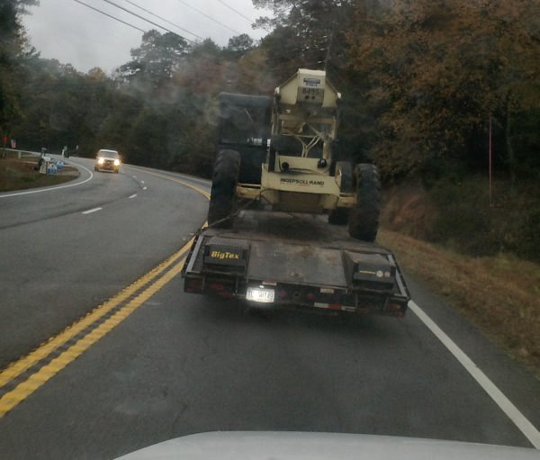

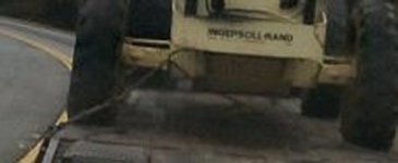

I got behind this the other day, the rear chain had quite a bit of slack in it, I was sure praying that the front chain was tight, atleast I didn't see it rolling back and forth any, Though as I fallowed it a few miles, I happen to about something I never thought of before,
( what if any one of the tires went flat on a pc of equipment after chaining it down, what would happen?
Looking at this pc. of equipment, if either one of the rear tires were to go flat that chain would become even more loose,

yep one wrong bump and that would get sporty

I don't think there is a binder on that chain.

There appears to be a ratchet binder behind the left wheel.
When I haul my tractor I hook the front chain as short as possible then back up until the chain is tight and put a binder on the rear. Haven't lost one yet.

Ingersol Rand never made a telehandler under 10,000 lbs and judging by the width of that machine, it's not their smallest one. That one (at a minimum) weighs in a 12,500. That load should have four attachment points with four separate binders.
