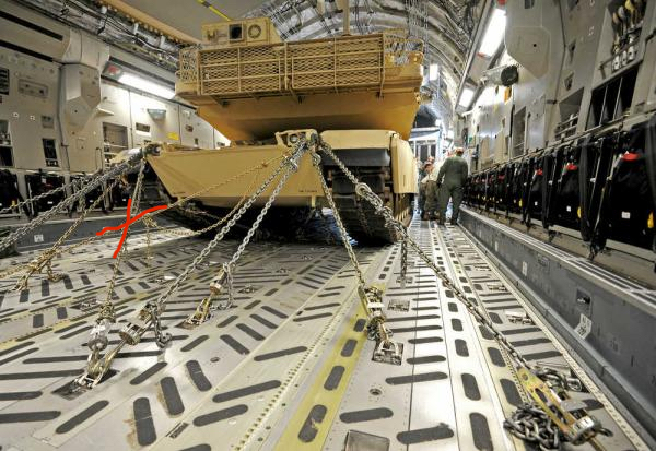

Looks crossed here to me?
   / Share Pics of People Hauling or Towing Something Wrong #17,235
When we used to fly our mission trucks (18 wheelers) on C-5 Galaxy's back in the 80's, we crossed the tie down chains all up and down both sides of the rig. The tie down chains on front and back were not crossed.
Crossing the straps on a vehicle either on a flatbed tow truck, or a trailer prevents the vehicle from walking back and forth while going down the road.
Stiff flat bed tow truck suspensions, bumpy roads, hauling cars without wheels or tires, I can promise you, those cars (loads) will "walk around" if you don't. Sometimes even vehicles with wheels and tires will also walk around if the road is rough enough. The vibration between the flat "bed" (either truck or trailer) and the load (in this case vehicle) is what causes it (assuming the straps are tight to begin with).
Properly secured and crossed straps will not fail, and will not walk around. The guy in the video claiming crossing the straps is what caused the strap to fail is dead wrong.
What he's really saying is that he failed to use his straps correctly and failed to anchor his load correctly.

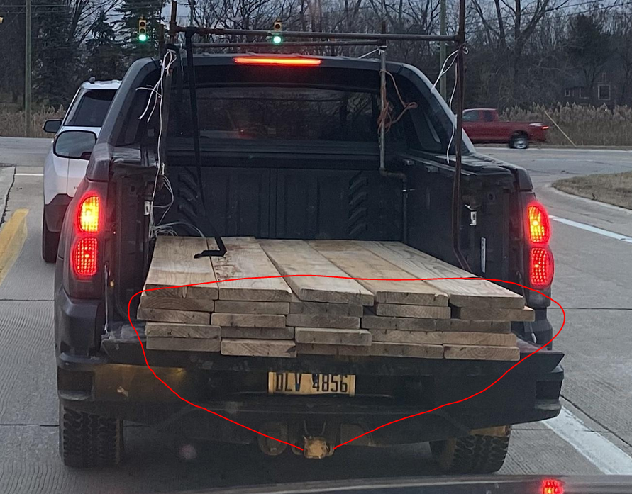

Run a strap from the safety chain attachment point on the trailer hitch around the side of the pile, over the top and back down to the other safety chain attachment point, like the red line here:
That will pull the pile together, pull it forward and hold it down better than a strap over the top would.
Aaron Z
You still would have very little holding the boards on the top in the center.
Next time you do that pull the top center board out to prove it to yourself. It will come out as easily as if there was no strap.

One more legitimate question: why do some people use X strapping?
It's a good question, and the physics in my engineer brain suggest this is a bad idea. Picture hitting a bump that induces a counter-clockwise lean/roll in the vehicle - you've just undone the straps. Granted, they would have to be loose enough to allow some movement. But there's just no good reason to do this. I would use the stake pockets on the outside of the trailer instead, and not cross them.
This is why I stack my board in a semi-pyramid shape - it gives your strap some "purchase" on all columns of boards.
Here is my 1 minute sketch from paint.
