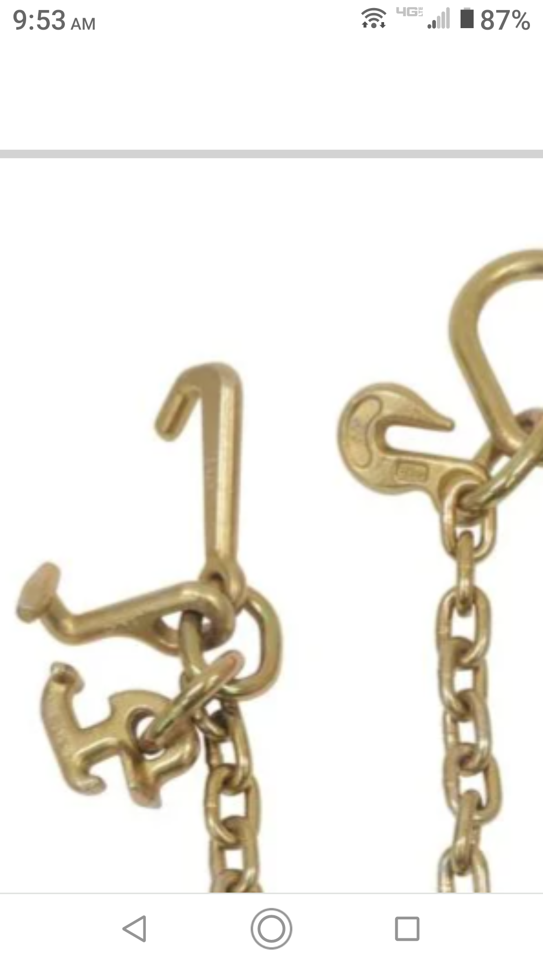

Perhaps the frame rails on your unibody is reinforced enough to insert one of these not talking about hooking it with a j hook around the a-arm either.

Yup have a slot for those on "frame" rails on each side, not that tow ops are are that careful all the time. I've rebuilt the Magnum from the doors forward so I know what under the skin.
