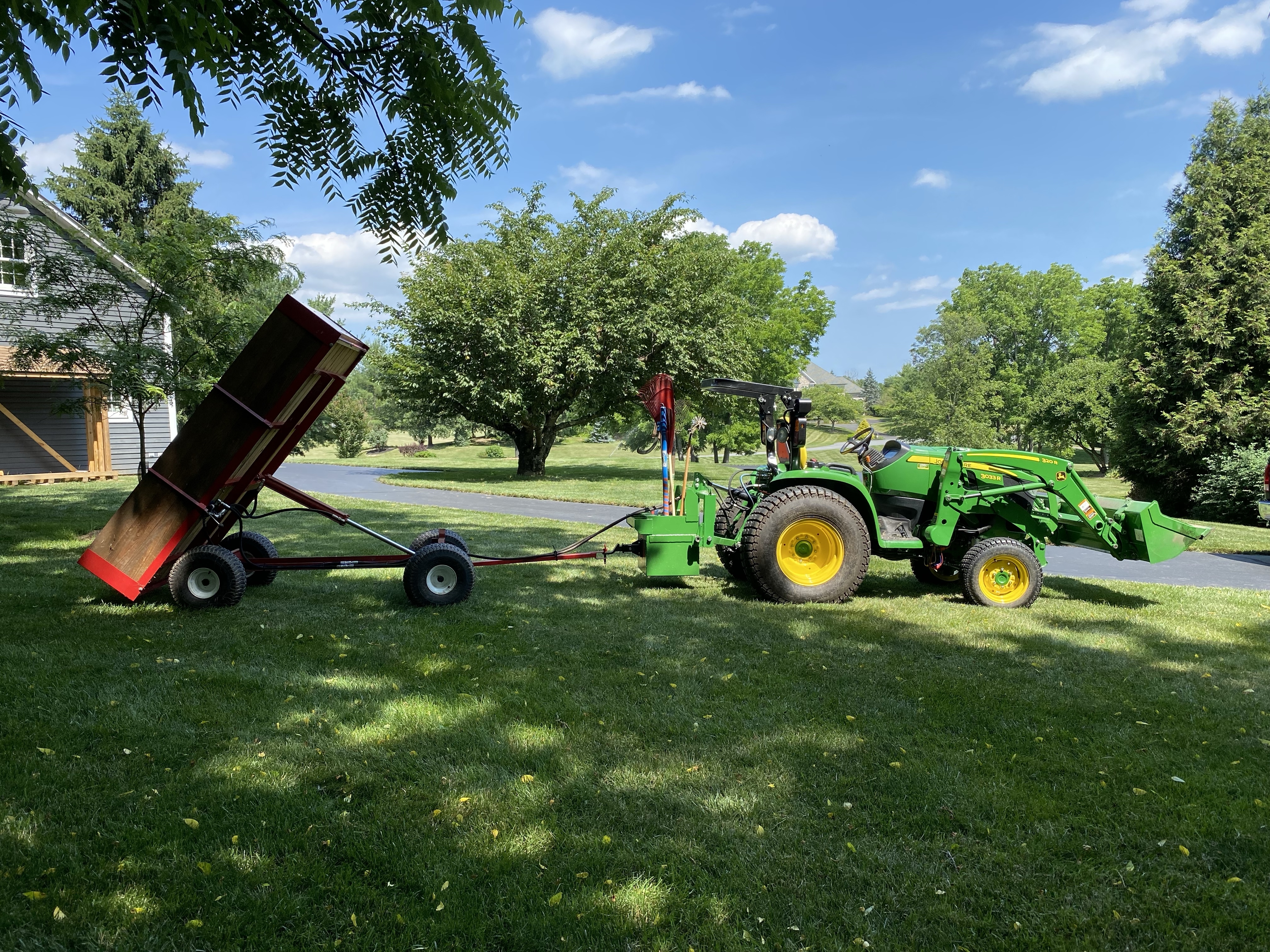

Here's a reversal on the towing question: What do you folks with backhoes do, for towing a utility trailer while the backhoe is mounted? I have a few projects for which I'm contemplating buying a backhoe, which would be added to my 3033R.
Trouble is, I'll be moving dirt from one place to another, and my best tool for that job is my 2-ton 4x8 foot dump wagon. I usually use my tractor to tow and power the dump wagon, but with the hoe installed, I'm thinking that will be difficult or impossible.
There are various ways to add a hitch to the front of the tractor as long as you don't mind backing up while you are towing. You could use one pair of your loader hydraulics to dump the trailer.

Trailer is set up with live center valve, and normally hooked into Power Beyond loop. And while this can run in series with the backhoe, I'd have to extend the hoses to reach around it.
I do have a third function out to the end of the loader, and that could be used for dumping, but I'd have to ditch the valve on the trailer, or tee in downstream of it, to make that work.
I have a hitch that clamps onto the bucket, one of the heavier ones made, but I'd not trust it with a 4000 lb. trailer load of dirt on a hill.
If there's a means to attach a draw bar under the backhoe, I could connect the trailer there, and just keep the bucket raised up above the trailer. Otherwise, I think I'm stuck rigging something to the backhoe bucket, like @bcp's video.

You have just described the scenario in which keeping a running, 2nd tractor around is highly valuable. I wouldn't be trying to tow up to 2 tons when you already have a 1000-lb backhoe mounted. Buying a used mini-excavator to do your digging would be an even better plan, though. If you've ever run a 3 or 4 ton excavator, you'll probably be pretty dissapointed in the digging power on your 3033R, comparatively.

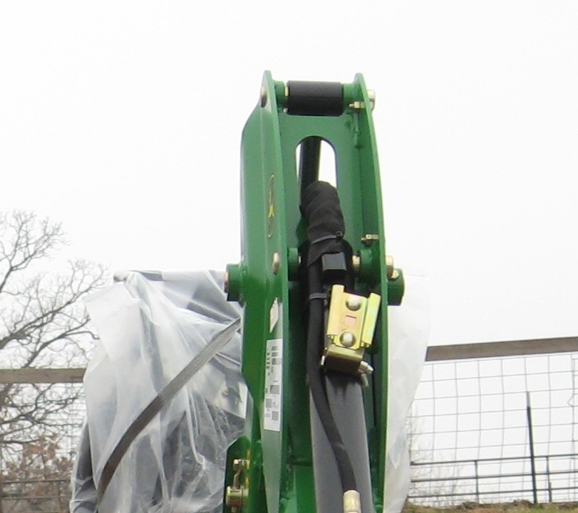

The backhoe for my machine came with a SMV sign mounted to the mast (presumably because the one on the tractor would have to be removed to mount the hoe). The one on the BH mast just has a "slip-on" bracket for tooless removal/replacement to get it out of the way when working, but to replace when needed for roading.
That bracket looks like the ones on my Kubotas. Both are mounted to the ROPS. Jon

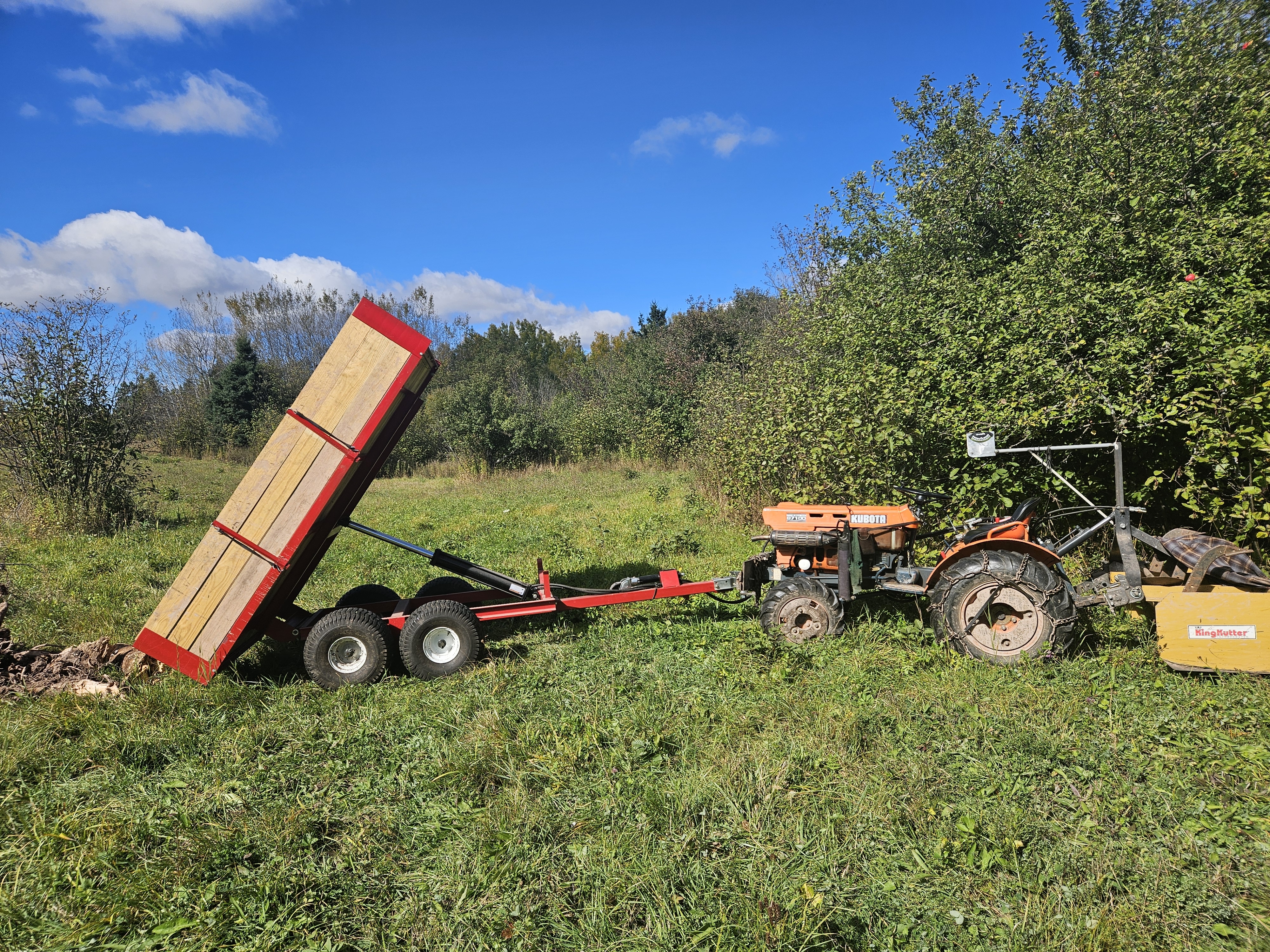

When I need my BH and trailer somewhere, I hook my 4 wheeler to my BH bucket hook on my L3540HSTC. Then I come back with the 4 wheeler for the B7100 and the trailer.
It's easy to drive my trailer backwards in 5th gear, it's a CMI 4k dump, works great.
A long time ago, I posted about my B7100 and trailer (4" cylinder, 2' stroke), someone said it would take 5 minutes to dump. At just over idle (no difference if empty/loaded) it takes one minute up and one minute down.
