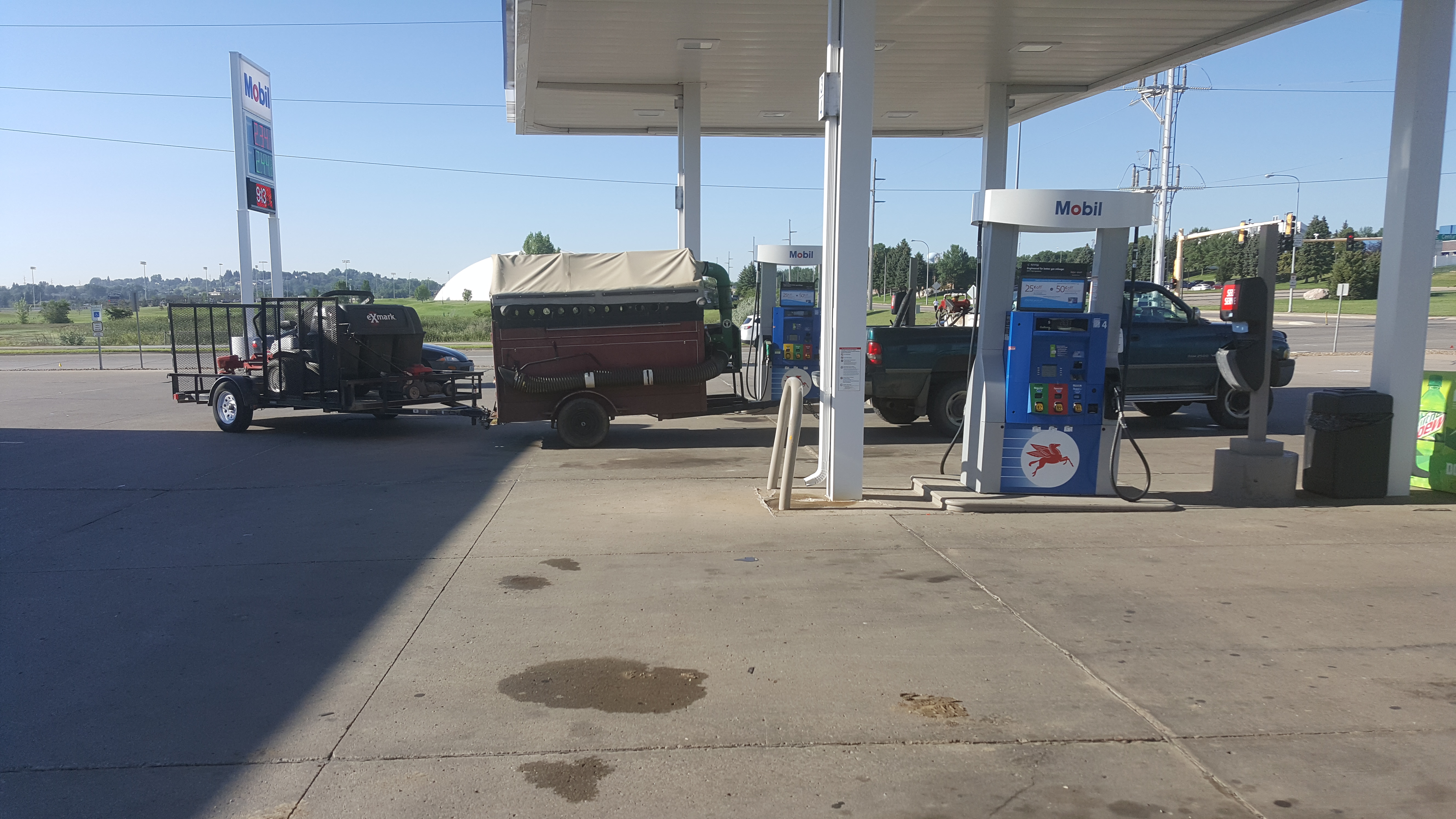

Most states that allow double trailer pulling require that the first trailer be a 5th wheel hitch. Very few states allow double bumper pull hitches. I'm honestly not sure if ND allows it or not, but if they do, the front hitch has to be rated for ALL the weight of the combined set. Look at his front hitch.
BTW, the reason for the pic, which I guess no one noticed, is neither the push mower, or the zero turn mower are tied/strapped down in the rear trailer.
Here is the guide i use. ND does allow double towing. Only limitation is brakes on trailers over 3K and requires on the 1st trailer.

Nice zero turn mower with bagger. the first trailer looks to be a large vacuum cleaner likely used to empty ZT bagger into first trailer.
Actually, I think the first is the bagger for the ZT on the second, looks like the hose on the side of the trailer w/ a deck attach hood
   / Share Pics of People Hauling or Towing Something Wrong #5,856
That hose on the side is for vacuuming up leaves from a pile. There is probably an opening in that trailer to dump the bags from the z turn. However, if the z turn has enough traction power to pull that trailer, it would be a great leaf trailer, but would take a very large lawn to fill it. That trailer has its own blower mounted on the tongue. Have seen trailers set up like that one during the fall clean up season here in northern Michigan. Jon
