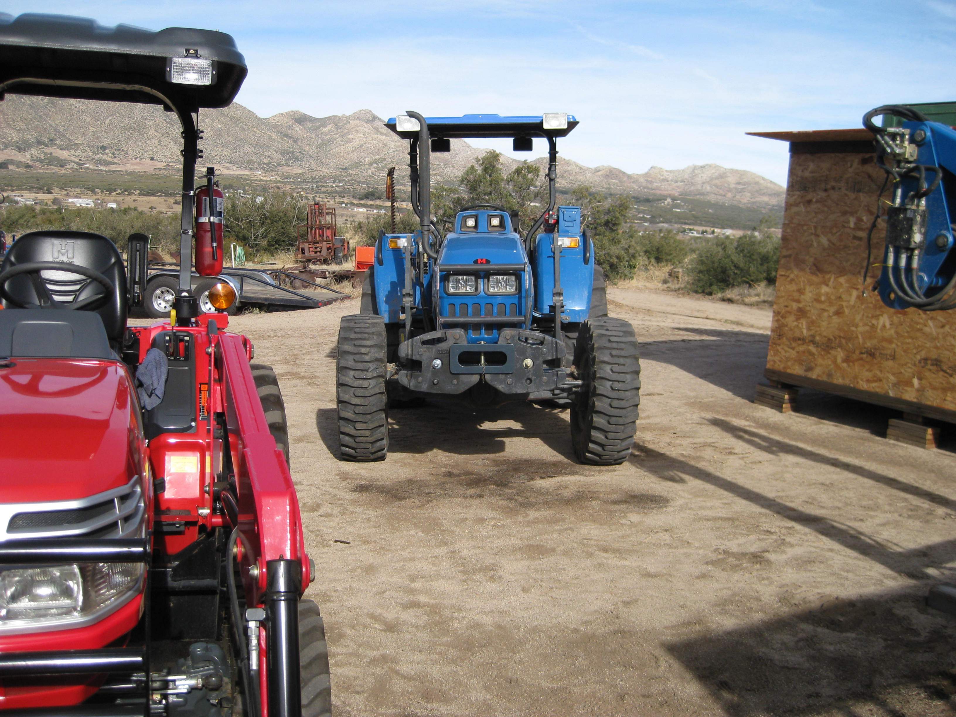

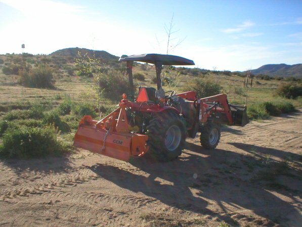

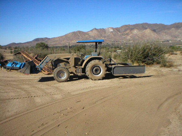

I have two, a 7520 4x4 and a 3215HST. Both tractors have loaders and have been excellent machines for what I use them for around the ranch. ;)
