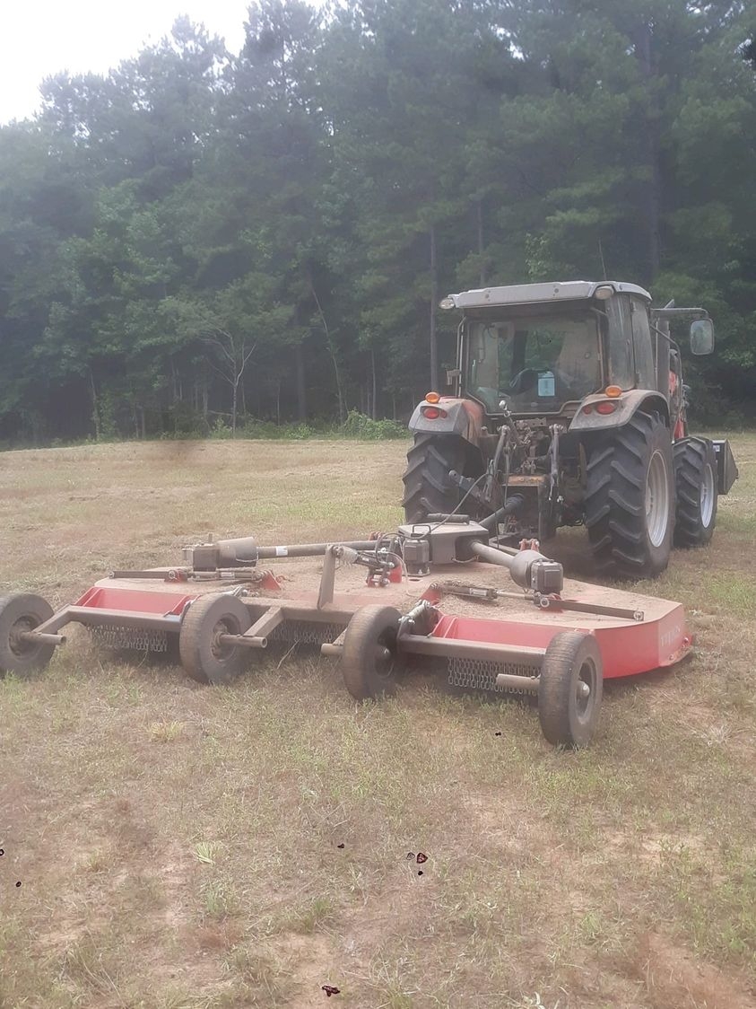

Took some slack in projects to level, tune, service, grease, and sharpen the blades on my 12' rotary cutter today. 🤠
Cutter is a 12' Modern Ag "Viper" batwing cutter. I pull this cutter with a NH Powerstar 75.
It is sweat inducing work to say the least. But things just run better, cut better, and have less serious problems when I do this periodically.
This time will be less intensive than the next time... Next service it gets, also gets all the gear boxes drained of gear lube and cleaned, then replaced with Corn Head grease. That ought to make a mess.
These blades are over 2 years old now, and still in decent shape. Sharp as all get out now. Cutter is now leveled and tuned so that I can cut the next project at about an inch and a half off the ground level.
How often do you guys go through your cutters, etc., like this?
I only wish my 15' cutter would be as easy and precise to tune, and have the blades last as long as this 12' cutter.

I'm going to corn head grease for a couple of reasons.
The first is on this Viper cutter, the right gear box absolutely throws standard gear oil out the vent hole. I mean I can fill to the full level, and by the end of the day, it's low again, and I have a mess all over the right wing deck. This is caused by the gear box construction, and where the vent hole is located, in conjunction with the direction the gears are spinning...
The left and center gear boxes are spinning one direction, but the right side, the direction is reversed, and slings thin oil out that vent hole.:(
I talked with the factory rep and asked him if it would hurt to pump some HD red grease into the box to thicken that oil so it wouldn't sling out as bad. He said to go for it, it wouldn't hurt anything. So I added about a half a tube of red grease, and it had the desired effect. It still vents air, but has sowed the leakage WAY down.
The other reason I'm going to corn head grease is to give out of warranty gear boxes a better chance of surviving when a seal does go out. It's not easy to check seals all the time, especially the center bottom one. Just added insurance.

I hear ya!
Keep those blades touched up with a flap disk and angle grinder! They'll cut better, and much, much cheaper and easier than replacing blades! ;)
My big Woods 15' cutter has grease fittings on the drive shafts of the wings. I hit those daily! Never a problem.
This Viper cutter doesn't have them, so I have to loosen the driveshaft from the gearbox, extend them out, clean off the sludge, and grease the shaft by hand, then re-connect the shaft to the gear box. Not a clean, fun job... But if you don't keep those shafts greased and sliding easily, they can bind up, and bend the drive shaft when raising the wings with powerful hydraulic flow. Not a great road to go down, so try and grease the drivelines. I remove that lawyer induced cover from all my cutters before I use them. That gives me much better access to U-joints and fittings, and the shafts themselves.
I had one gear box get kinda loose on the Viper when new. I tightened them all for the first couple hundred hours I used the cutter... I'd check tightness every other day or so. After that, they have stayed tight for the last couple of years. Those gear box bolts work better and less frustration is involved if can tack weld that bolt from the bottom. Saves lots of cussing. 😆
I use a powerful gas leaf blower on the deck every day when done. Blow off the tractor as well. Keeps things better all around.
