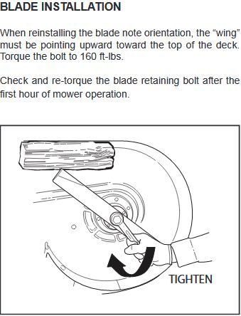

Rented a torque wrench to do a big diesel overhaul It was 4 feet long took two men to torque things to 450 and then 650 lb .
   / Sharpened blades on mower deck #22
just look at the free-body diagram for a blade on a spindle. Blade bolts are self tightening. Hit something and they really get snug.
   / Sharpened blades on mower deck #23
I've read elsewhere in OTT that the WSM for Kubota decks seem to recommend 450lbs/ft for most of the MMM decks. My 1/2" Dewalt pneumatic impact will do 650ft/lbs. I haven't found a 3/8" that will go above 350. If possible, I think I'll be blocking my blades with 2x4 and leaving mine on to sharpen. Just seems nearly impossible to get the torque right otherwise.
JK22,
PLEASE recheck those torque specs ! ! ! My SM for the 54" MMM has a spec of 72.3 to 86.8 ft lbs. I tighten mine to 75 ft lbs. Have had no problems with it in nearly 500 hrs of use.

JK22,
Dave
Please note I previously stated my prior post was incorrect. I can't edit my post--- but I did do a new post above. I regurgitated bad information.

I'm a firm believer in a torque wrench. I torque mine to 80 ft/lb
   / Sharpened blades on mower deck #31
JK22,
Sorry, I was just trying to prevent you from stripping the threads on those mounting bolts. I didn't see the other post, as my computer has been acting up the last few days. Glad you found the specs in the manual.
Dave

No worries at all. Always good to correct bad information.
   / Sharpened blades on mower deck #33
Hello everyone,
I set the blades on my Deere 62C to the manual spec of 50 ft/lbs and lost one blade this week! Fortunately, I can find no damage except a bald spot in the yard. I am going to tighten a little more than the spec and look into some thread seal.

My overtightened blade bolts were not factory, but me replacing blades a couple years ago. I have two sets and swapped the blades. I did not think I over tightened them, but they were sure a bugger trying to get off.. my new impact did the job, sharp blades are a joy to mow with.
   / Sharpened blades on mower deck #35
Blade bolts on my John Deere 413 brush hog are supposed to be torqued to 433 ft-lbs by design and torque multiplier wrench is recommended!
