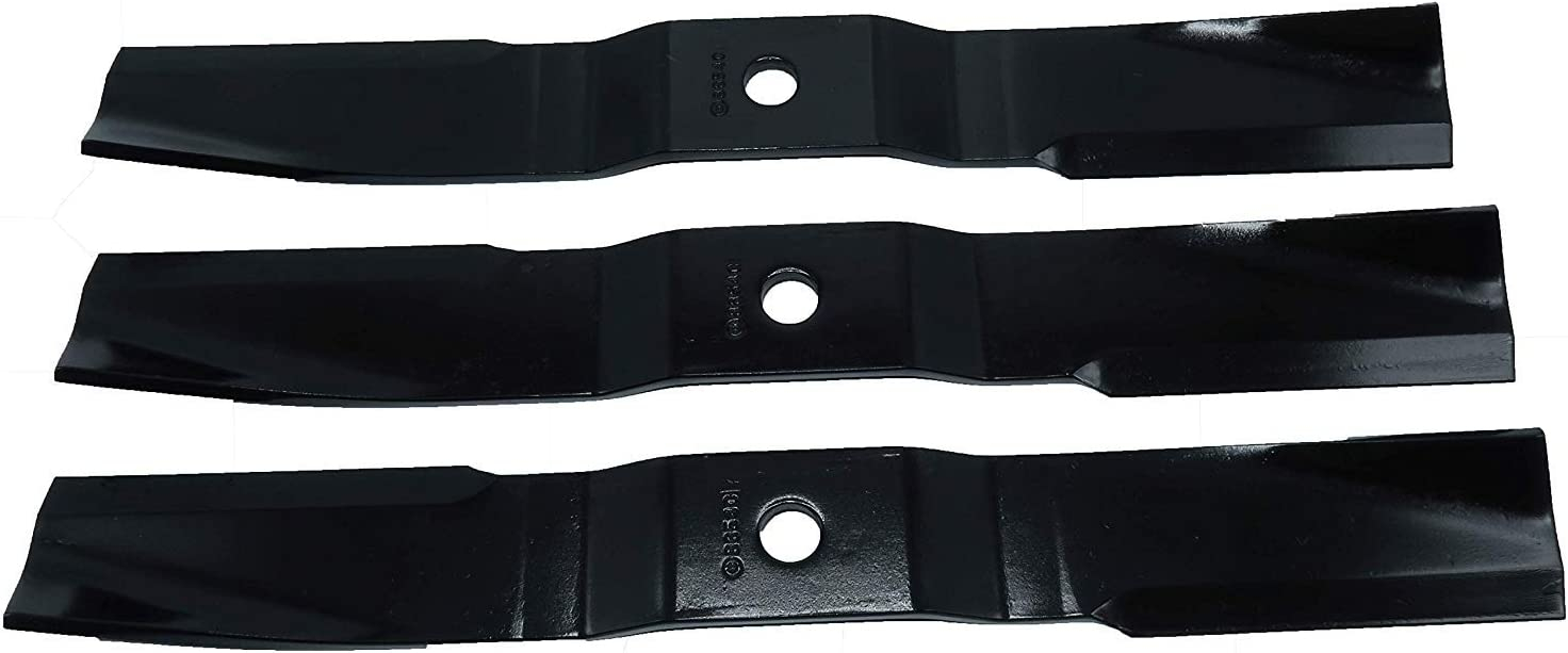

There are no alternative blades available, only the OEM parts. hube2
so is it the length or shape that makes them proprietary? so much aftermarket out there

I take it you got that 60" deck, right? That's the problem with Massey's deck, I could never find alternate blades for it either. Other problem is that you can't mulch with it (even if you were able to find mulching blades for it).
Yep
sounds expensive
They appear to be unique to the 60" Massey deck.
I did all the kind of measuring and looking thinking I could get find something. I was hoping to find mulching blades.
There are a lot of factors, the biggest one being the difference is height between the center where it attaches to the spindle and the blades combined with the center hole and blade length.

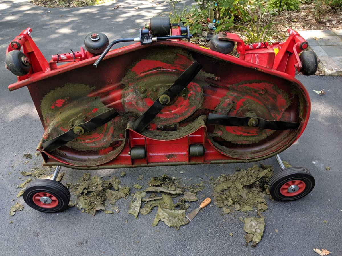

Yeh but even with mulching blades, the deck design won't allow for effective mulching. That deck is built for side discharge only, that's why it's got the open channel on the front there.
Decks that allow for mulching (with blocked chute or otherwise) are baffled on both sides with an open channel running down the middle toward the chute. And dedicated mulching decks (Massey has one) are fully baffled with no open channel at all.

I was hoping for a set of gator blades or similar. While not exactly "mulching" they do produce a finer chop even with the side discharge. Plus they were cheaper and lasted longer than the oem blades for the JD.
Where did you get the wheels for standing up the deck? They are wider and the wheels are larger than the set I have, looks a lot more stable.
Also, thanks for the pic, I like how the guide wheels are stored and I never thought of that. Much better then my method of tossing them in a corner of the shed for the winter.
Yeh gators are great, I hear ya on that. I got them on my Bradley right now, they're great year round.
Oh the deck storage wheel thingies, I build those. The wheels themselves I got off ebay.
