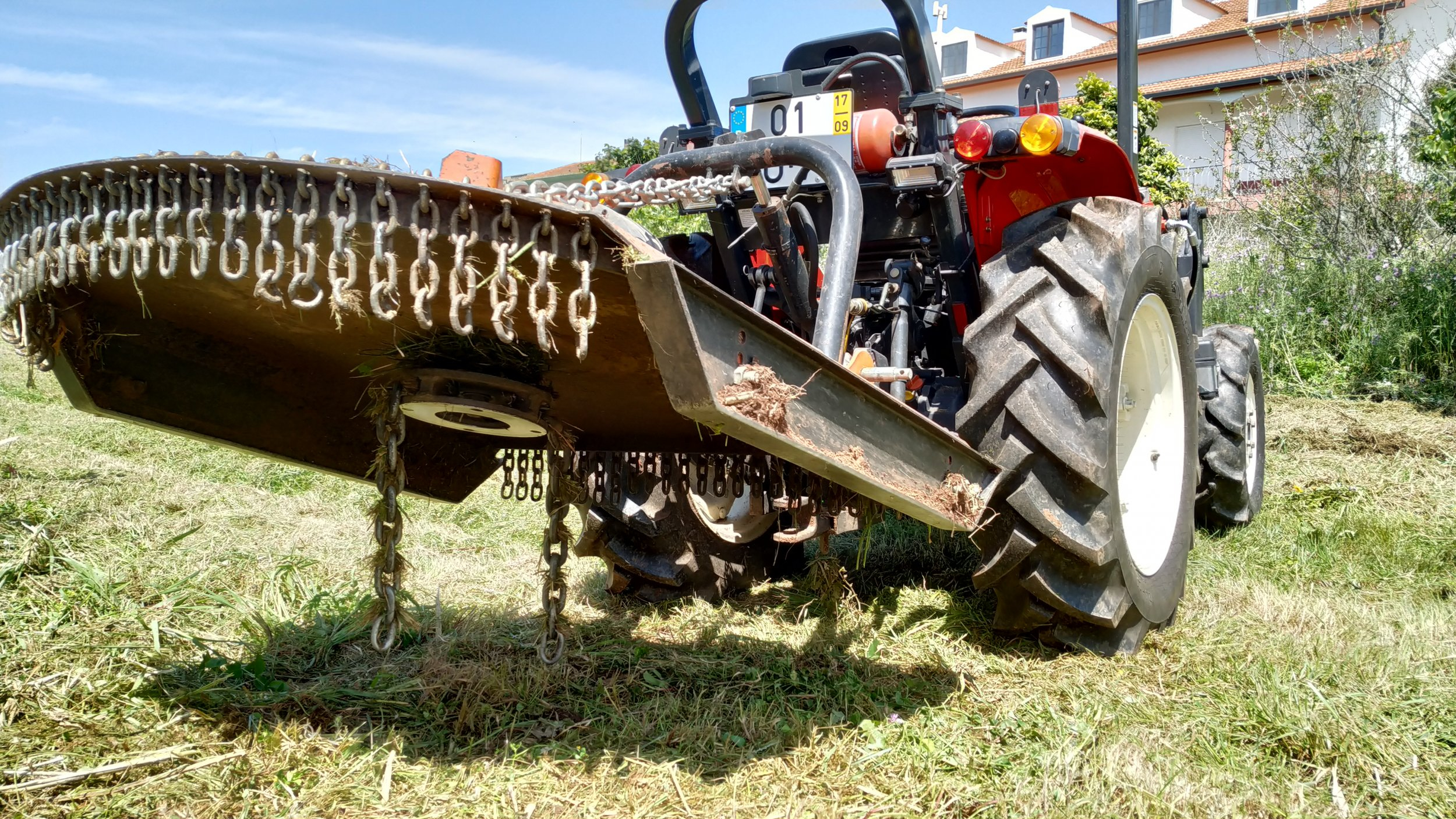

The nut holding the blades on a Rotary Cutter or Bush Hog are usually torqued to 600-700 foot pounds. Most do not have the tools to remove the blades so they either do not sharpen or sharpen the blade mounted on the Bush Hog. This is hard to do. The blade(s) are mounted to the stump jumper and are by design meant to be free moving. The weight of the blade and centrifugal force is what holds the blade out for cutting. Being able to move also allows the blade to deflect inward and away from a struck solid object to prevent stress loading and destruction of the gear box on the Bush Hog or drive line damage on the tractor.
A good Bush Hog video to watch. Also please note the object deflection or knock down chains on the Bush Hog in the video. Many a Farmer has done some big time damage by throwing a huge rock against something or through something.
