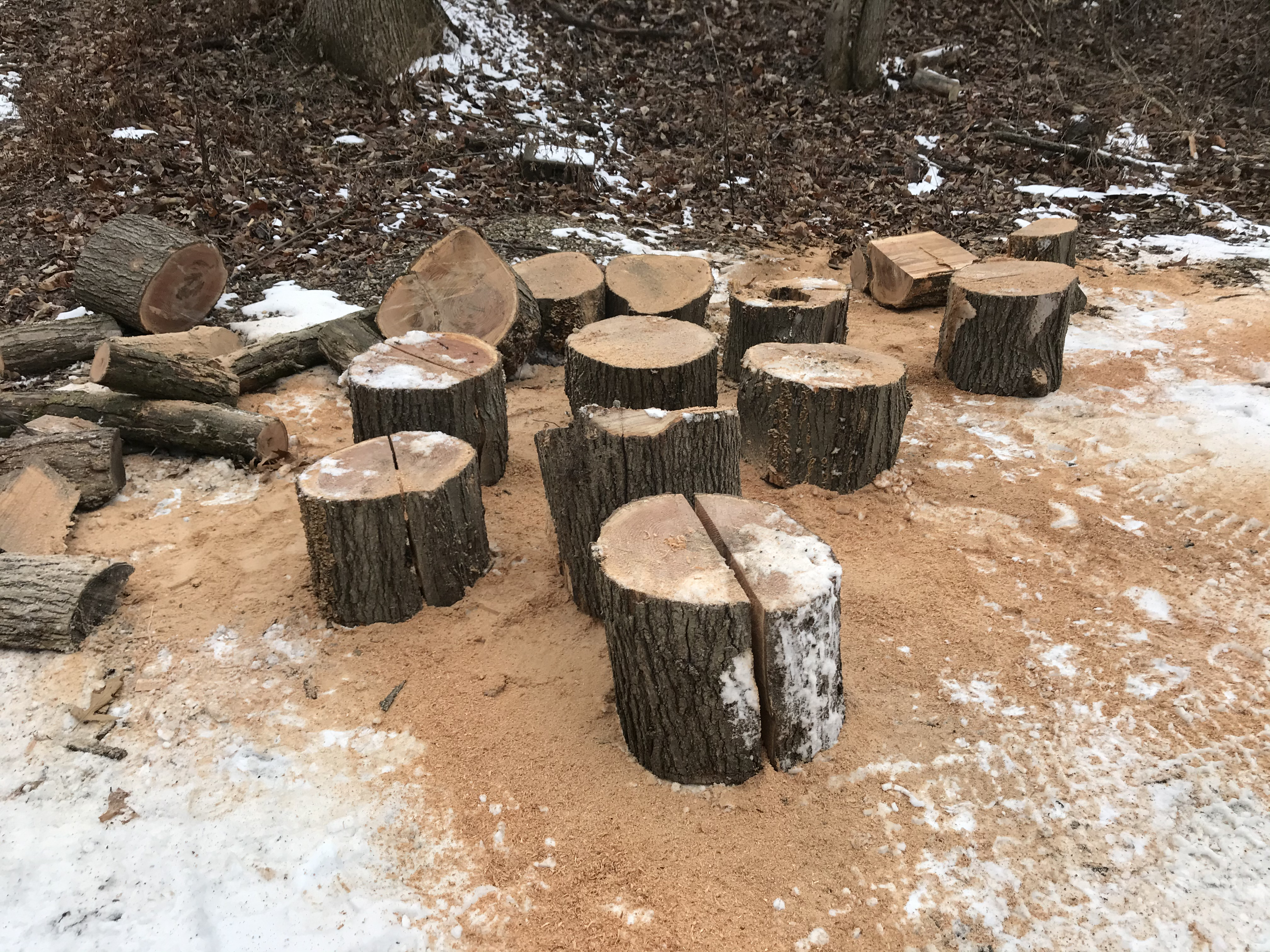

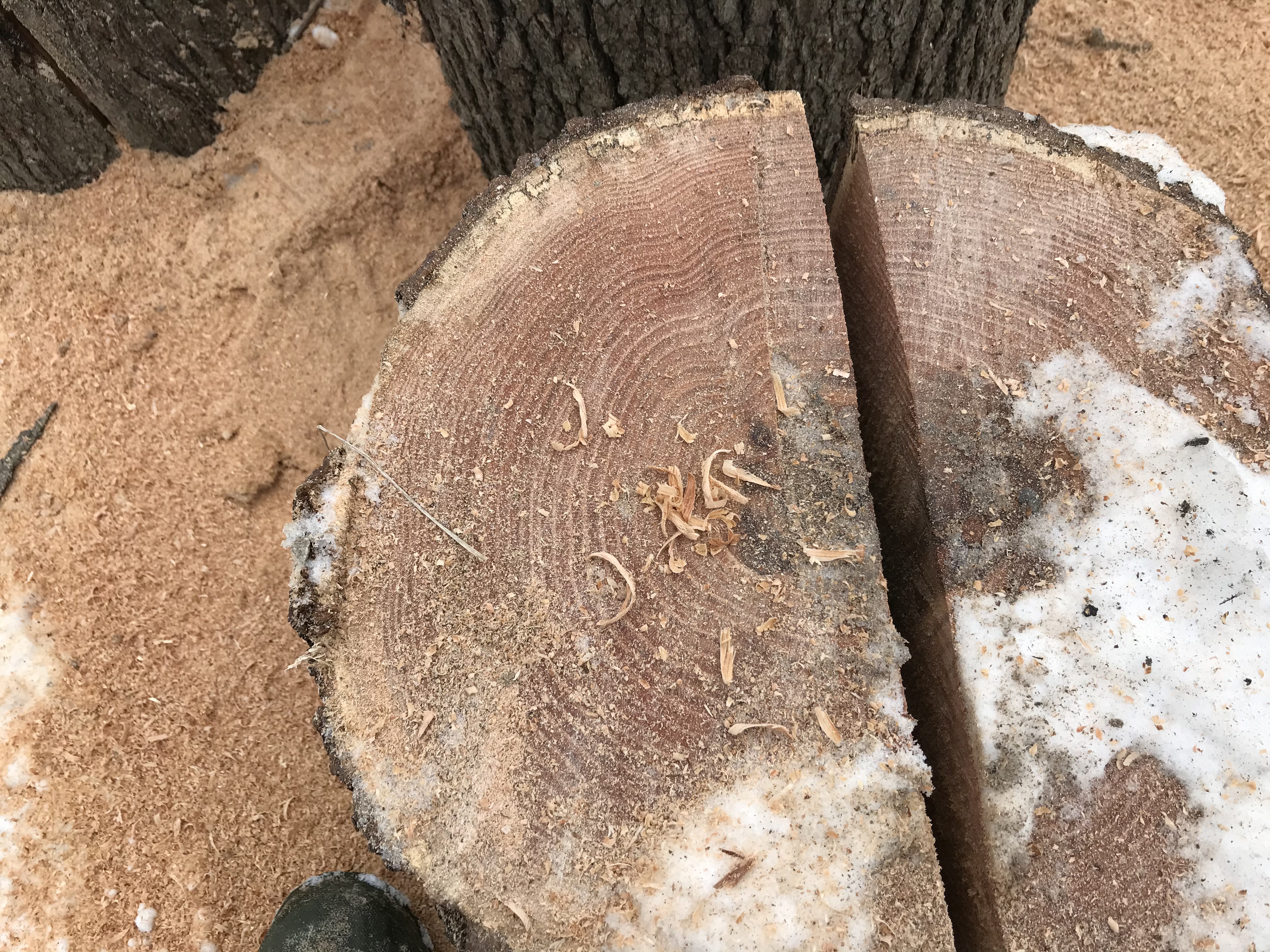

So I did some noodling that last couple of days. Larger rounds that are a little too much for me to lift on my splitter. Yesterday it was cutting O.K. but a mix of sawdust and chips, no nice big noodles but it was cutting decent. I had just sharpened the chain to. So I checked the rakers and they were a little high and I filed them down. So today I did some more, first cut was one that was cut most of the way through yesterday so I flipped it over and finished the cut by working up from cut, in other words cutting up instead of down. I got nice big noodles and it cut great. Then i started a new one and it seemed I was making sawdust again cutting down.
Not sure if I am making a mistake sharpening. It almost seems to noodle better lifting up. It seems to make normal cross cuts fine. Stihl MS 261.
The pic is from yesterday and is about all the noodles I got. 3406A545-09BF-4E64-8F81-4FE2290DCBFF.jpegDC056D41-6B8E-4574-8E64-EE300A387AE0.jpeg

Are you cutting across the top like they’re laying in the picture or cutting along the bark side? It works a lot better cutting with the grain vs the end grain.

I’m not sure what your asking. The first picture shows how I cut them, just like they are sitting.

I agree but people do use them for cutting with the grain. I have done it before and you get long chips, hence the term noodling.

Try flipping them on their side and cutting that way. It works a lot better that way.
/ Sharpening wrong #11
Yeah, it's not noodling unless you cut on the side. You'll see a huge mess of noodles as it pulls out the length of grain rather than cutting the ends of the grain off. :thumbsup:

I believe what you are referring to is called ripping chain. Used with the chainsaw style sawmills. Normally a full chisel type chain that is sharpened at a 10 degree angle as opposed to the normal 25 degree used on full chisel style chains. years ago that made a ripping style chain that had fang type side rippers and I remember correctly the cutters where sharpened straight across.

Most of the ripping chains are also "skip tooth" which allows more space for the noodles (new term to me) to clear the cut.

There’s no need for a special chain if you cut from the side.

When noodling, the angle of the bar (just a few degrees either way) can mean the difference between dust and noodles. That is normal behavior. In fact, you can take advantage of that by gently changing the angle while cutting. The dust will help clear out noodles from the clutch cover and keep it from getting plugged.
Of the dozens of saws I have owned, the 261 was by far the worst at noodling. Just too tight under the clutch cover compared to the saw's power and ability.
