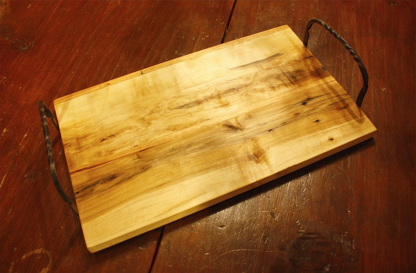

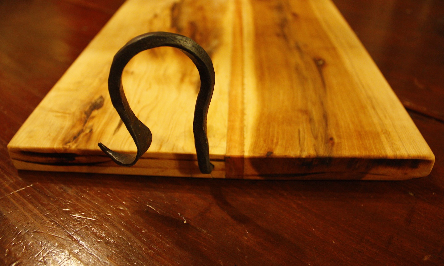

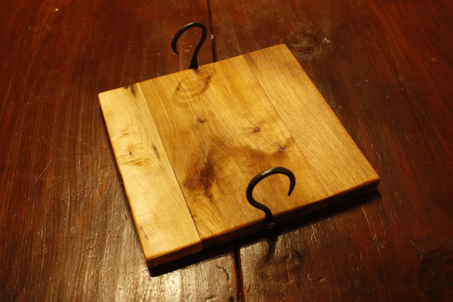

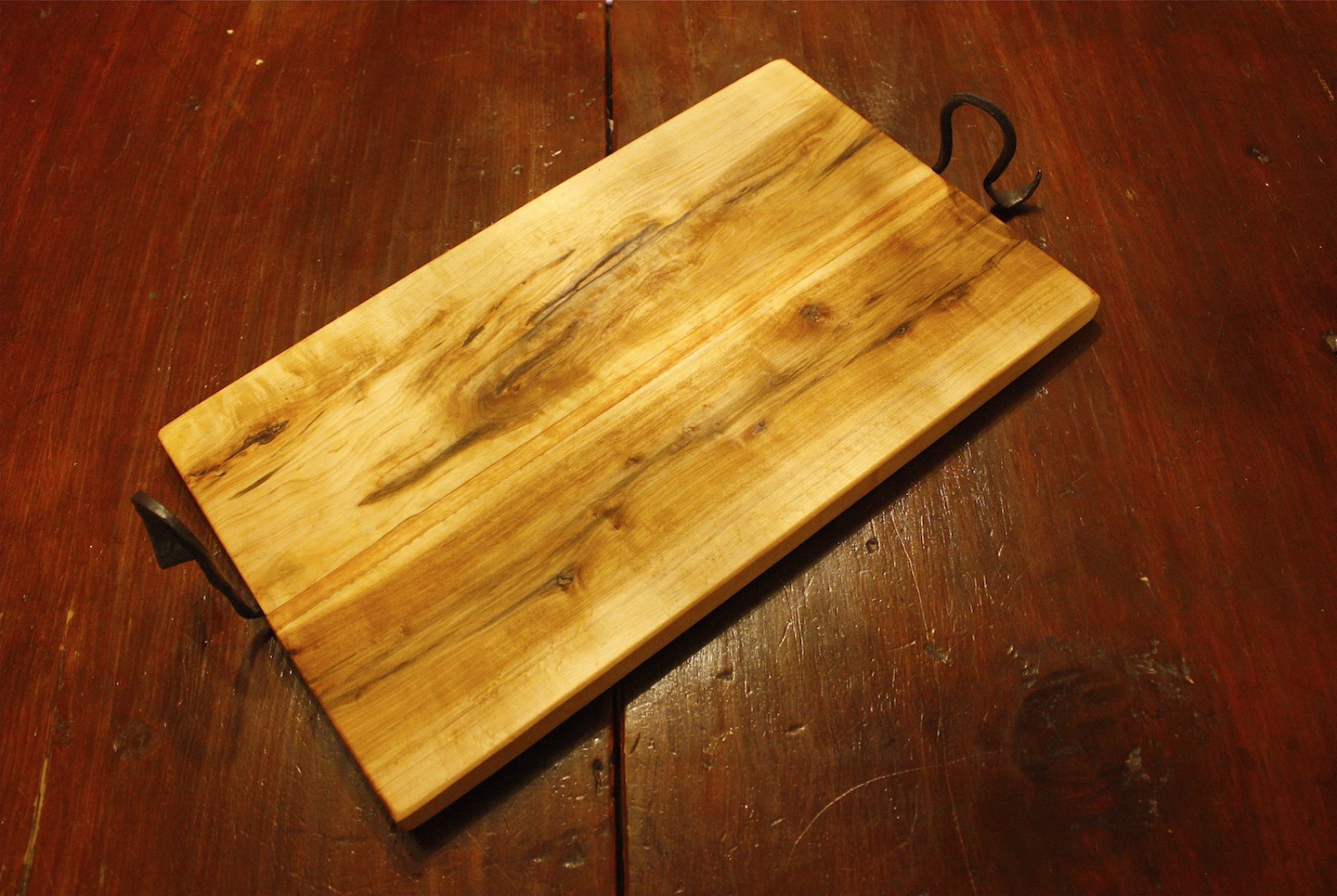

Great Job!!! Love the handles on the trays.

What are you using to seal the trays? mineral oil and beeswax?

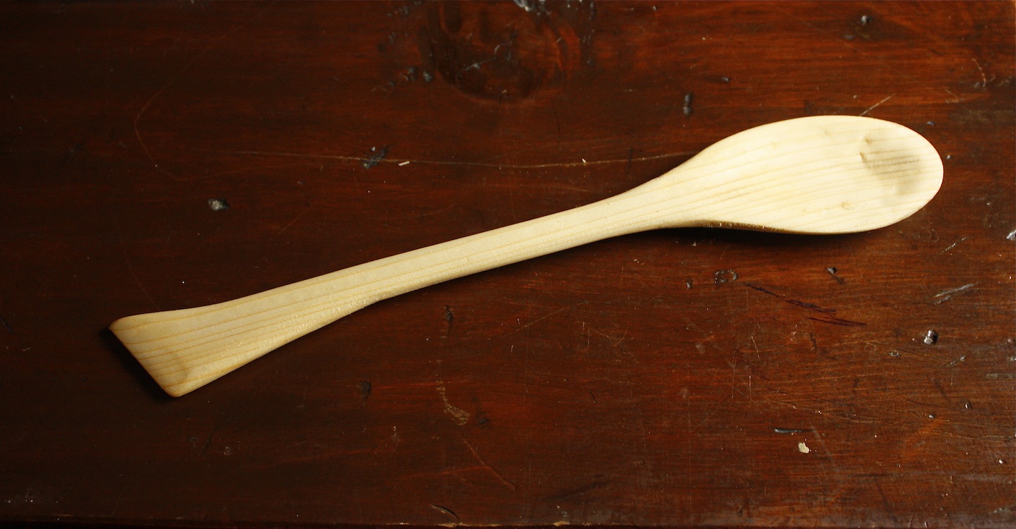

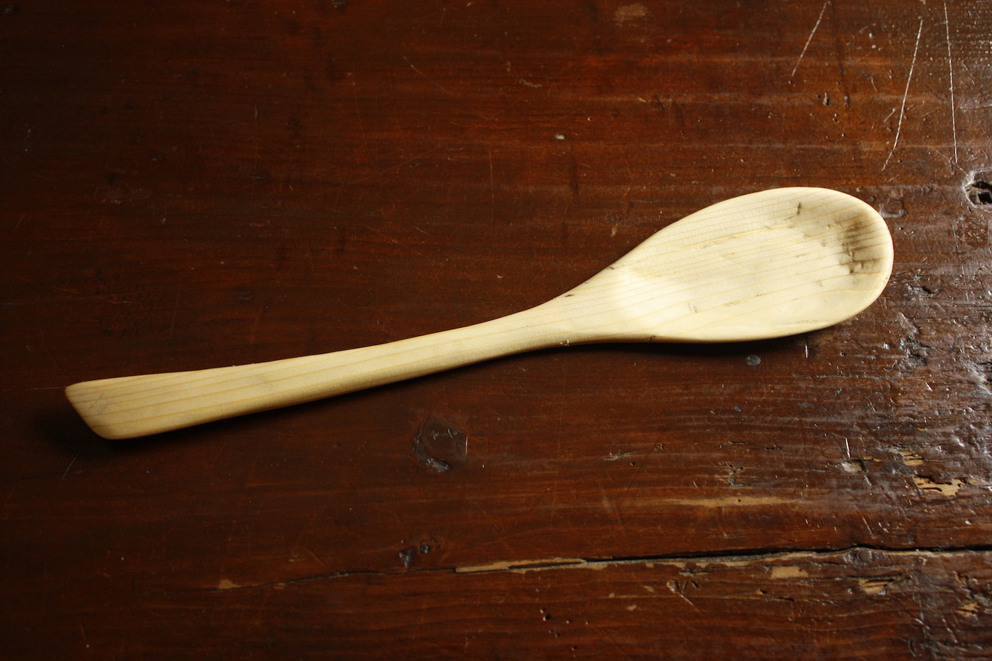

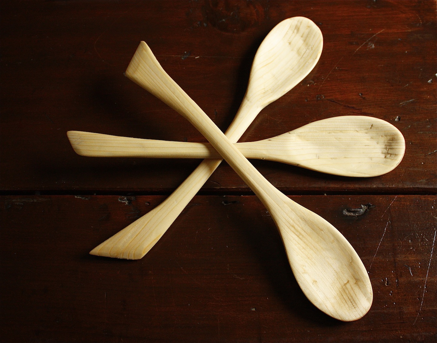

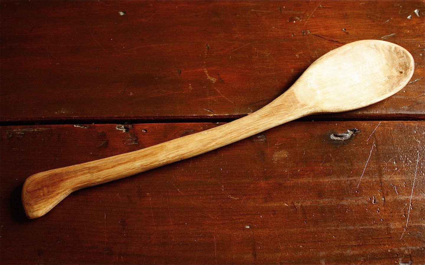

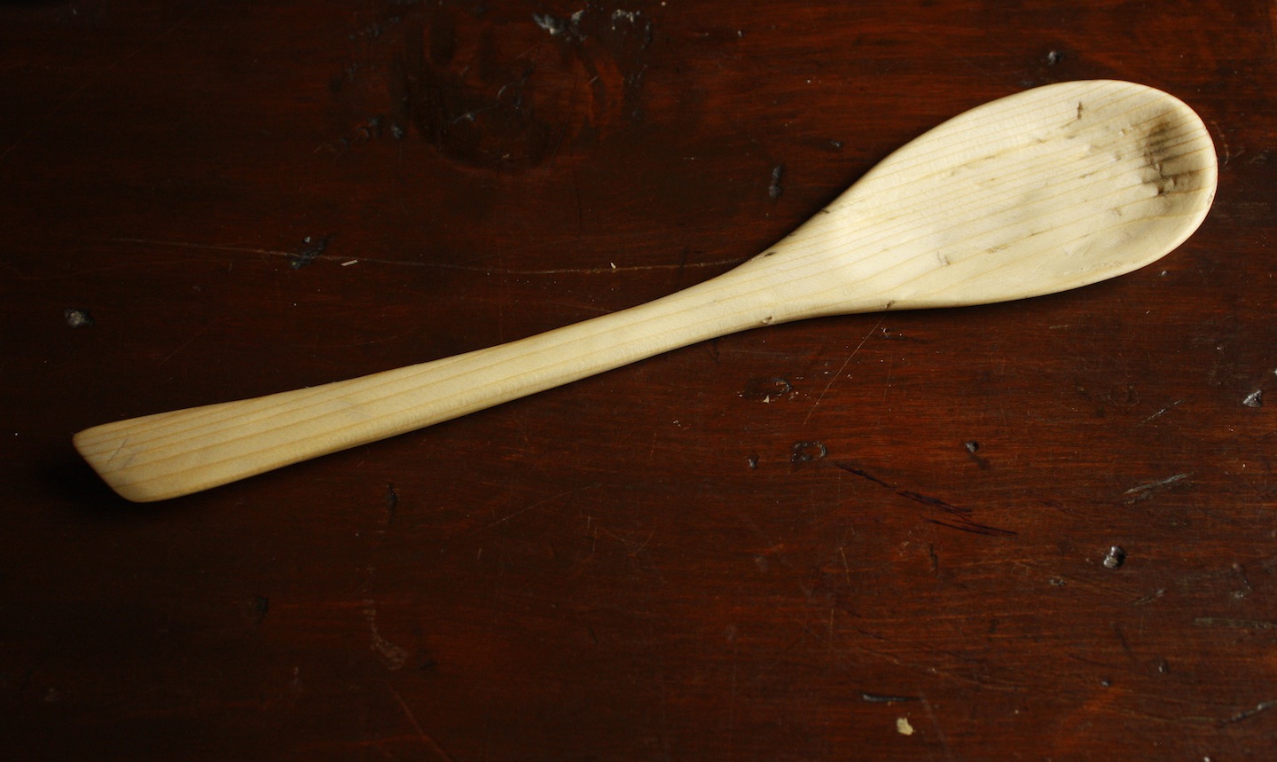

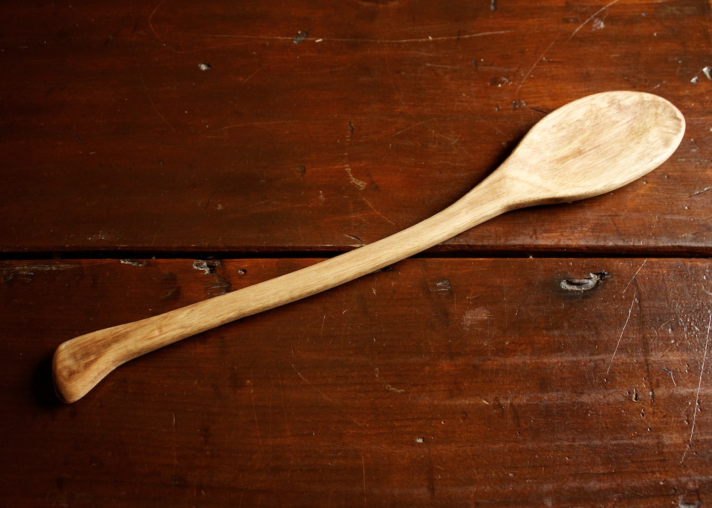

Lloyd I am glad to answer any questions. I know what I did wrong in the beginning and I am still learning/refining what I do. I also can recommend tools/blades/etc. I try to carve one spoon a day, January was great I was doing 2-3 a day, but Febuary with the snow has done me in a bit. I finally found some birch to carve I made this a few weeks ago. Its pretty large, about 13'' long. Finished with organic flax seed oil. I have been moving to this since it will seal and polymerize in the wood vs staying a liquid like mineral oil.
front
front (the knots in the bowl caused a lot of issues)
back

fb - thanks! I do have some organic flaxseed oil! Are you carving all green wood? 1 spoon a day - are you serious. I couldn't get organized to do that let alone schedule it!
One of the biggest issues I have is always refining materials to perfect finish. The carving marks in your work speak about the wood, craftsmanship and organic nature... I need to learn to know when to stop and or go back to school! Just beautiful! Also, you "see" the piece before your carve. I spend too much time thinking about it and how to get into a time managed production run!

Refining materials: to sand or not....I first started off sanding, not one mark left and then realize what was making my work any different from a china made mass produced spoon? Nothing. So I began leaving the marks, and people were drawn to them. I myself love the light and shadows that come from it. I hold every spoon like I am going to use it and put little facets in to make a gripping point.
What I am currently working on is leaving lines in a pattern instead of just leaving them...if you know what I mean, being more in control of the line.
As for seeing the piece, a spoon is an exercise in 3d modeling with complex curves both convex and concave along with the limitations of the media such as grain etc. I do everything I can to help with seeing the spoon, It took me a year before I started getting things. Just yesterday I was trying to copy a spoon I have and learned some new things. I do a lot of template work. I cut out shapes in thick paper and work on proportion of the spoon, handle length etc..plus you can move the paper around to get the crank of the handle. Even though many of my (most if not all) spoons look different many start from the same template. I just at a point let the wood go where its going to take me. Apple is one of those that will knot and twist and take you someplace interesting. Its not easy but if you plug away you learn bit by bit.
Production wise I know (i keep spreadsheets of what I sold how many etc) what i need to have carved for the summer craft fair season, I also know I want to keep adding new items to my product line. So winter means cracking the whip and carving. What I do is rough out blanks with my ax, (they are frozen at this point) in the morning before I go to work, when I come home and after dinner I carve the blanks are still chilly but green (yes green carving if carving when dry please wear a dust mask the irritation is horrible) and I carve while my daughter and dog run through the shavings :0 then i put them in a pie tin with wood shavings to slowly dry, by Saturday I can go back in with my knife to clean up anything I then sand with 400 grit, knocking down the edges and leaving the facets and Sunday I oil. If I need to paint I paint then too. Its just finding a rhythm, yesterday I was able to carve 2 ladles, 2 serving spoons, and 80 plant markers.
