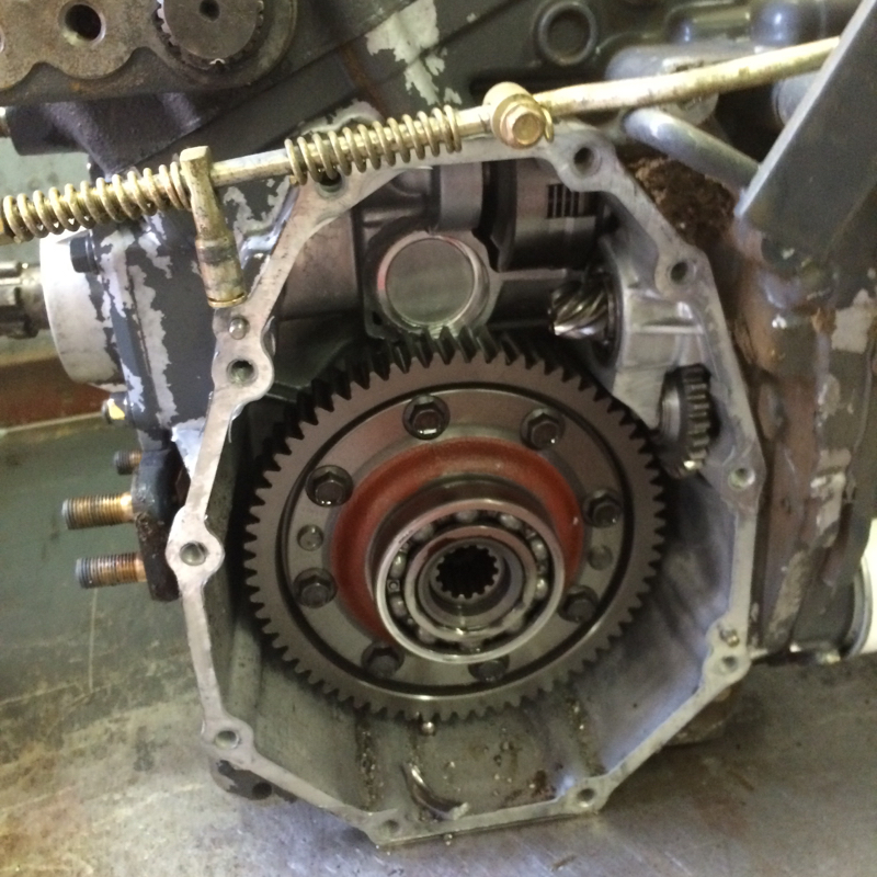

Diagnoses broken pinion shaft took out pinion bearing destroyed case 4500 to 5000 to repair she's gone I'm not fixing.trading it for a b3300 with loaderbh 77 with thumb and 7000 lb farmi logging winch my cost 22000

did you get a pic of the broke case for us?

#34
Yes right where bearing sat

See grindings in btm

Gosh like seeing car wreck
