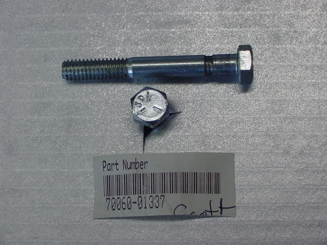

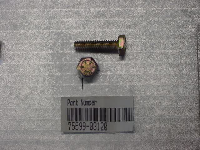

On the M-F front-mount blower (identical to Kubota's SCUT blower, I believe), OEM parts are a single-grooved grade 8 for the fan and a double-grooved grade 5 for the auger. Even "color-coded." I've also been told that a plain old grade 2 is acceptable for the auger....
I think I've also discovered that over-torquing will result in more sheared bolts-- "9 ft-lbs" isn't a lot of force, but that's what they call for.
I was just cranking them right in there, I suspect quite a bit more than 9 ft-lbs. They were snapping right & left. Since reducing torque to just enough to compress the lock washer, I haven't broken one yet. Does this make sense, or am I just imagining things here? Anybody care to comment on this?

ok here are the pics with Kubota part numbers.
