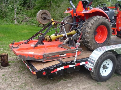

Thank you for comments. Both have excellant points regarding buying new vs clutch. I am a suburban slicker trying to make in the country. I contacted Howse and they believe that the shear pin yoke has been worn out and allows to much movement. My opinion is how could that be if I am only putting in pins that I got from them??? They also said that the yoke is made of cast iron and would certainly be destroyed way before I could hurt the hardened steel shaft. Well that aint true cuz my gear box shaft looks like a dried up friggin burned up BBQ hotdog. Now my problem is I cant get the whole friggin thing off of the gear box shaft. I know there has to be some piece of chewed up pin keeping it on. I have knocked the old out. Cut a belt sander pad in half and polished that shaft to a hue but the yoke wont come off? I can slide it all the way to the box and all the way to the front of the shaft but it wont come off. The safety clip on the front of the shaft has been removed. #$%^&*&^*$%#

I agree it sounds like you've got a burr under there to overcome. I think I'd start by aligning the holes and look for obviously displaced metal. You might be able to get it with a drill bit. If not, you might consider using a wooden block to stop the blades from turning. Then put a cheater bar through the two yoke holes and try to turn the burr off. But again, this won't work if your tranny shaft is splined. I'm still waiting to hear if yours is splined or smooth.
But I don't think you got the right impression of my comments above. I absolutely positively am not suggesting that a shear pin type PTO shaft - new or otherwise - is better than a clutch type shaft. In fact, a slip clutch type for your application is superior in all regards - smooth or splined. I have several PTO shafts; some with slip clutch, some with sear bolt, some smoothbore, some splined. My point was that a splined clutch attachment is superior to a smooth type, in that the splined type completely removes shear bolt from the equation. The splines are the clutch stop. On a smoothbore type, one single bolt is the clutch stop, brining us back to the shear pin concept. Unless properly matched and adjusted, that retaining bolt may itself become a shear pin - breaking before the clutch slips.

Im sorry. I dont understand what you mean by tranny shaft. If you mean the shaft that comes out of the cutter gearbox, that is smooth. If you are talking about the shaft of my drive train, that is a rectangle, I know most are square. If you are talking about the pto shaft from the tractor that is splined.

The box that sits on top of your rotary cutter is its transmission. Sorry for the colloquialism, but that's the "tranny" to which I referred. Now I know that - if you decide to go with a slip clutch PTO shaft - that it will have to be smoothbore on the implement end. That in turn means you'll secure the slip clutch to the "tranny shaft" with a bolt, which - if the wrong grade is selected - will once again put you back in shear bolt territory.
