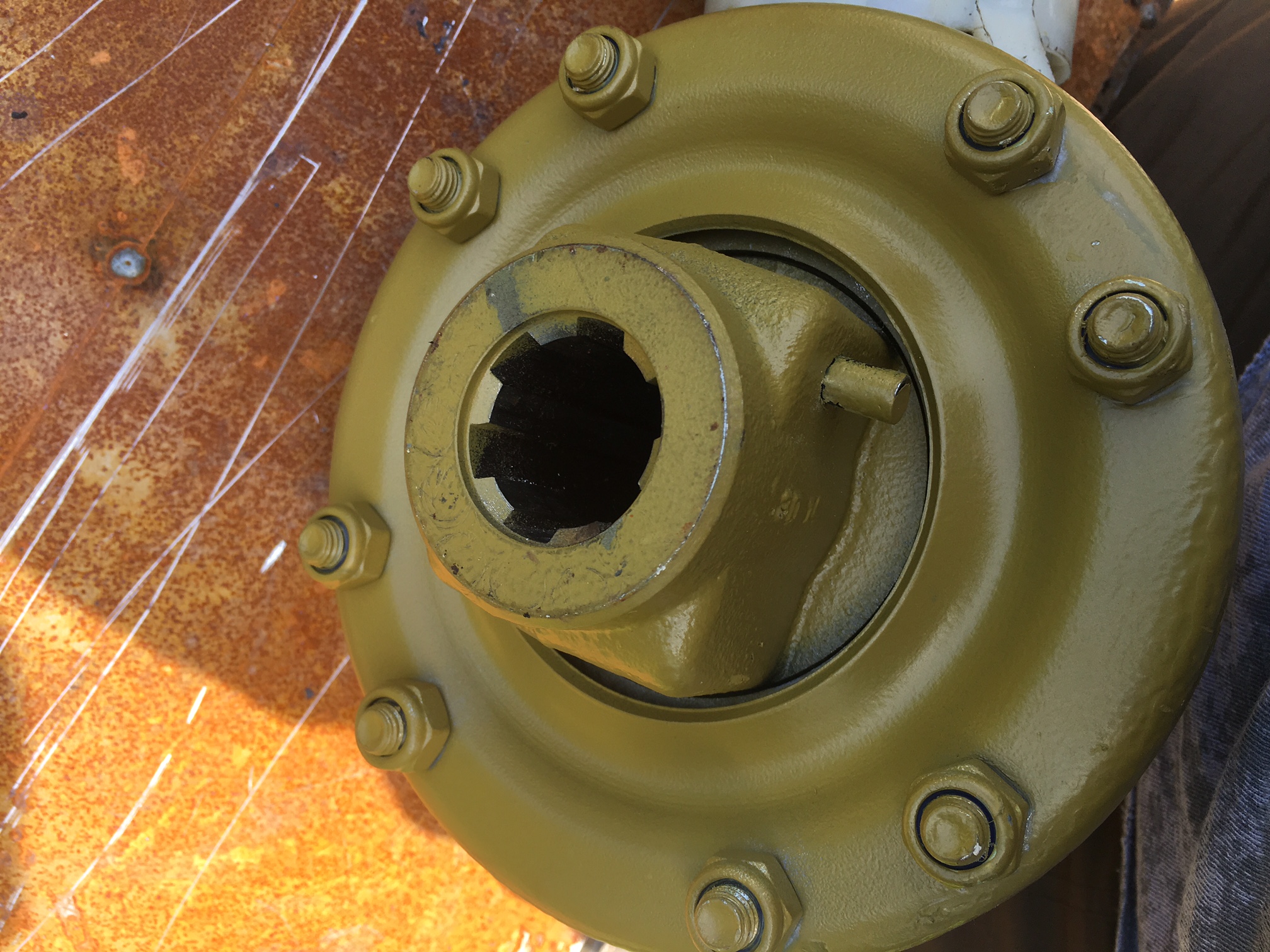

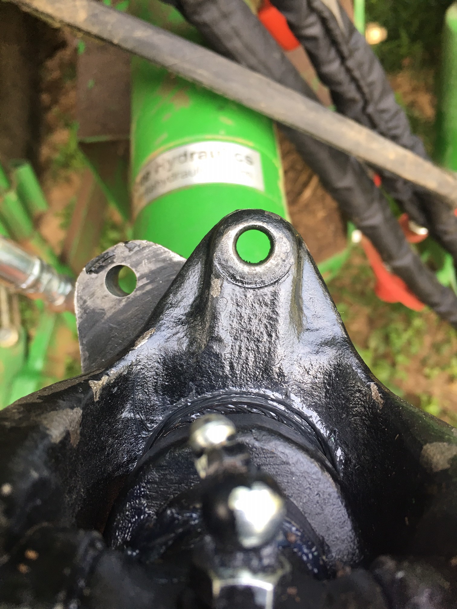

It might just be me, the the holes for the shear bolt do not look the same size, likely just the way the picture is showing it, but critical that the bolt fits with no play in either hole. Any play will allow the two parts to start working on the shear bolt and before long, it fails all the time.
   / Shear pin misery... only thing left is adding a slip clutch?
#25
hawkeye, they are the same. That must just be the pic. I can get it tight, and without any movement. But, the shaft is by definition to small for the HP of the tractor and the machine.
I'm going to look for a new shaft with a clutch. Perhaps a new shaft with a shear bolt of the appropriate size will work as well. But I know that this shaft is a Series 3 which is for HP of 20-25hp. At least according to the U-bolt measurements. At least according to this PDF.

I am extremely limited on what I can add as far as size of a bigger bolt. There simply isn't very much 'meat' to drill out and maintain integrity.

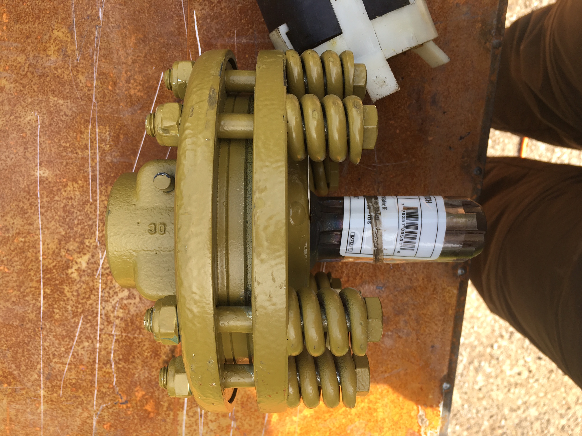

If I try to weld it (and I'm not sure whether it is cast steel or iron) and add an adaptable slip clutch at the machine, will that 'work' as far as protection of the tractor? I was able to find a slip clutch at TSC which slips over the shaft at the gear box, and onto which the PTO shaft can be attached. At least that is what it appears to be set up for. I thought, perhaps if I weld the 'shear pin pieces' together, then I could still protect things with the clutch. Any thoughts about this?
The only other thing I can do is to purchase a completely new PTO shaft with a slip clutch integrated already. This is probably what I should do. Get a new PTO shaft Series 6 or 8 with a CV joint and a slip clutch. I am sure this would cure 'all' the problems which have arisen.
IF anyone has a recommendation on where I can find such a shaft collapsed length of 72" with at least 18" working expansion, please link me or give me a name. The length that is required is making it difficult to find.
View attachment 514948View attachment 514949
Even using a slip clutch will require you to fine tune the clutch setting so it's loose enough to take the start up torque loads and still function when your just cutting. I have a 6 ft rotary cutter with a slip clutch and I use a ORC to save the pto clutch on my tractor. I always start the mower at idle to minimize the shock loads on the tractor PTO system. I don't know why you think that's a hard thing to do. Once I start the cutter I keep it running until I'm done mowing, throttle back to idle and then disconnect the pto. the ORC doesn't allow the rotor inertia to feed into the pto clutch. Most of the vibration I encounter is due to the unfolding of the cutter blades ( they fold during shutdown due to the stopping inertia). A larger shear pin or a slip clutch are your only alternatives. Flail cutters, if balanced correctly, are probably more vibrationless that two bladed rotary cutters.

Before you do anything, maybe you should see if your problem goes away simply by engaging the PTO at idle.
If not, you could drill a second shear pin hole that might be just enough to hold and still offer overload protection.

Better that the OP gets a slip clutch. He's engaging under power. Bigger shear pins will just move the shear point--To the tractor parts most likely. :rolleyes:
