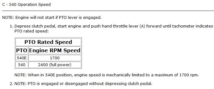

JD instruction manual says to push RPMs to 'PTO speed' prior to engaging PTO.

I can see how you could some to the conclusion but they aren't being very clear. PTO should only be engaged at the minimum rpm so the tractor doesn't stall. Anymore and your cooking your pto clutch and impliments. Take the 5 sec to idle down, engage pto and bring it up to rated speed then.
It will be much easier on your equipment and you don't want to deal with a bad pto clutch

Yes but it doesn't say pop the PTO into engagement at full RPM. That just doesn't make any sense. When we used to all drive stick shift cars did we wind the engine up to freeway speed and then pop the clutch?.. well some of us did that as teenagers, but we usually weren't paying for the repairs. No we came just off of idle and gently engaged the clutch with the minimum "slam bang" needed to get the car rolling and then we increased throttle gently.
Things that are in manuals are not always clear, and keep in mind the guy that wrote the manual, likely has never operated a tractor.

I do not bring it up from idle. That is not a feasible situation in my real world. I cannot idle down every time I want to begin mowing.
I have no strange noises. Everything begins and appears fine. It begins spinning, and everything is smooth, but I think the stress of getting all that metal moving simply overcomes the shear force of the pin.
