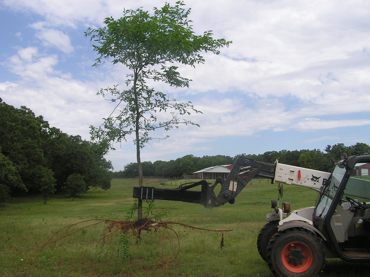

I recommend renting a skid steer and a tree puller.
No stumps to deal with that way.

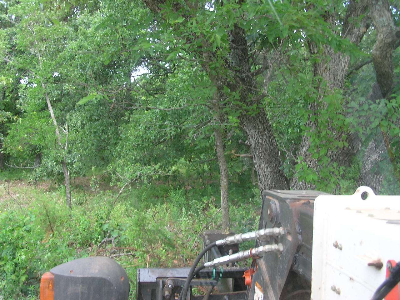

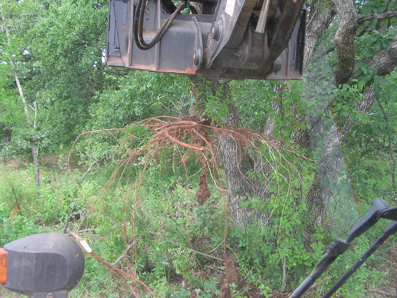

This is what I use, but doubt if you could find one to rent: Tree Puller?
/ Shear vs tree saw
Ive got a tree puller and skid steer. It does ok till the trees start to get larger then there’s some time spent rocking back and forth breaking it loose. And the trees I need down are in clusters.
