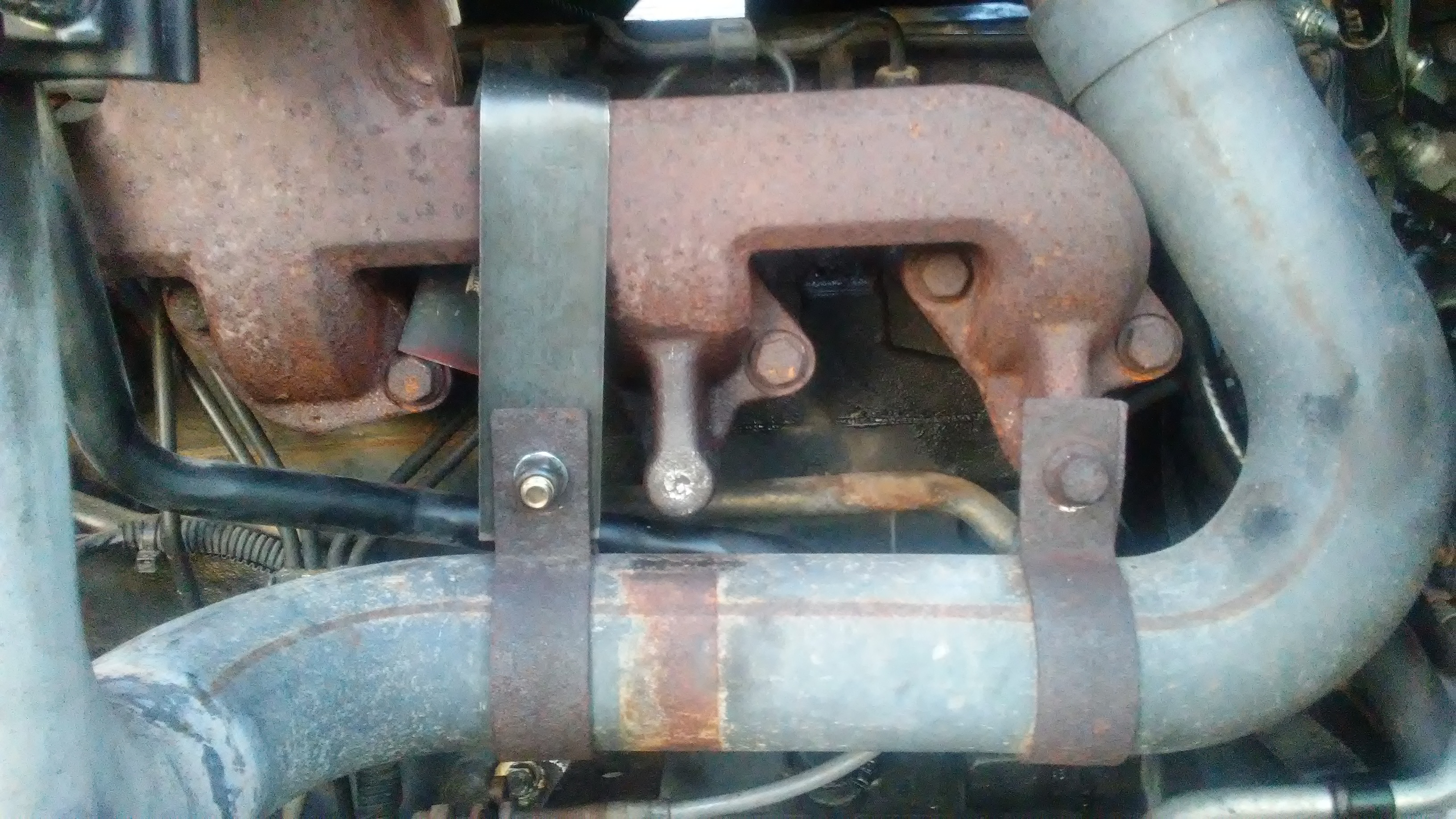

Maybe I wasn't clear. The hole is drilled, The part is heated RED and the easyout applied. Just a cheap junky one. I do like the welded on washer better though.
It also depends on a mans resourses. People ask for help but don't say what they have to work with. Probably, if he had all kinds of fancy resources, he wouldn't be asking for help.

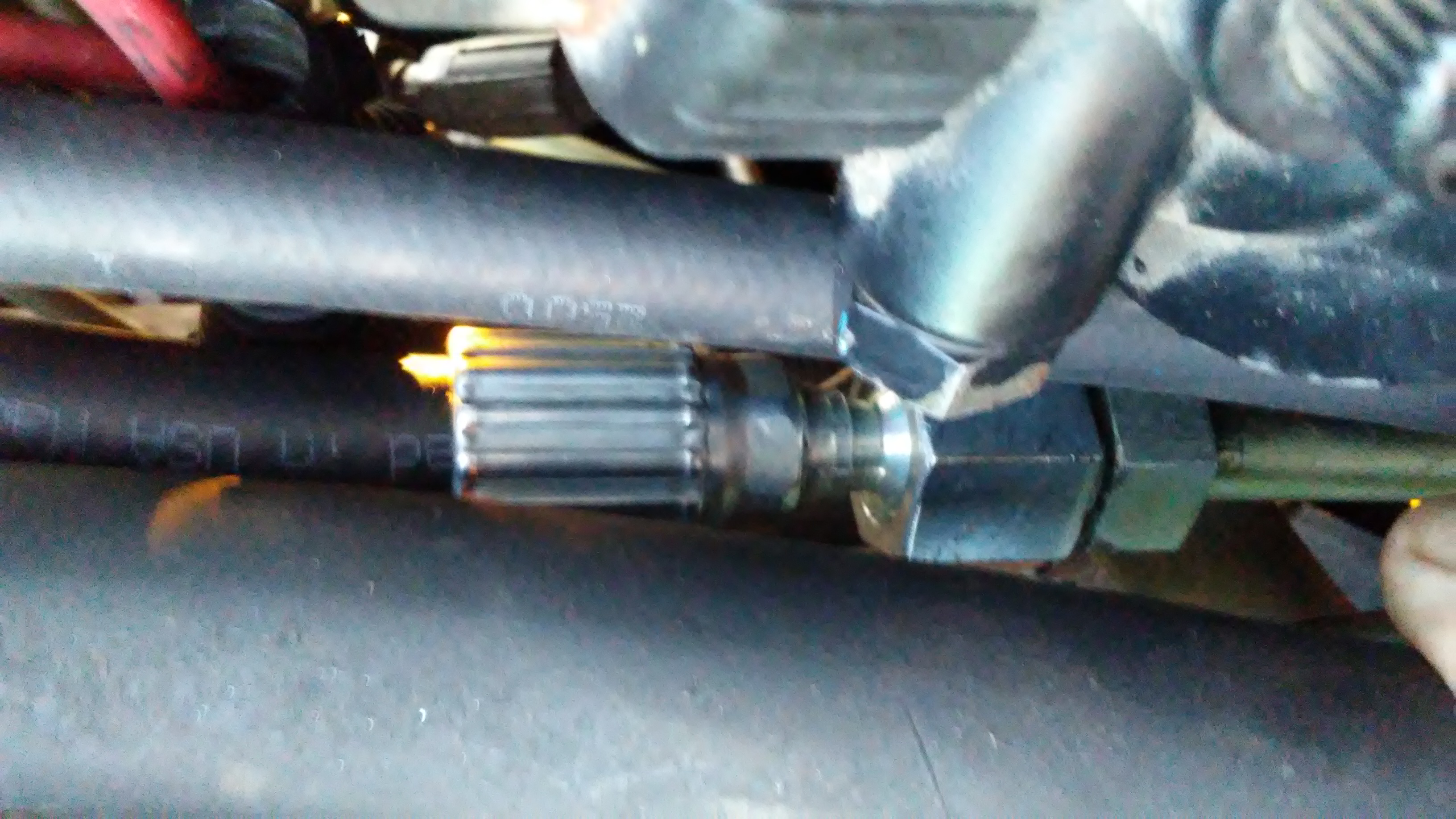

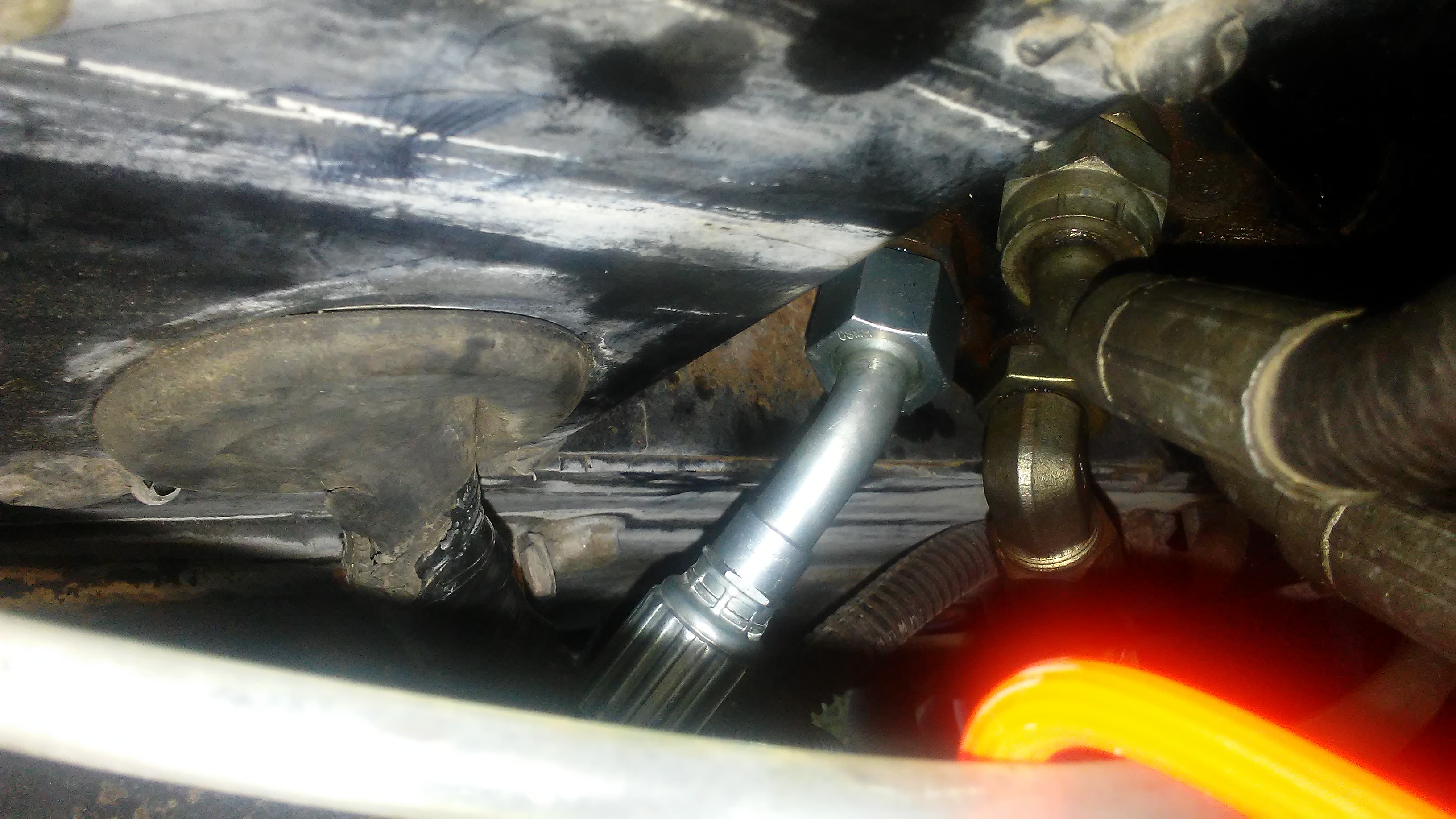

Good news; bad news; can live with it for now. I got the steering return line made up locally and got it installed with no leaks in the original orientation so that it no lower rubs on the hood support bracket which caused the original abrasion leak. Then worked on the sheared off bolt after make-shift soak bath in a penetrating oil. Tried a counter-clock-wise small chisel, carbide, titanium and left handed drill bits, ran the tractor to heat the manifold, allowed to cool. Tried everything again. No luck on the bolt. For today, with the sun setting, wind blowing and temp falling (both outside and beer) and salmon on the grill.......I hammered out a strip of sheet metal I had to mock up a temporary support and shut it down for the night. A buddy boasts about his welding prowess both torch and mig. If my make-shift support rattles or allows too much play I'll invest more time on getting this
stubborn- A_ _ bolt out. For now....I'm operational. Thanks for all the recommendations.

I re-read the op's first post several times before I formulated my reply. I fully realized that he was "not equipped to weld" I went with my recommendations anyways because this is not a fool around type of job. Last I checked welders were portable and so are tractors.
My recommendation for wax is because I love the way the heat draws it in around the threads.The bolt cools and the wax just flows right to the bottom of the threads.

Get the manifold hot with a torch then use a mig welder and build up the broken stud enough to reverse it out with a nice sharp pair of Vise Grips. If the bubble gum breaks off simply pinpoint your mig gun and hit er again. Practice makes perfect.
I do this all the time in the land of salt.
Looks like it's not to late to save the green machine.
Regards and good luck, Fred
