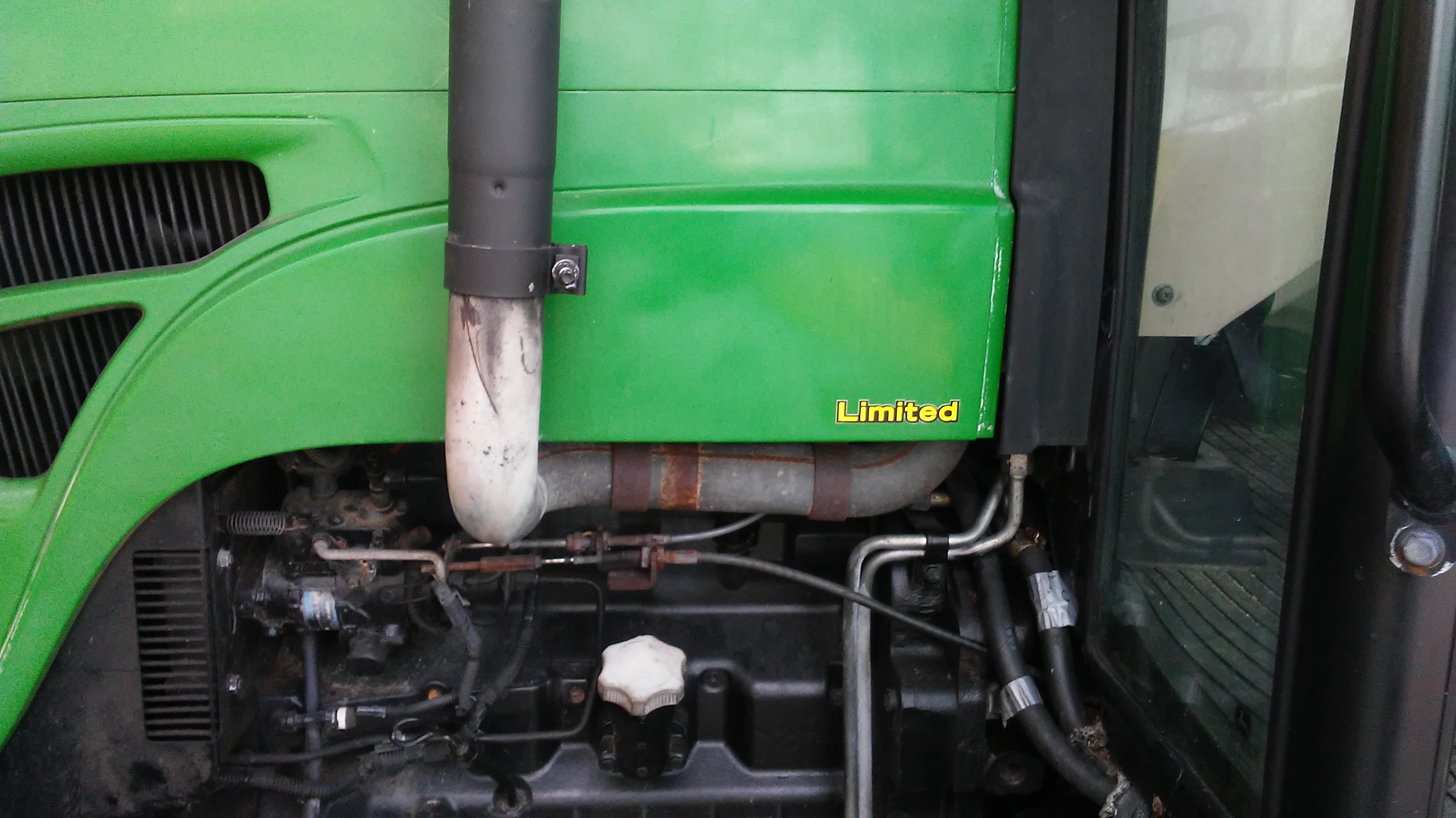

Hey pmsmechanic check the picture with hood down and thanks!

Tractor time: Pulled around a box blade for the drive that was liquified by recent rains. Low RPM. All good no leaks. No muffler brace rattle except at start up. Here is a picture with hood down. ACCEPTABLE. But when I get motivated you folks provided a lot new ways to attack this bolt. Thanks!

Looks good! If you get tired of the rattle a few dabs of high temp silicone (red/orange) will quiet that up.

Started a post in JD Ag tractors replacing a steering line then I snapped off the bolt on the left hand side in the picture. I've tried to drill out out, extractors (broke 2 of them) and it's soaking in penetrating oil overnight. Will try chisel tomorrow. Anybody got any voo-doo solvents to get this very rusted bolt removed? Not set up to mig-weld a nut nor is there really enough the bolt proud of the manifold to thread anything. Thanks in advance for recommendations.
I know you're not set up to mig weld. That's unfortunate. I had a similarly broken exhausted stud on my Kohler engine back in September of 2017. It broke flush with the manifold, so nothing to grip. I put a slightly oversized nut over the stud hole, and fired the wire feed into the nut onto the stud. Just a few very quick trigger pulls. Let it cool for just a couple seconds and backed it out with a wrench while it was hot. Came right out.

See if you have a friend with a 110V wire feed welder. It really does work well.

Quick question. I have seen people weld the nut right in and others use a washer and a nut. Why use the washer?
   / Sheared off bolt for muffler brace into exhaust Manifold #29
Weld the washer close to the block and more heat will go into the stud.
   / Sheared off bolt for muffler brace into exhaust Manifold #30
If there is a half descent piece of stud sticking out to weld to I don't bother with the washer. If the stud is broken off flush then it's easier to do a good job of welding on the washer first.
I don't have a mig welder otherwise I might just skip the washer part. I've also just welded on the washer and used a good brand new pair of Vice Grips and not bothered with the nut.
