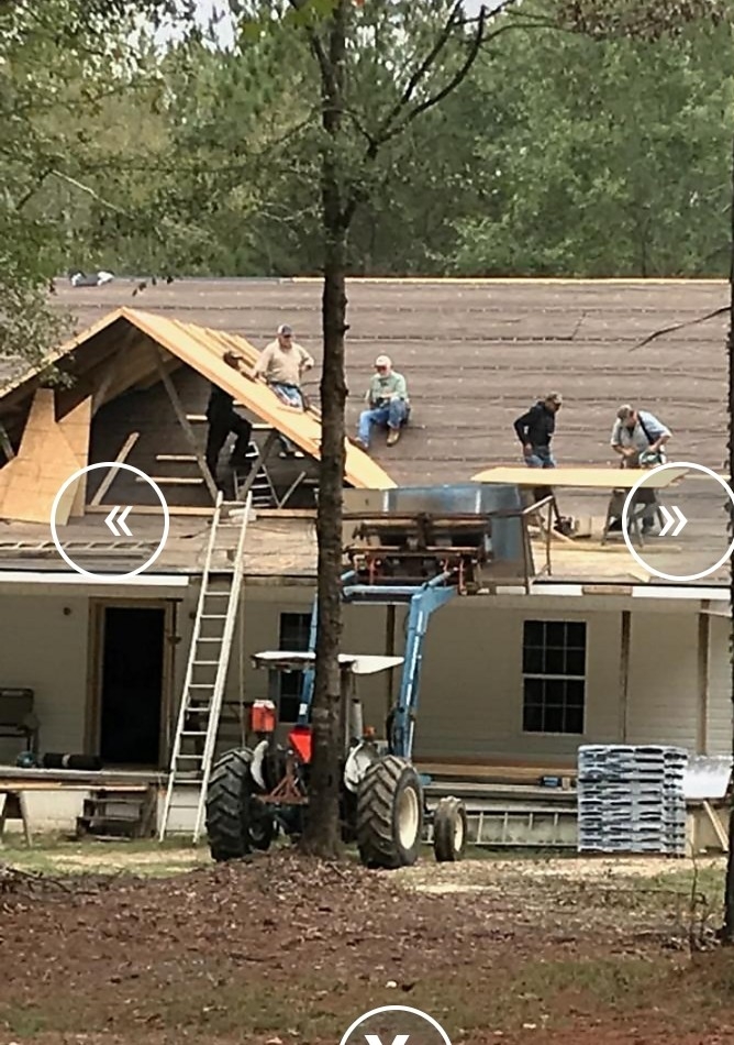

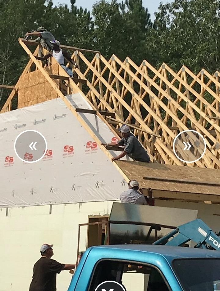

I've never seen a house built with the roof on before the walls are sheathed.
For that matter, I've never seen roof rafters or trusses put on a house before the walls are sheathed.
Pole barn maybe. Garage stick framed, never.
Notice I'm in both pics, no braces outside the structure.
