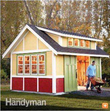

If you check out the Family Handyman website, they have a section on sheds that include schematics, framing diagrams and materials lists.
Shed Plans: Storage Shed Plans: The Family Handyman
I'm thinking about using a slightly modified version of their 2011 model for my next shed project, but without the elaborate paint scheme.
Here is the shed diagram and materials listing:
Building Plans and Schematics
Materials List
Excellent, thanks!
