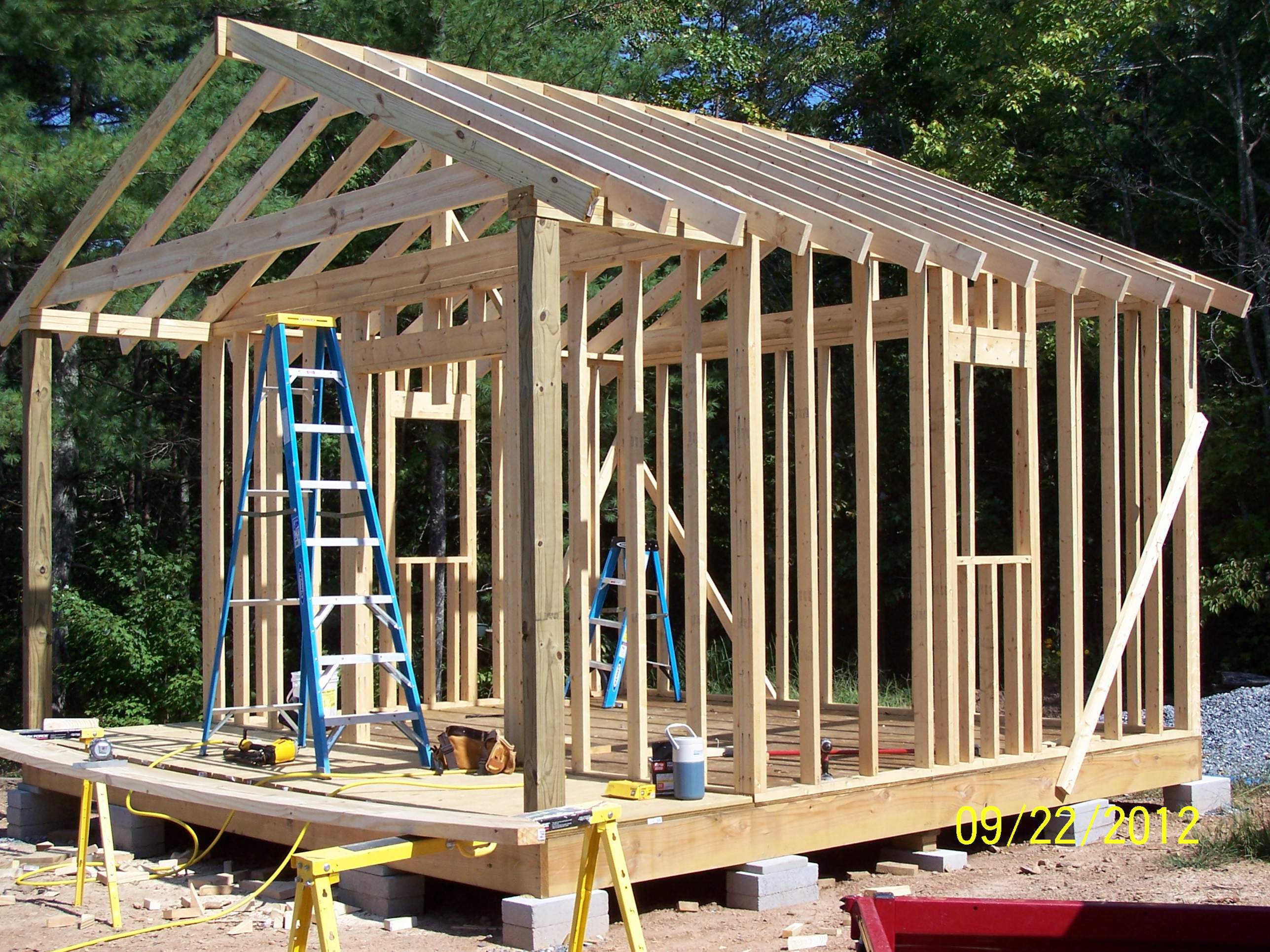

I build this myself for around $3500.00. The enclosed part is 12x16 with the full footprint being 16x16.

Check your local lumber yard. Around here they stock factory made trusses at very affordable prices.
Generally 10', 12' 24' 16' and even 20' 'shed trusses' with pricing very affordable like as low as $12-15 up to $50 ish.
The specs being less than for a home.
No way can a guy match prices. Believe they make them as a fill in work basis and during off seasons.
I have used them often and very satisfied.
To keep costs down I use 2 x 4 studs at 16" and nail Canexel directly to the studs. Same could be done using Hardee siding.
I brace my corners with the metal 'T' bracing.
There are more than a few that I made this way and most are now over 12 years old and we are in a very heavy snow fall area
When a garage door is involved I face the inner door wall with plywood to prevent any swaying from side to side.
In one case we had metal siding available so we simply used furring strips at 16" centers.
On a few car sized 'sheds' I simply had a load of 3/4" gravel dumped and carefully spread and leveled.
For my 'foundation' I laid out railroad ties on top of the crushed stone and simply mounted my 2 x 4 stud walls on them. Every so often I'd drive 2-3' rebar pins into the ground to 'lock' the structure in place with more near the doorway.*
I built such a garage* for my mother this way for an 'out of pocket' of $1000. or so.
OK, so I had a deal for Canexel 'seconds', but nothing that is visible.
*Doing snow removal I accidentally caught a corner and other than a missing chunk nothing moved one inch and the electric door functions normally.

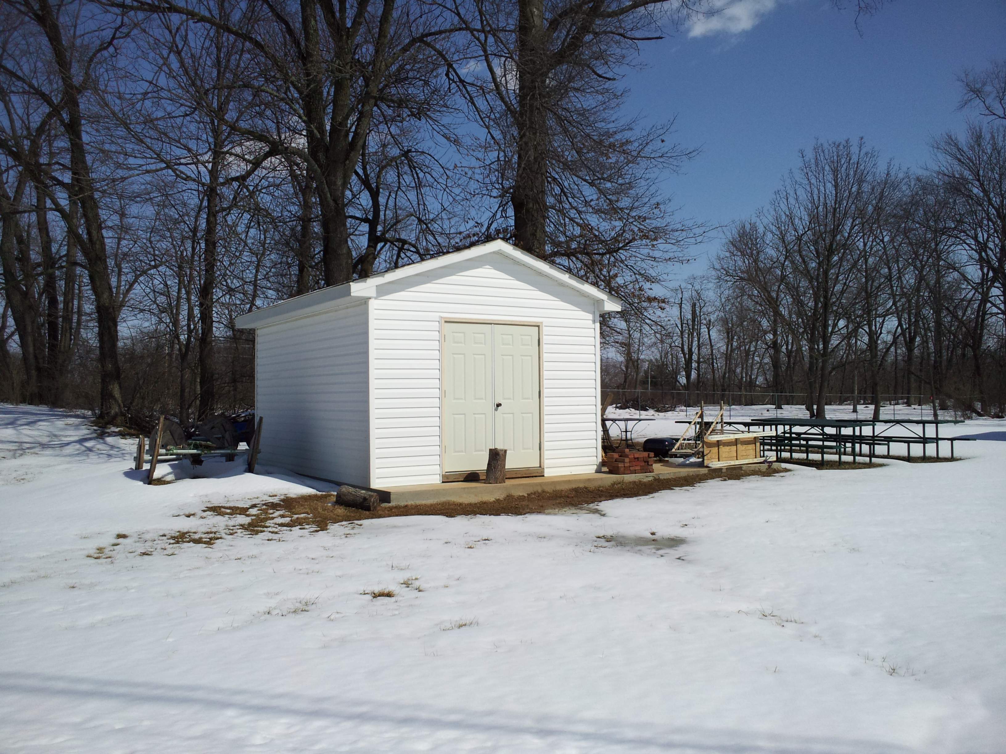

I built my 12x16' shed for around $1200, course it's be a few yrs ago. Very similar to your picture and with shingled roof. Very easy to build. I parked my little massey ferguson in it for years before I built a pole barn.
Our code allows 120sf without a permit, but I was building my house at the same time and the inspectors ignored my shed being a little larger.
Kits are good also as they figure out the material for you, or at least come close. I helped build a shed kit for the boy scouts,it didn't come with plans but we figured it out with the material we got. Here is a pic of the scout shed.
