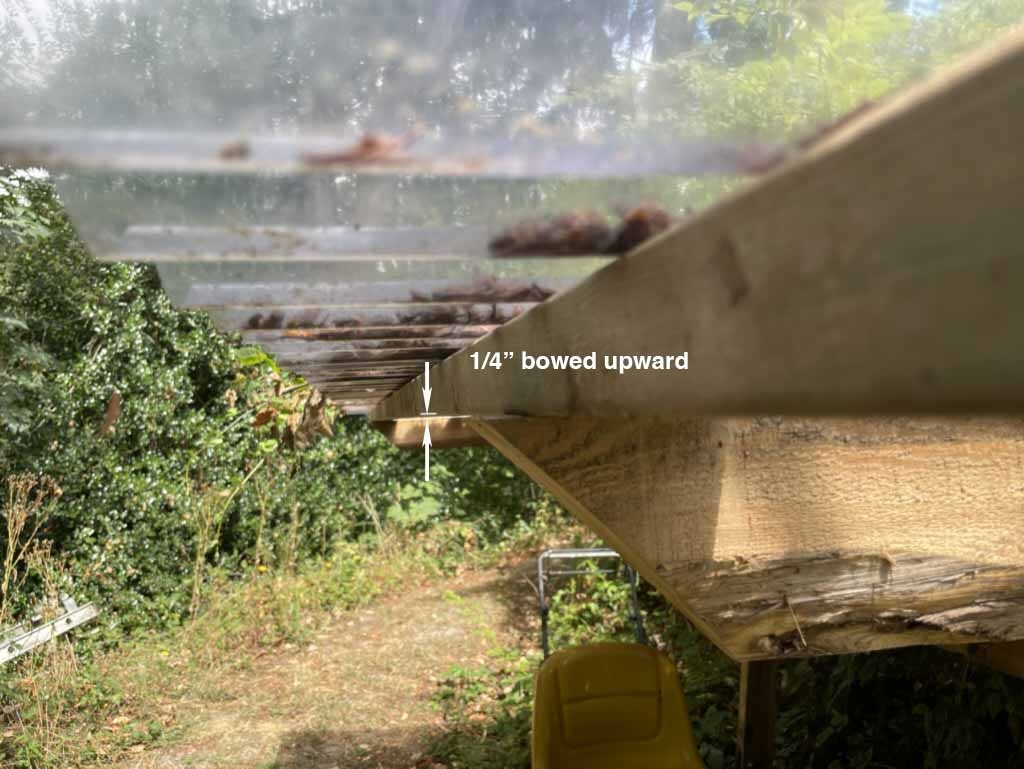

Looks like a fun project. My only concern would be, like Eddie mentioned, was laying 2x4 like that, it will sag. Even on edge, with that span, it will probably sag. I'd at the least put another 2x4 on edge under it to make it a cross-sectional T shape or an inverted L shape, and glue and screw it. That simple spline running the length of the flat 2x4 will increase the strength by a ridiculous amount while not costing too much or affecting the aesthetics.
The purlins had a slight bow, so I installed them bow-up.
2 years later I think it's about the same as it was.
But in any case... it's not sagging yet.
