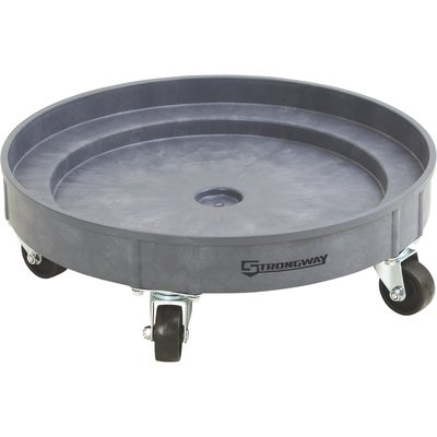

I used a 30 gallon oil barrel setting on wood since 2007, absolutely no issues. This year I upgraded to a 55 gallon and set it in this. Wouldn't "contain" 55 gallons but like I said, the 30 gallon had no obvious corrosion in 14 years. I love this cart as it moves very easy on concrete and will keep the barrel bottom clean and off the floor. Bought it from Northern Tool.
