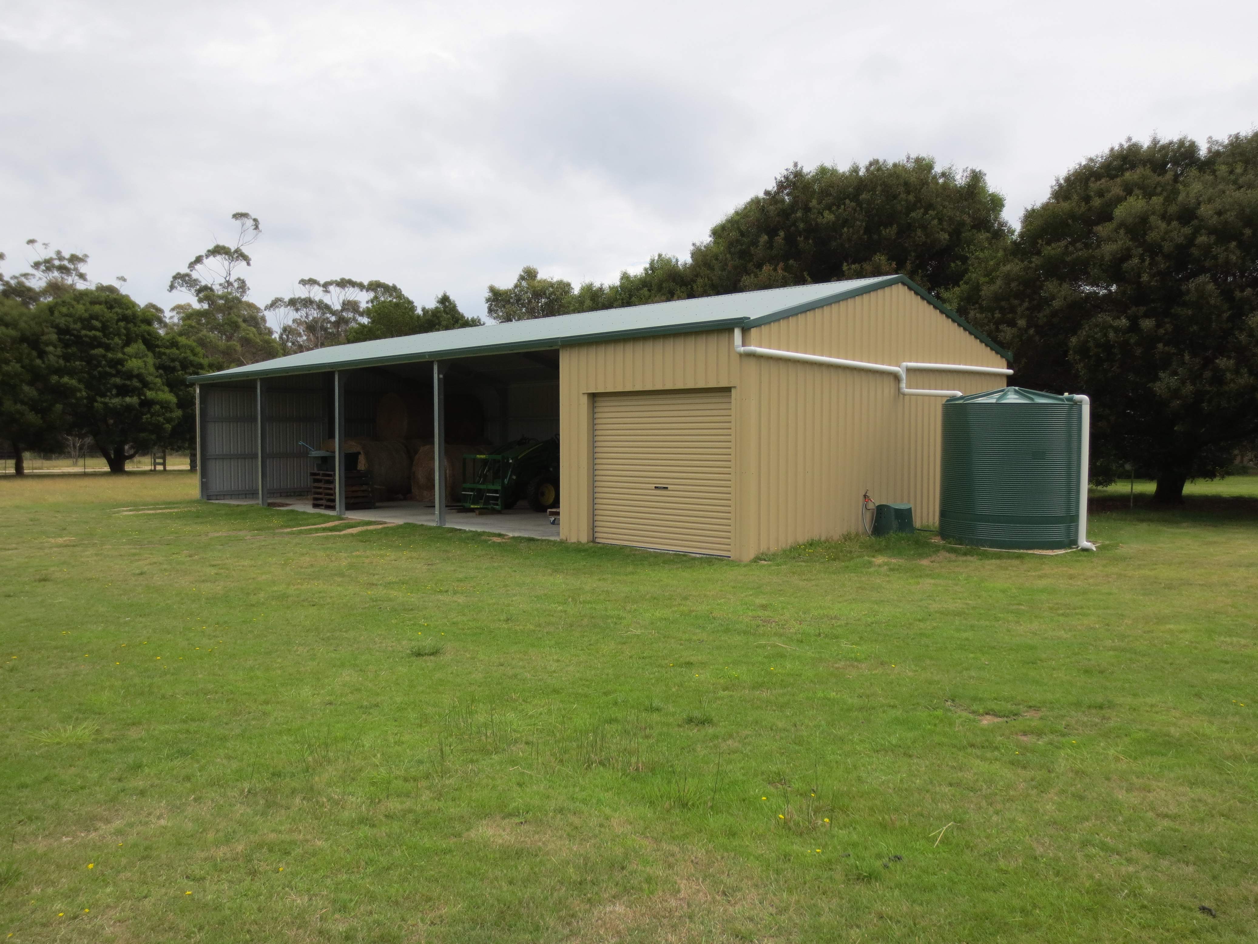

G'day Mate and welcome to TBN from Downunder.
What type of annual weather will you expect at the building location? Do you need a fully enclosed (with rolled doors) shed or would a 3-sided open bay structure suit, with perhaps 1-2 bays enclosed to make up a workshop?
For example, this is what I have:
/ shed size #7
I'd go with a 2 bay garage, 1 bay for the tractor, the other for lawn mower, snow blower etc with lean to's on both sides for covered storage for the implements for the tractor.
