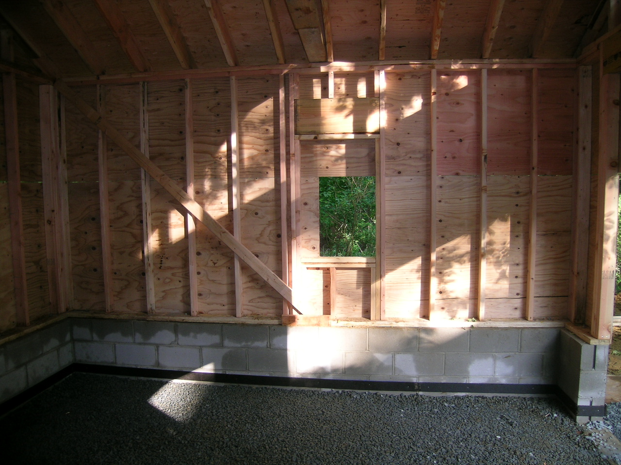

I'm looking at pouring a slab for 12x20 shed .would i 4" pour work or waste of time .its going to be for lawn mowers ,hunting eq.im not sure if i would be putting my kubota bx24 in but i might

I worked for a ready mix co for 24 years and seen it all but a 4" thick floor is all you would need. You would be wasting money to pour it thicker. The key is in the sub-base. Make sure it is good and compacted, use rock instead of sand and get it up high enough where the water will flow away from and not under it. Also a little support in the concrete doesn't hurt a thing, like reinforcement wire or rebar and don't pour it real wet, the more water you add the weaker the concrete but you don't have to pour so dry you can't work with it. So a medium slump is what you want, tell the concrete plant you want a 4 to 41/2 inch slump when you order. You do all that and you can park what ever you want on it.

Id have to see the lay of land to tell you for sure but if it were me i would level the sub base and put at least 8" of good quality crushed gravel 12" would be even better than compact.This does two things the added elevation helps shed water away from the slab and it will be a solid dry base for your slab to sit on this will give you minimal movement with the weather changes.@ a foot thick your at 8.88yd's for your footprint.
get 12 yrd's and you'll have plenty to slope away from your slab all around it and that to me would be cheap insurance to avoid future problems with your investment.
