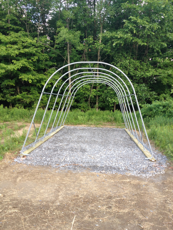

Here is my progress so far.
Looks good! As memory serves me, you'll have to take parts of it apart again when you put the front, back and the cover on. I recall being very frustrated with the person who wrote the directions at this point.

#16
Two steps forward. One step back.

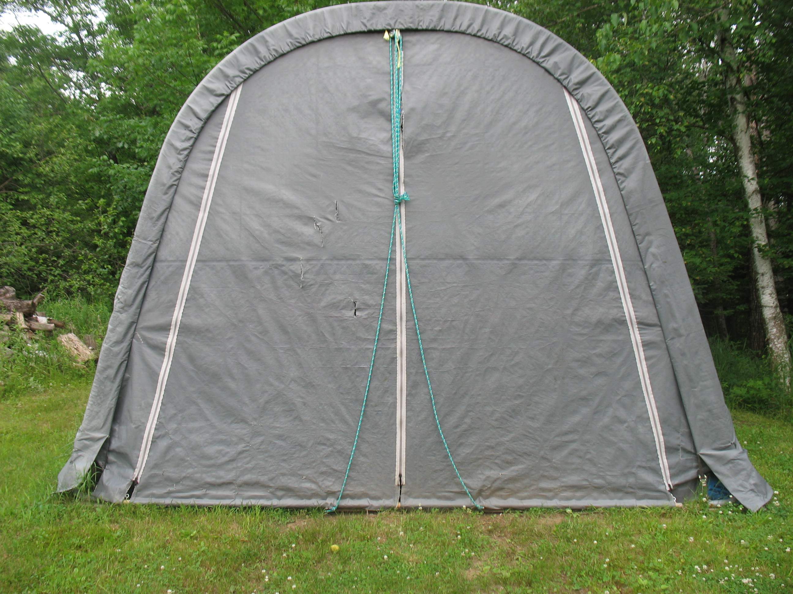

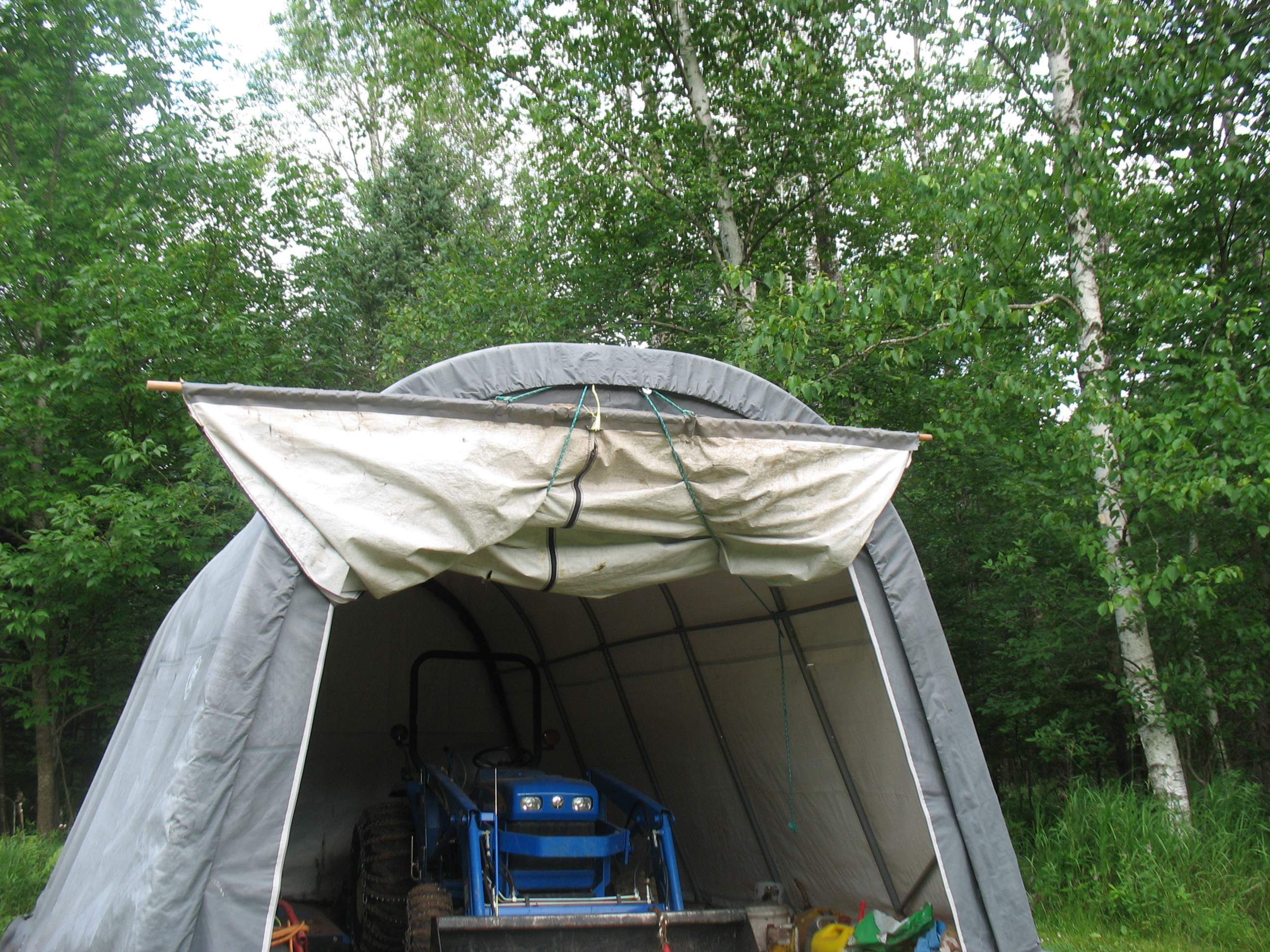

That door setup is great. I cant remember how it was done but in the steam room of a block making plant I worked at the ropes were setup in such a way as the door rolled up against itself as you pulled the string. Maybe check on youtube or google to see if there is an instruction movie available. I know it was just two pulleys and a pipe on the bottom just like your setup.
