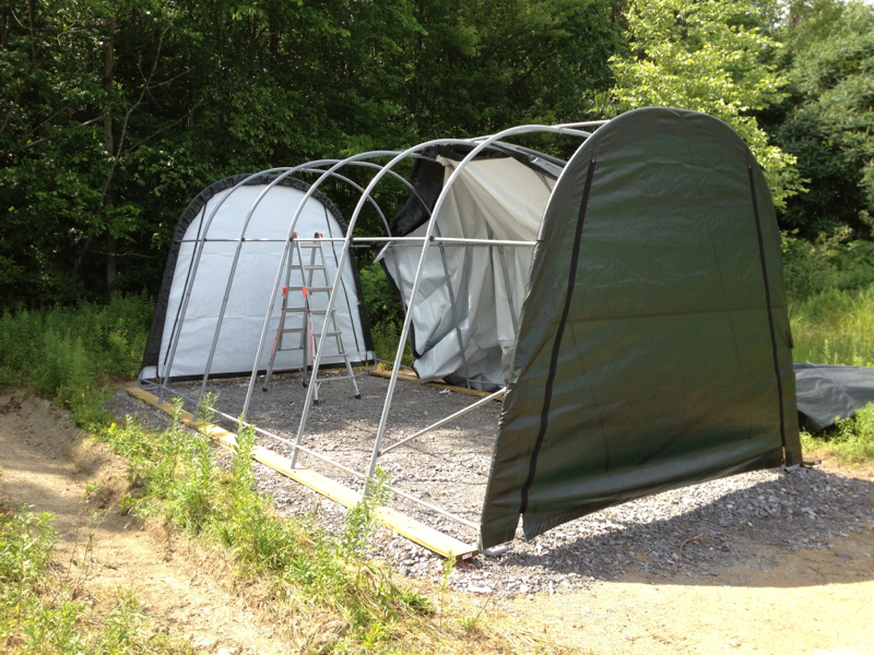

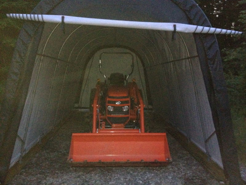

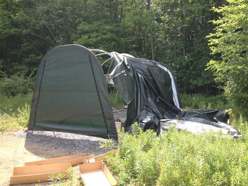

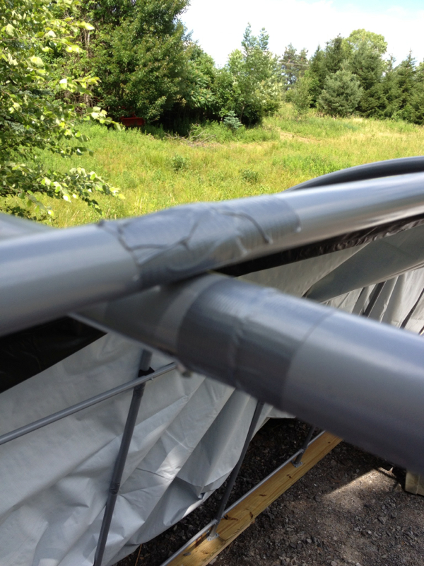

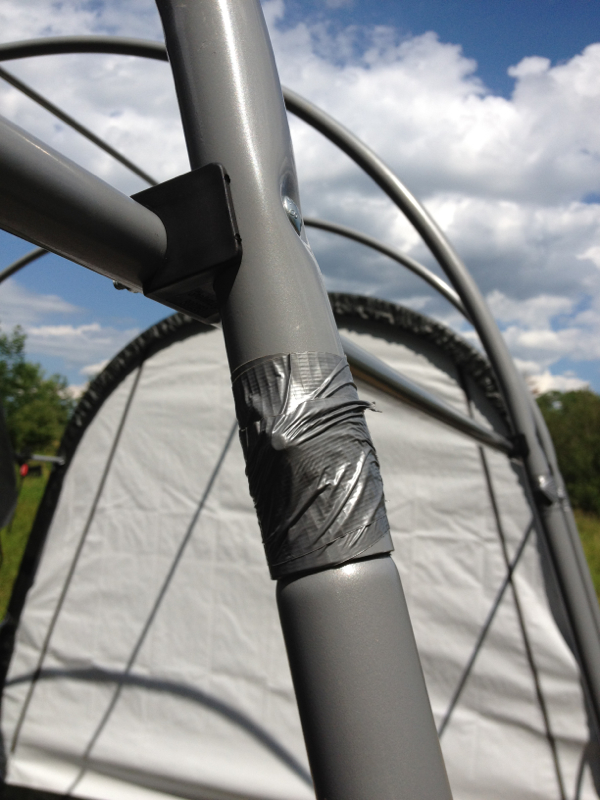

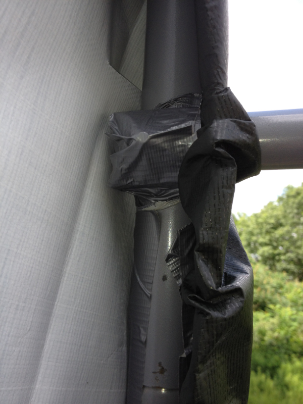

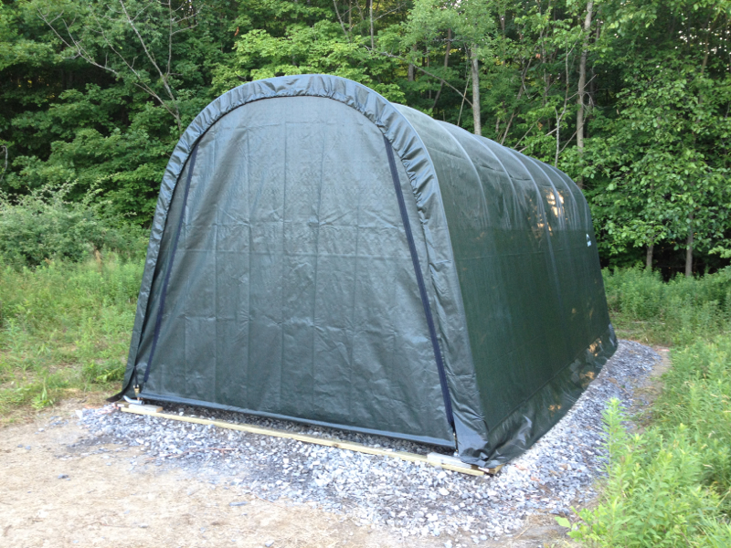

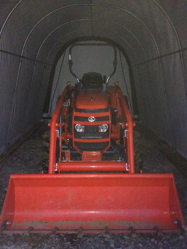

Finally got my shelter finished today. It feels great to have my tractor back under cover. I took some extra steps along the way that will hopefully help extend it's life. I wrapped all the screws with duct tape to help prevent chaffing on the cover. I also added some cross members tying my sill plates together which will prevent the sides from spreading. All in all I'm happy with the installation but still need to add the ropes for the doors.
I was wondering how tight is too tight on the top and sides? I want to keep it taught but not tear it apart.

From your pictures it appears as though the doors have changed: no center zipper on the front; rear appears to open as well (a nice feature).
The only rips or wear marks on my garage are caused by my leaning things against the fabric from the inside, and from the guide bar on the loader snagging the door when I was too lazy to tie it back.
Keeping the front legs connected so they don't spread a part and stress the zippers is key to longer door life.

What size shelter are you putting up. Since the instructions don't mention putting the ends on before fully assembling the frame, any reason you couldn't do that?
A center zipper would be nice. It's kind of a pain to walk around the door with a pipe installed along the bottom. I'm sure I'll get use to it though. I'm glad to hear your cover has been so resilient to weather. I'll need to be careful about leaning stuff against the interior.
It seems that there are endless variants of these shelters depending on where you buy. I got mine from Northern Tool because it happened to go on sale AND I had a 20% off code at the time. It was a pretty smoking deal. I have seen very similar shelters to the one I bought that didn't have the back door, and they were more expensive! I guess it pays to shop around.
It's a 12W x 24L x 10H shelter. Putting the ends on before fully assembling the frame is an interesting idea. If I do another one of these I might try to add the end cover concurrently with the assembly of the frame to avoid having to take things apart so many times.
