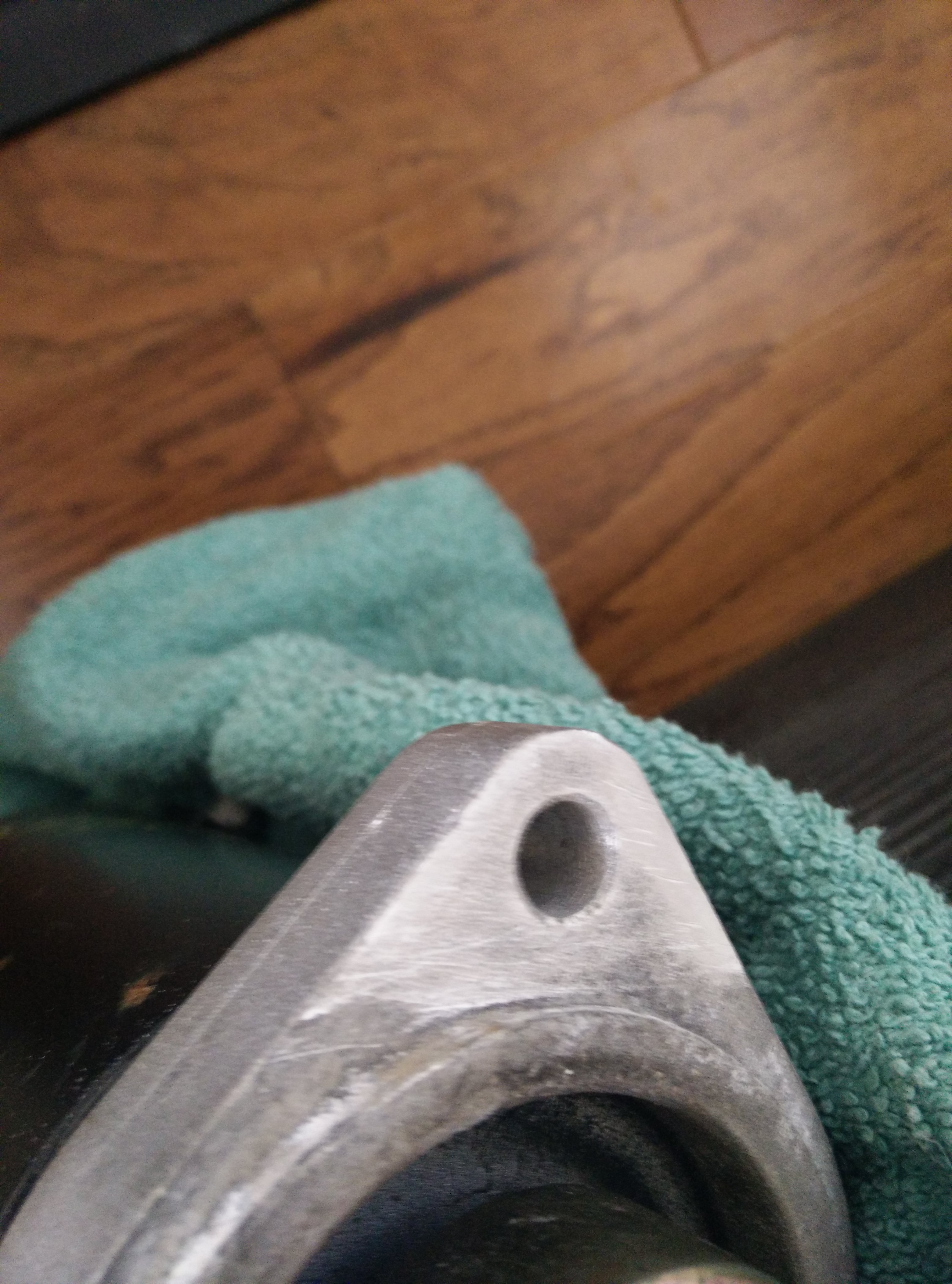

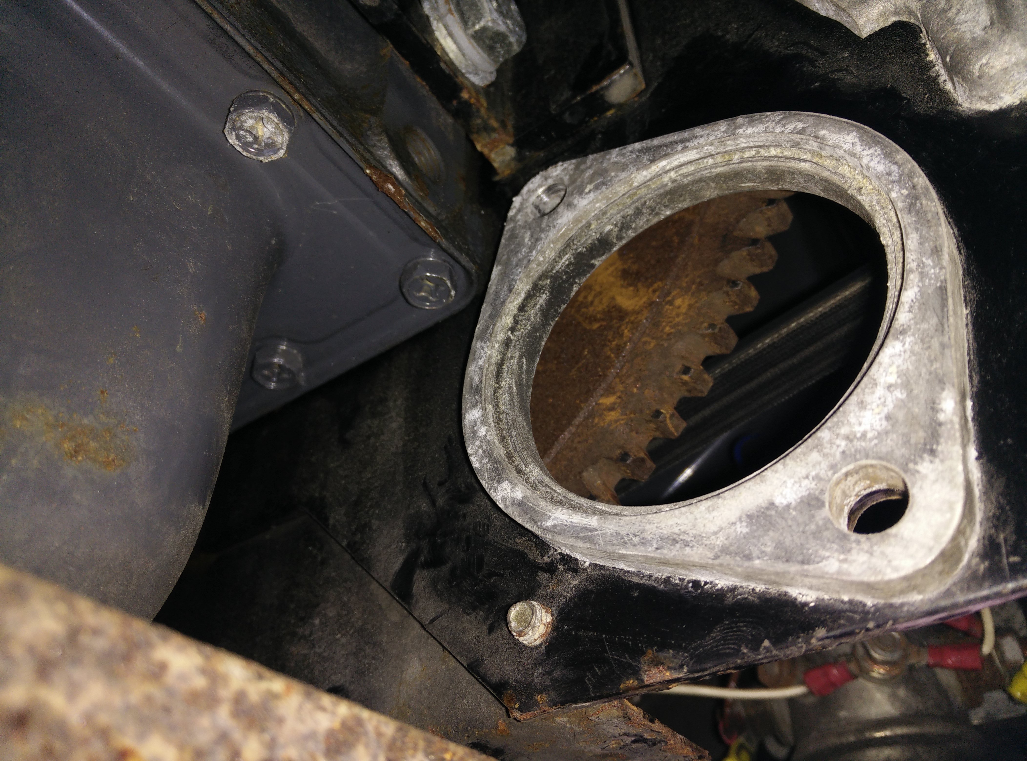

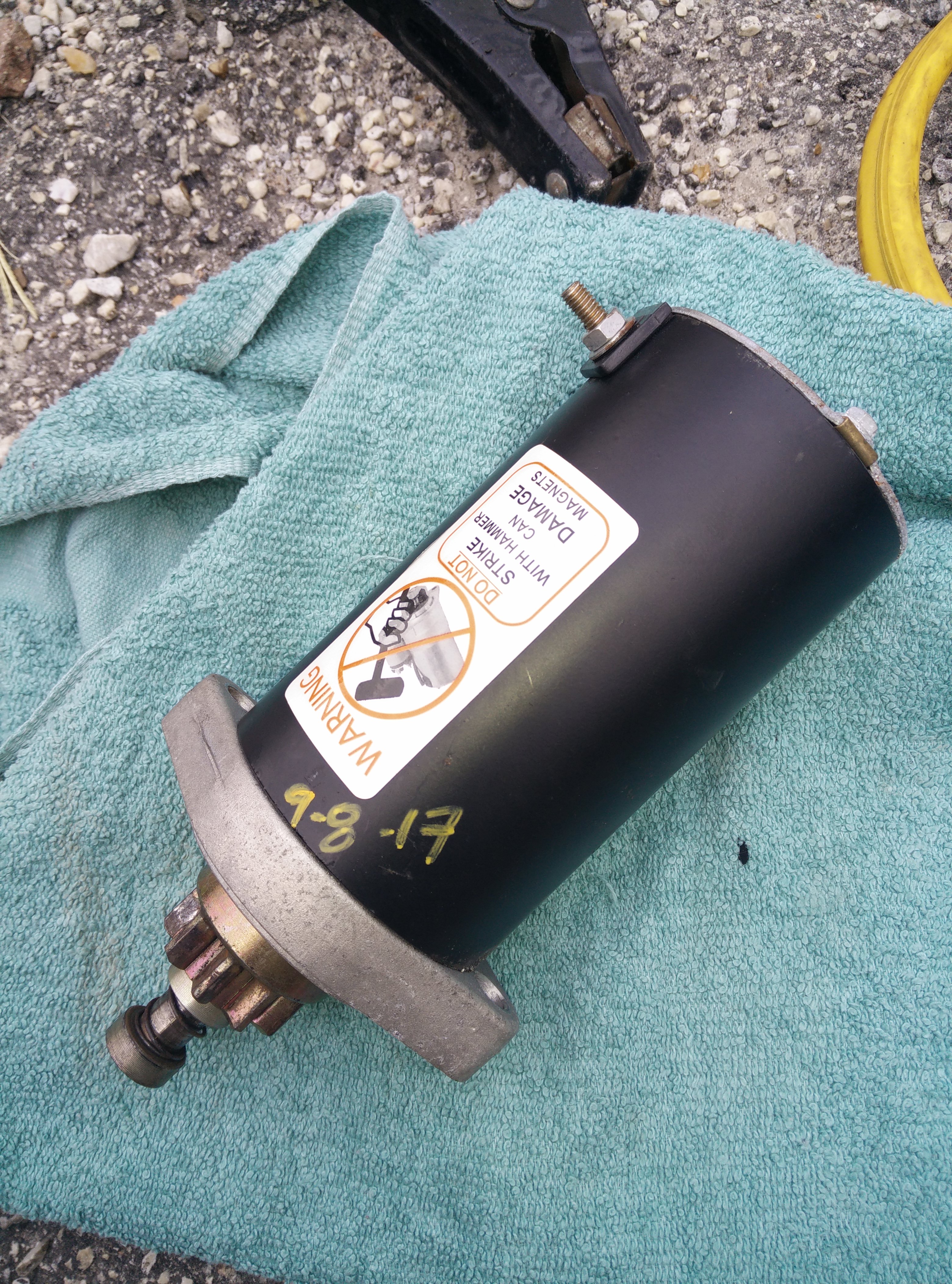

Update. Just got back from the MH and testing. I ran the starter directly from the car's battery (14v) to (+) terminal on the starter and clamped onto the starter mounting bracket. No joy. Same results. It took me an hour to get one bolt of the 2 off the starter to remove it. It is behind the starter out of view and a retaining nut that is harder to get to with a wrench. I suspected the starter since I bypassed everything else. I tried the starter while it was laying on the ground with jumpers and it ran as I think it should, no resistance and spun as long as I applied power.
So then I began thinking it must be grounding issues between the starter housing and the frame ground. On looking closely at the starter mount flange and the corresponding receptor on the frame bracket, they both appear not to be steel but look more like aluminum as they are a gray color and there is corrosion on both of these that is not rust. More like a chalky weathered look. I filed some of the flange and it is now a smooth and shiny silver color. I thought I would get the starter tested but now I am leaning toward negative connection issues with the starter and the frame. The starter has some carbon residue around the shaft which probably is from it trying so hard to turn over. About a year ago, I suspected this type of issue so I put a separate ground wire (battery cable) from the chassis frame to the starter. However, I made the connection on the outside of the starter bracket where the bolt goes through to a nut. If I had put it on the other side nearer to the starter, it might have worked. But the corrosion/oxidation would have still been there.
Since 1 of the 2 mounting bolts is almost an hour long process, I do not want to do this very often if ever. Obviously I will clean with a file and wire brush the areas where they contact on the grounding side. I can add a few pictures in next post.

These are views of the starter and the frame mount, both of which have corrosion. The frame mount is attached to a steel bracket and is also a gray color.
