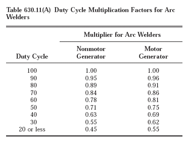

This is fine advice, but copper isn't cheap. Here is the relevant table from the NEC:
The PA300 has a 60% duty cycle at maximum amperage. At max amperage, it pulls a sustained 46.8 amps. At a 60% duty cycle, a non-motor generator has a duty cycle multiplier of 0.78. 0.78 * 46.8 amps = 36.5 amps. Looking at wire gauge tables, the derate basically seems to drop you down one wire gauge size, so actually I would probably agree with Boomer that you may as well keep life simple and just wire up the circuit with a 50 amp breaker and the appropriate size of wiring. Unless maybe you have a really long cable run and the difference in cost on the wire to go down one size will matter.
EDIT: I am not an electrician. This is not professional advice.
Copper is cheaper then repairing fire damage, you never know what's going to get plugged into that circuit in the future. On really long cable runs you might want to think about going up 1 wire size or more, not down. Match the wire size to the cable run length and breaker size for 100% duty cycle. A little extra money is cheap insurance to keep the Fire Marshall away.
