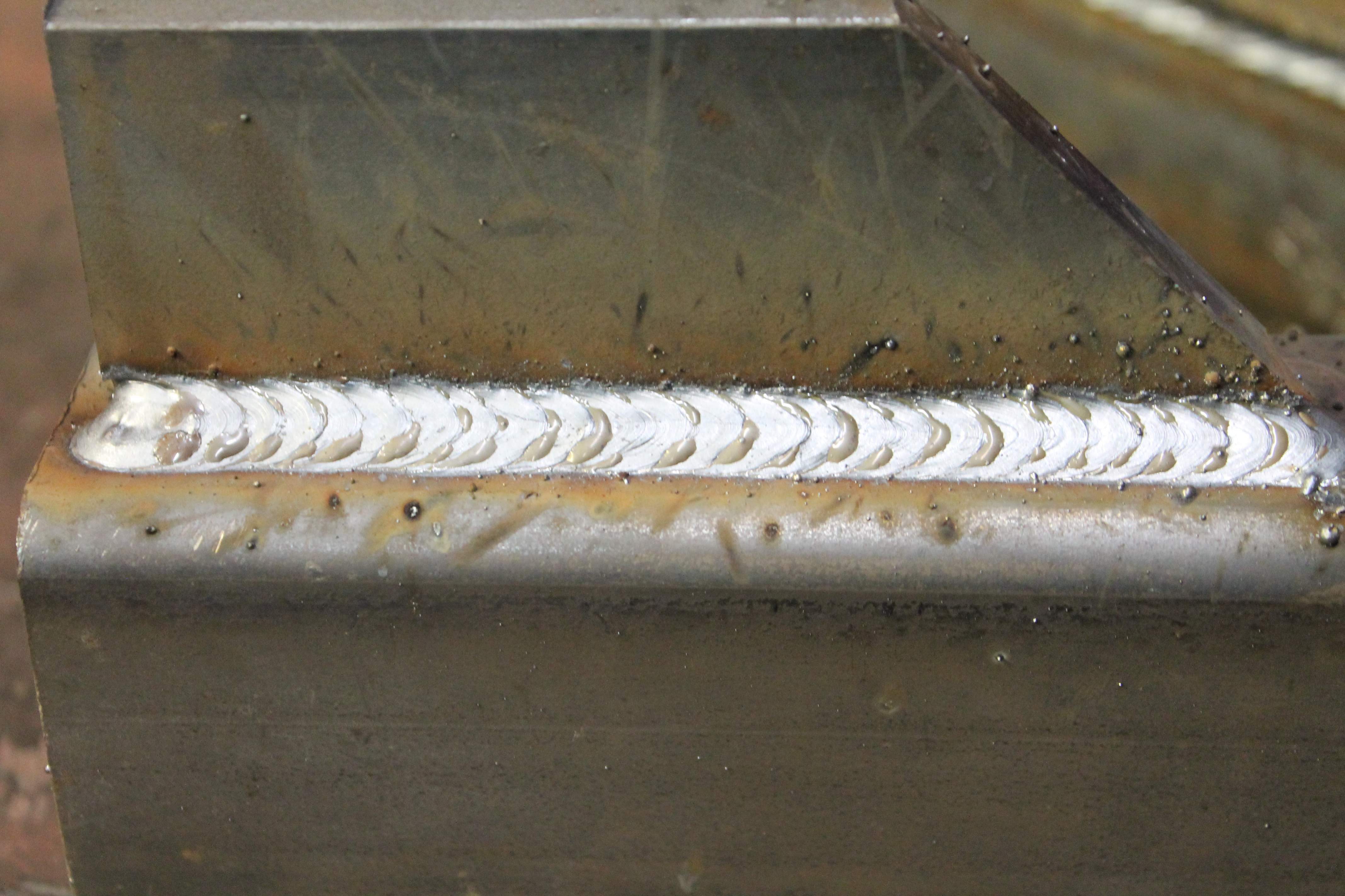

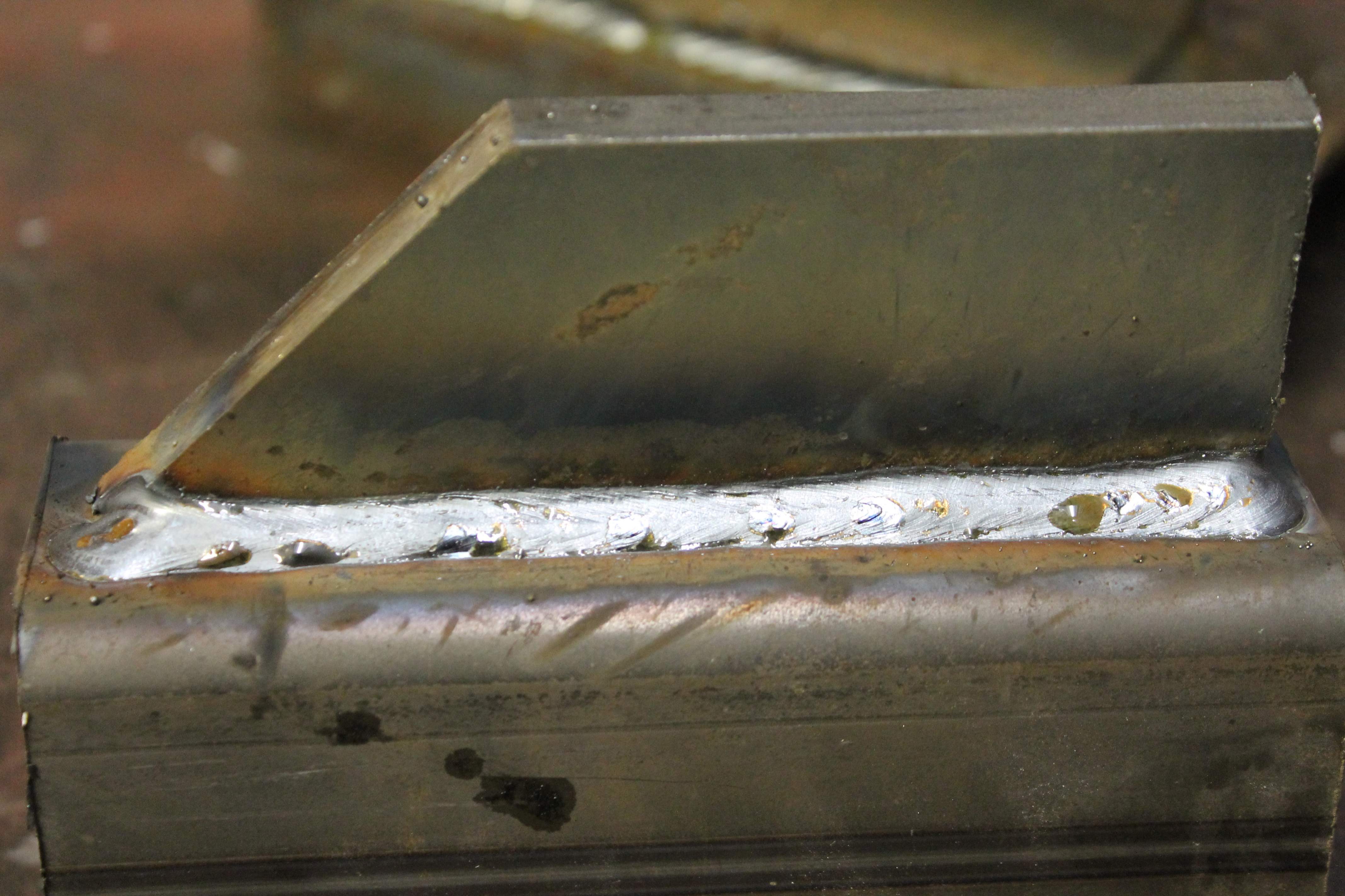

Ran my new miller today at the setting the book recomended for1/2". It was definitely a spray transfer, way hotter than what I usually like to run.

Got your pics shield arc. First is the book setting. The second is a setting that is closer to what I prefer. I didn't add any movement to the book setting. The arc looked identical to and performed like spray transfer.

   / Shielding gases #36
Oh I like the second one too! The first one looks like it has a slight bit of undercut on the top toe. Or do you think you travel speed was to fast on the first one?
There was some undercut at the end. I didn't stay in the puddle long enough. The rest of weld, wetted in pretty well. I'll try the setting with some movement tomorrow. Still like cooler settings. I was in a hurry, ran out to the shop in shorts and my wife's crocs to weld and get some pics!!!!
