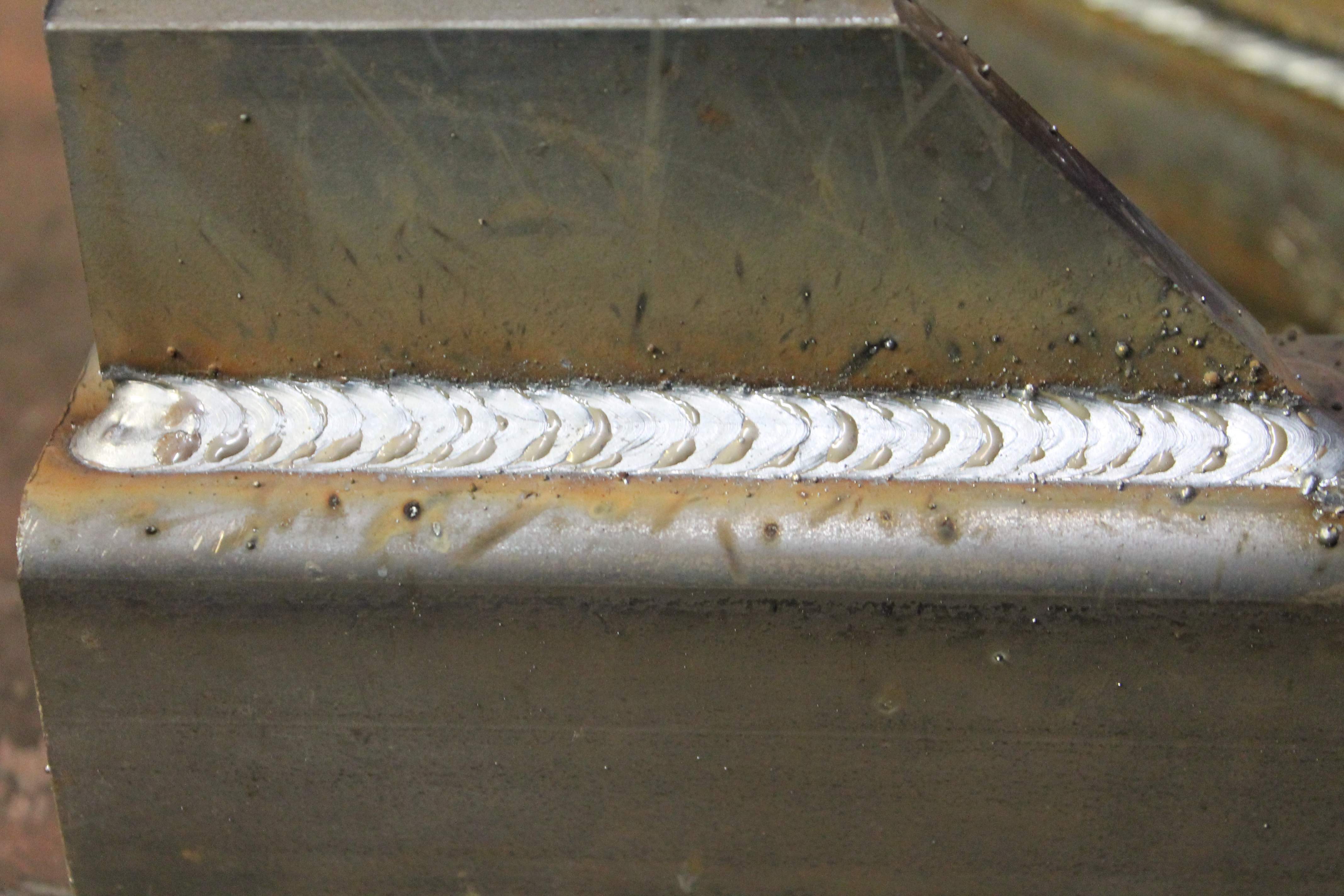

Pulse Trumps Spray any day. You do need about 90% argon to get to spray but remember the old 75/22/3 Argon Co2 with 2-3% O2..You could get close to true spray with a smaller machine ( ESAB 250 ) but you suffer from adding Oxides to your welds. Some still believe in it. Praxair called it Stargon. Old School gas.
What do you mean "close"?lol. I have one (ESAB MM250), and it sprays easily with plenty to spare. It's a true spray without a single bobble on .035. (first picture on left.) It's actually 270 amps. I use C-18. I also use it for short circuit transfer with the Everlast i mig 160. It has plenty of character, but none of the spatter or costly cleanup time. (last two pictures)
Nice looking beads! My miller 252 will get hot enough for spray transfer also.

In some areas of the country it's hard to find. It's a proprietary blend from Airgas. It's 82% Ar, 18% CO2. It gives you the ability to spray, but doesn't make the puddle so wet from too high of an argon content that the puddle is completely uncontrollable. I love it. I fabricate sawmills and some farm equipment on the side, and it reduces my cleanup time enough that the mild extra cost pays for its self quite easily. It yields beautiful, "shiny" welds...without the ugly scaly look of the oxidized CO2 welds.

I meant Close to Spray with Stargon Gas. Never said your 250 amp units didn't have enough " power ". I've owned several old L-Tec Airco and Esab 250 Mig Masters back in the day. I had the 1st factory prototype Esab 251 power supply with a 4HD feeder. Also a 300I Integrated soft key inverter as well as a stand alone 300i power supply with 4HD. I know the capabilities.

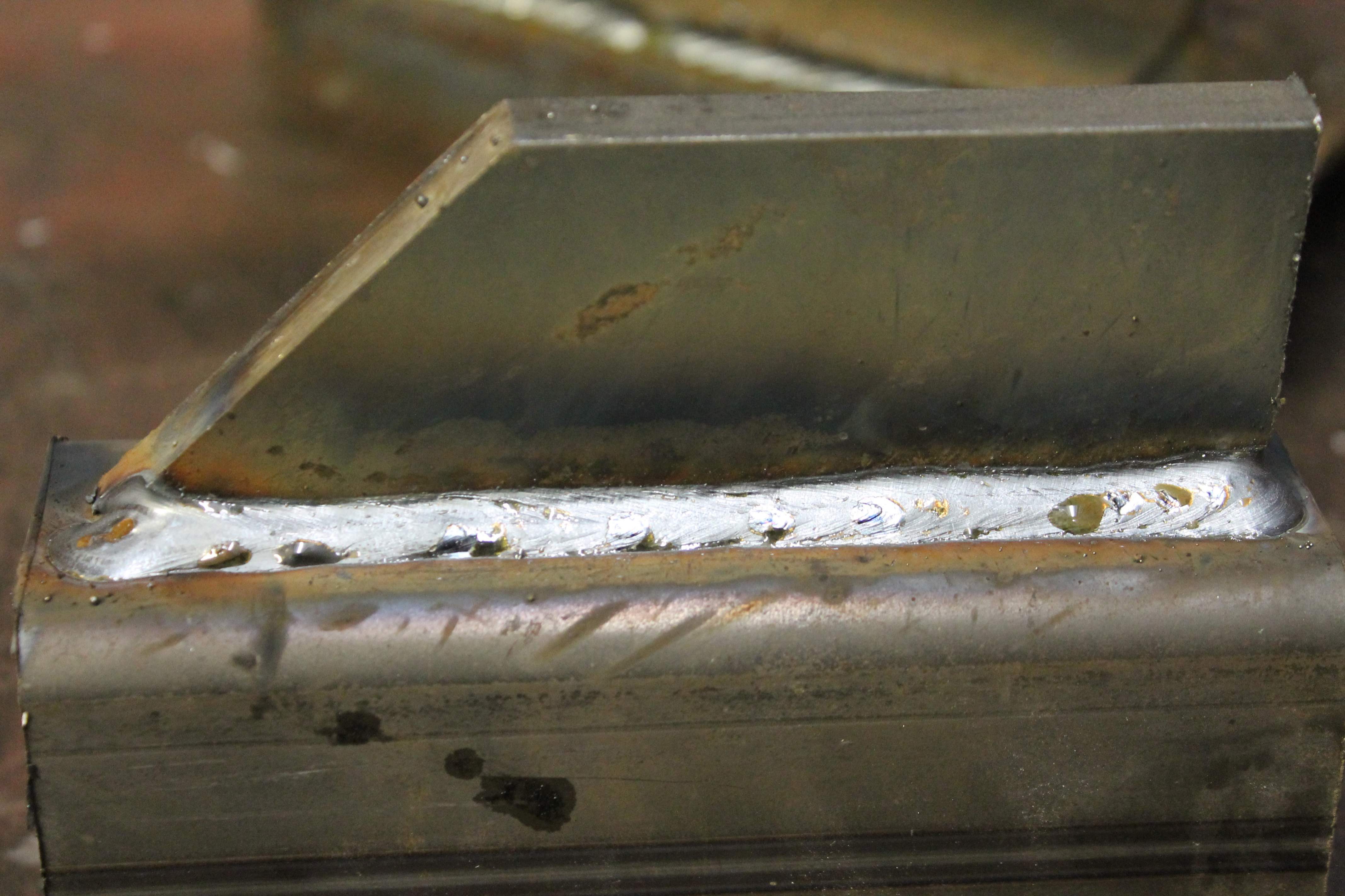

Got your pics shield arc. First is the book setting. The second is a setting that is closer to what I prefer. I didn't add any movement to the book setting. The arc looked identical to and performed like spray transfer.

Oh I like the second one too! The first one looks like it has a slight bit of undercut on the top toe. Or do you think you travel speed was to fast on the first one?

There was some undercut at the end. I didn't stay in the puddle long enough. The rest of weld, wetted in pretty well. I'll try the setting with some movement tomorrow. Still like cooler settings. I was in a hurry, ran out to the shop in shorts and my wife's crocs to weld and get some pics!!!!
