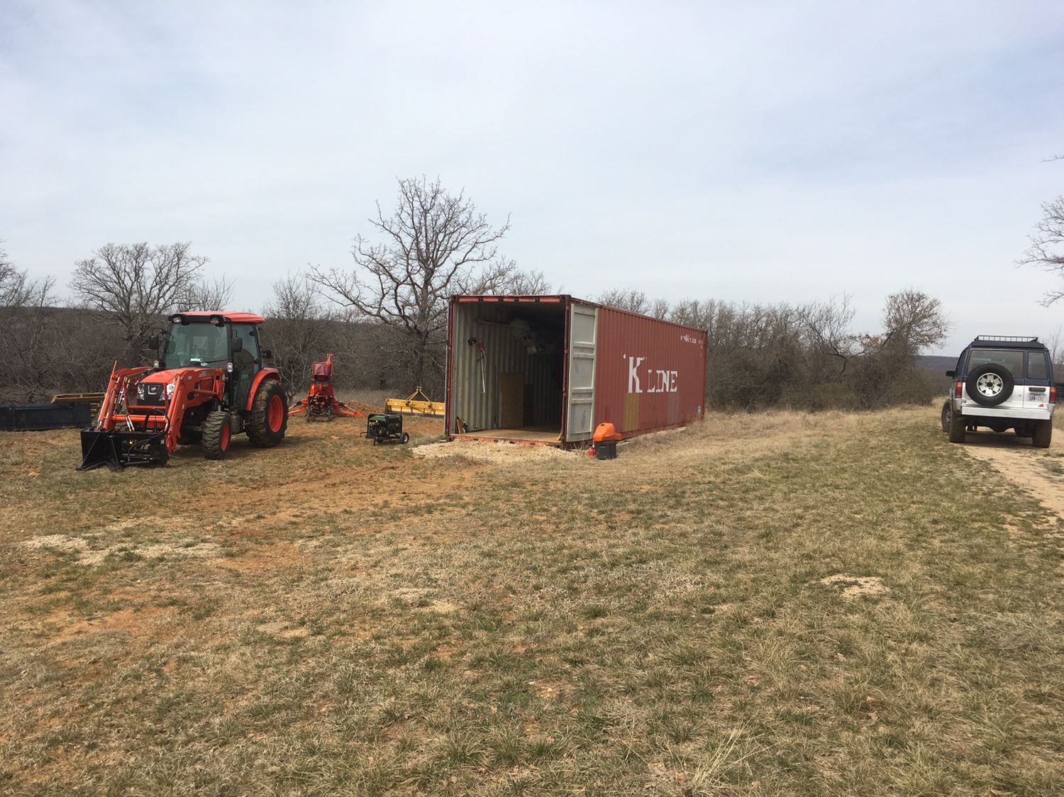

I'm looking at getting a shipping container for temporary storage of misc equipment and attachments. I was originally considering a 40 footer with doors on each end but those seem hard to find. Same with 20 footers. I also came across 1 time containers advertised as "new" but in reality they have been used once.
I'm leaning towards a 20 footer one time container with a single set of doors because of cost and in the hopes it will be in better shape and easier to relocate in the future.
For the guys who have storage containers, what do you like about what you selected and what would you do differently if you could do it again?

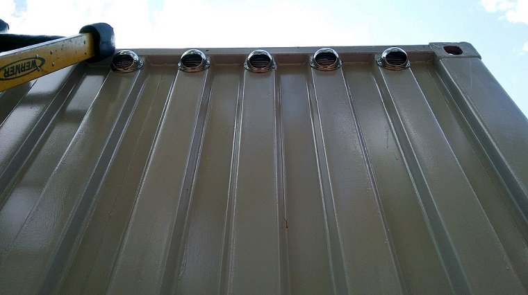

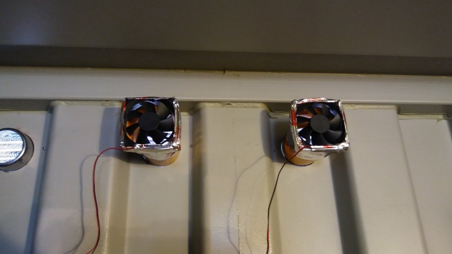

I have a 20' and no regrets on size as I intend to move it in the next year. I should have started painting it white right after I got it but it was February. By mid April it was turning into an oven inside during the day. I'm working on the paint right now as time permits. I also am halfway into installing two tiny solar fans to pull air through during the day.

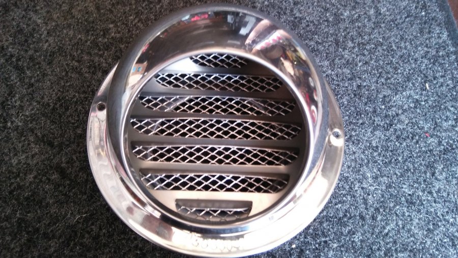

Also adding vents will help keep the container from becoming an oven. I added 12 volt high volume muffin fans to aid in air movement.
