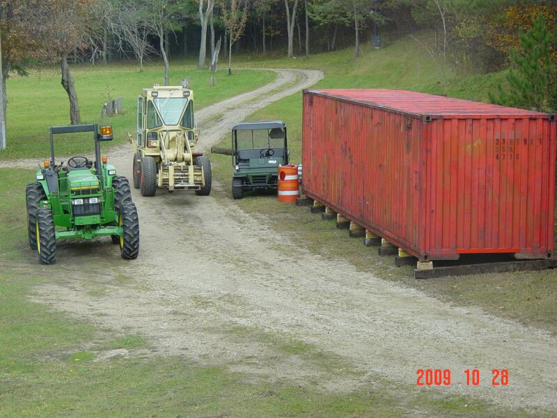

   / Shipping Containers-If you did it again, what would you do differently? #16
Place on wood such as RR ties and a compact 4x4 tractor can slide to make adjustments. Two 3 ton auto floor jacks on planks will easily and safely lift an end or side for final leveling and support placement.
